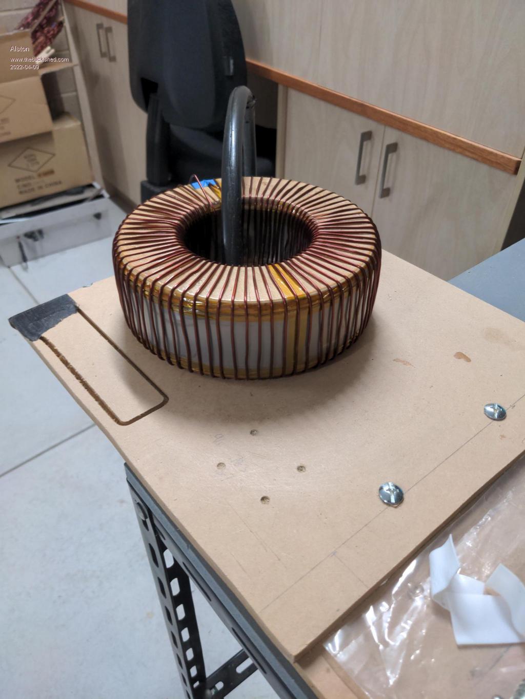

Posted: 11:37am 09 Apr 2022
4 primary layers wound and just marked the secondaries out and ready to start winding.

Posted: 11:55am 14 Apr 2022
Roger this is my second biggest transformer, it has 69 primary turns and I used 1.8mm (4 layers) wire recycled from an Aerosharp. The core is from an SMA Sunny Boy that you can see me hacking out of it's potting in another thread.

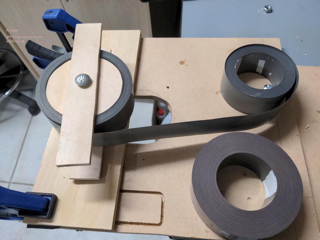

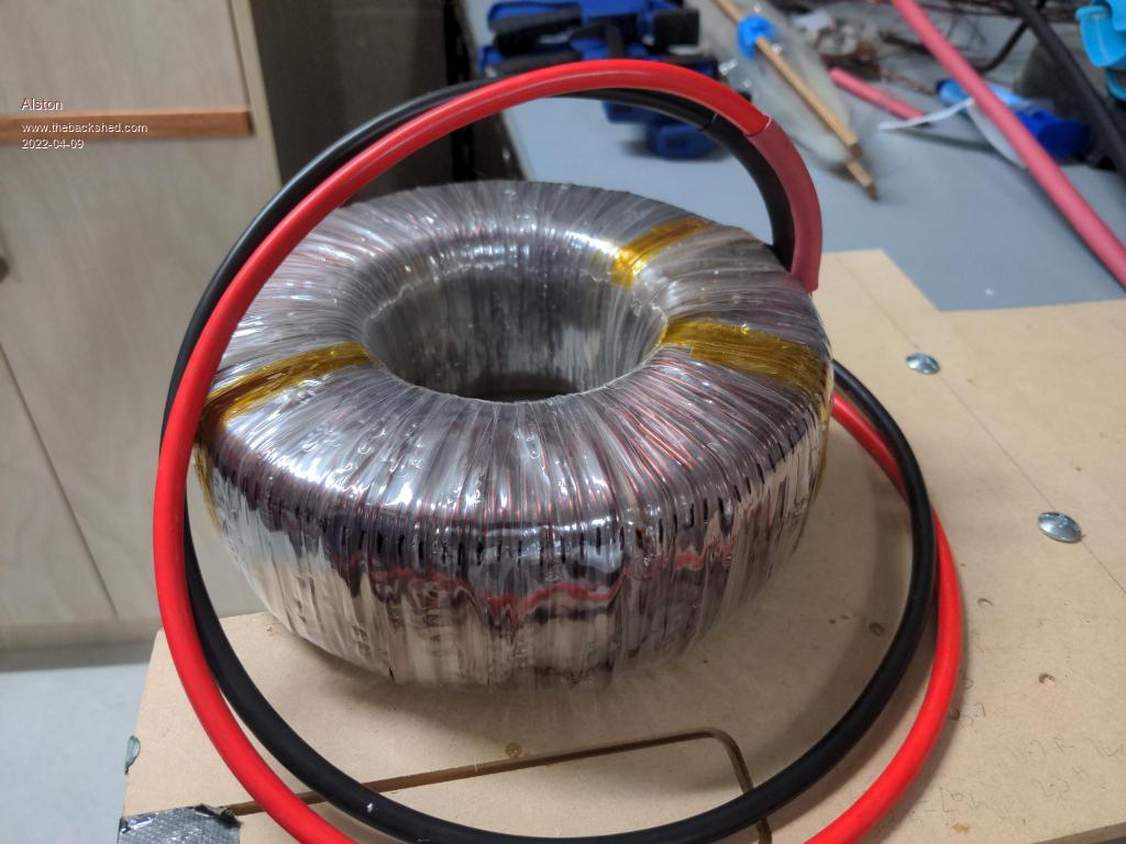

Posted: 09:53am 08 May 2022
Transformer 3 is all complete and I have started on TX 2. I could not find a suitable core so I am winding one from some smaller ones I had. Here is a photo of my very crude setup that seems to be working well. I didn't go to the effort of spot welding them and instead used epoxy. By the time the endcaps are epoxied on I figured it will be pretty well all glues together.

Murphy's friend
Joined: 04/10/2019
Posts: 678
Posted: 03:45pm 08 May 2022
  rogerdw said   I still ended up pouring a whole tube of superglue over the edge to soak in  ...  to try and make sure it doesn't rattle somewhere down the track.
I've often done that in the past when trying to quieten rattly laminations in a transformer, seems to work pretty well. And if it's the windings that are rattling, I spray in a heap of coil paint.
I would advise the same Paul as you seem to use no tensioning method as you wind. Place some temporary fencing wire around the outside to hold the end in place, warm the core a bit (40-50 deg) so the epoxy soaks down into any lamination gap before you epoxy your endplates on.
They wind those laminations on with a fair bit of tension in the factory.

Posted: 01:41pm 09 May 2022
I tried a few techniques to tension it but without a lathe or similar I would never be able to get it as tight as they were originally wound. I actually found that I could get it tight enough by hand until it would not longer slip and only the last bit wound would loosen. Thanks for the tip Klaus, I used a hot air gun and heated it up and then poured the epoxy on which seemed to soak in. This process looks to have worked really well!

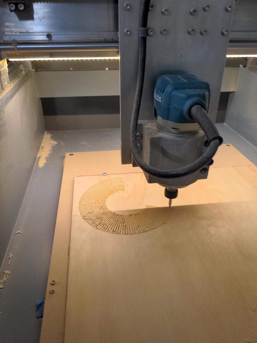

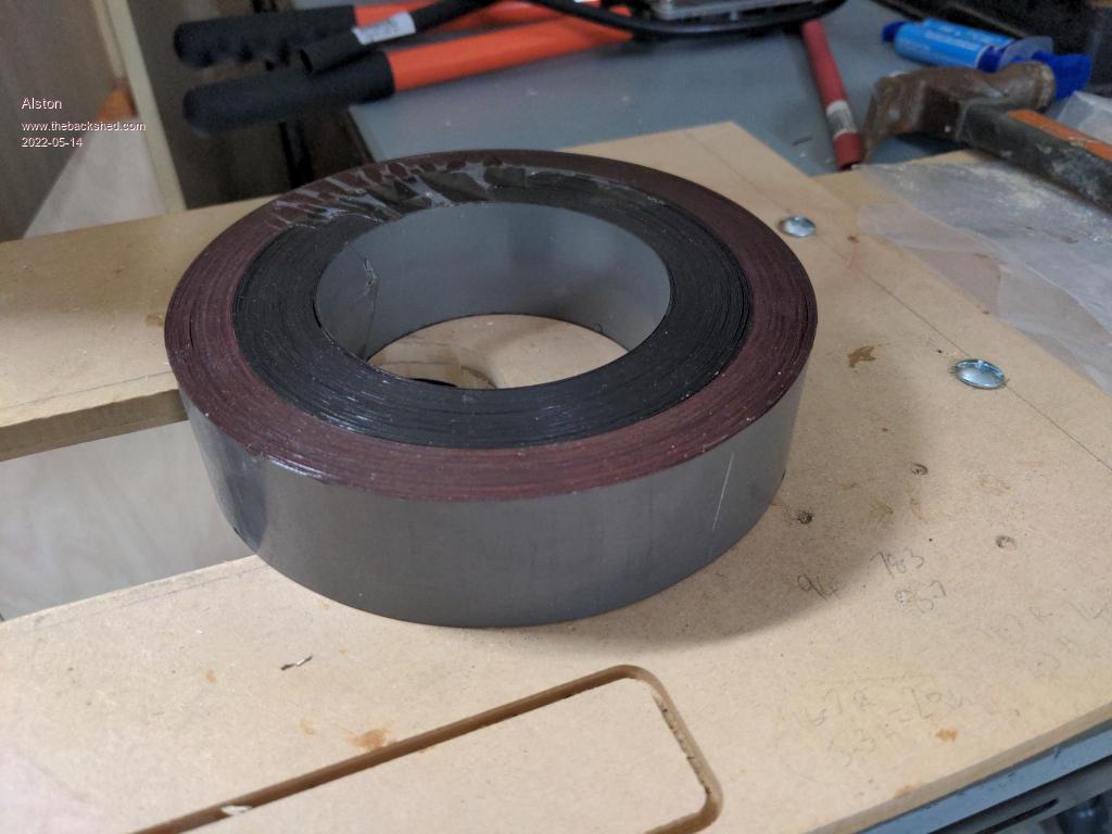

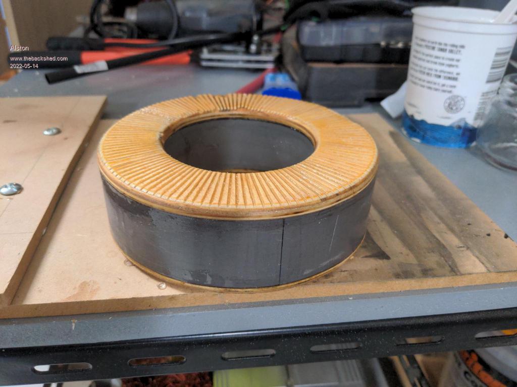

Posted: 05:14am 14 May 2022
I have completed winding the core and making the end caps on the CNC. I CNC them a bit oversized, epoxy them on and once dry use a trimmer router with a flush trim bit to get them to exact before running the round over bit on them. With the smaller divisions on this transformer I had a  bit of blow out near the edges but that doesn't really matter. For scale this core is OD:165mm ID:90mm and H:40mm (without endcaps)
