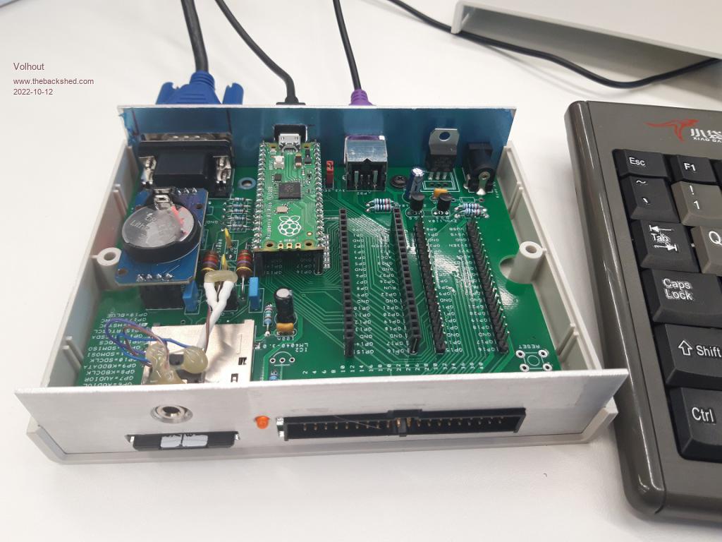

Posts: 6275
Posted: 07:03am 12 Oct 2022
JLCPCB was fast
Less than 2 weeks and the boards where in Netherlands..
And less that 2 hours later.......
Up and running...
Good thing that between 1.4 and 1.7 the location of the connectors was not changed, so I could mount the 1.7 board 1:1 in the case.
Thanks Peter !!

Posts: 9379
Posted: 08:29am 12 Oct 2022
It makes up into a very nice little unit, doesn't it?

Posted: 07:04am 21 Oct 2022
@Volhout:
Do you have a template for your pretty bezels? They look very professional!
I would have to make some for my housing as well...
Frank

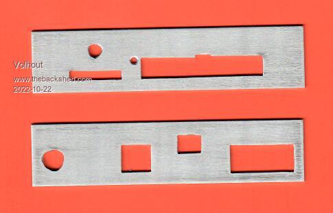

Posts: 6275
Posted: 07:28am 21 Oct 2022
Hi Frank,
The bezels came with the box (the G738A from Farnell). I just drilled some holes in it and filed (is that je right word ?..grinded ?) them to size.
I can "photocopy" them if you like, but I have no CAD files.

Posts: 6275
Posted: 08:58am 22 Oct 2022
For contrast I added orange paper...
The manual drilling and grinding causes damage to the visible surface, so I took some sanding paper to give the Aluminum a cleaner look.

Frank N. Furter
Joined: 28/05/2012
Posts: 1199
Posted: 05:27pm 22 Oct 2022
Thank you very much!
I'm currently toying with the idea of laser cutting the appropriate parts out of plastic in our FabLab.
