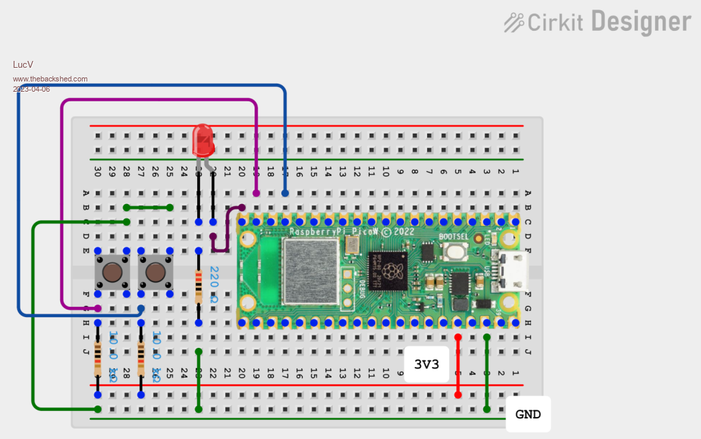

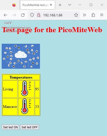

Posted: 09:23pm 05 Apr 2023
Easter is coming up and that is a holliday for most so I am giving you the link to the next chapter here. Maybe you'll have some time to play with the possibilities discussed in this chapter.
In previous chapters we send information from the Pico to a webpage.
This time we are going the other way round.
The chapter starts with building a simple setup on a breadboard: a led and 2 buttons.
Then there is a small program. When the first button is pressed the led is set on and when the second button is pressed the led is set off.
Next step is to build a webpage on which there are two buttons.
They will do the same as the fysical buttons: first button sets the led on and second button sets the led off.
Now we can fully operate the Pico remote from our lazy chair.
As this is a large chapter, I had the same problem as with chapter 8 I could not upload it. So I put it up at Mediafire just like I did with chapter 8. You can download it there free.
Chapter 11
Have a nice Easter

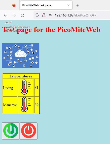

Posted: 07:19pm 20 Apr 2023
After a holliday and the release of my new book in Dutch I finally found some time to write another chapter.
The last chapter demonstrated how to put buttons on your webpage. And those buttons would set a led fysically attached to the Webmite on or off.
Only point was the buttons did not aesthetically look good. This chapter changes that.
The chapter shows two ways to put nice looking buttons on your webpage.
Here is how to do that:
Chapter-12.pdf

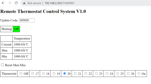

Posts: 3888
Posted: 01:59am 18 May 2023
I'll try to be as specific as possible, using Peter's thermostat example.
Here are my options:
> option list
WebMite MMBasic Version 5.07.07
OPTION COLOURCODE ON
OPTION DISPLAY 40, 110
OPTION WIFI MyAccessPoint, *********
OPTION TCP SERVER PORT 80, 6000
These are the files I have:

Before the main DO loop I added a line to print mm.info(ip address). I also changed the "WEB NTP" line to add the proper offset parameter for Nova Scotia Daylight Savings Time ("-3").
Here is the thermo.html file:

(NOTE: in the html file, remove the comments in the "href=data" field to make it all one line; I put the comments in because otherwise it messes up the forum post.)
I loaded the files into the webmite with xmodem.
In my browser (chrome), I entered the IP address and "THERMO":
192.168.2.203/THERMO
I entered "4321" in the "Update Code" box and click the radio button labelled "21". This was printed at the console:
THERMO
CODE    =       4321
RB      =       R6
6
sending thermostat page
The line, "CODE = 4321" is printed in the program at line 63 with "Print arg$(0,i),"=",arg$(1,i)". The args come via the magic provided by HTML and Peter's code; in the html file, "<input type='text' name='CODE' size='6' value='000000'>" sets the name of the variable, "CODE", and value becomes what you type--4321 in this case. In your browser on the URL line you will see "http://192.168.2.203/THERMO?CODE=4321&RB=R6". After the "?" come the argument=value pairs: "CODE=4321" and "RB=R6". Peter's code strips the "R" off of "R6" and gives a value for the radio button variable of 6.
Right at this point, in the "For i=0 To nparams%" loop, is where you would put your code to deal with the values returned from the browser to the program.
Hope this helps (and hope that it is broadly correct). (And hope the thread isn't too much hijacked--apologies.)
