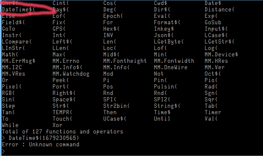

I may have missed some details somewhere,  but on FRESH install of PicoMiteWebV5.07.07a24.uf2, if the only thing I setup so far is the WIFI so I'm connected...
If I type:
> datetime$(1679228317)
Error : Unknown command
Above is what I get.
Did Adding TFTP and NTP support remove working with EPOCH time to set TIME$ and DATE$?
Posts: 11938
Posted: 12:29pm 19 Mar 2023
Sorry intra-cranial typo
WEB OPEN TCP CLIENT address, port [,timeout]
  Quote  If I type:
Which section of the manual is datetime$ in? Functions?
Edited 2023-03-19 22:31 by matherp
pwillard
Joined: 07/06/2022
Posts: 347
Posted: 12:36pm 19 Mar 2023
yes,  but oh geez... I was trying to shortcut and do stuff in immediate mode... not a program. Maybe that can be it?
Obviously... I'm very confused.

Posts: 4405
Posted: 01:07pm 19 Mar 2023
DateTime$() is a function not a command.
Do:
? DateTime$(...)
Posts: 11938
It is a function not a command
I think you are miss-remembering
rtc settime datetime$(now)
Note though that on the WEB version data$ and time$ are automatically set by WEB NTP
Edited 2023-03-19 23:08 by matherp
