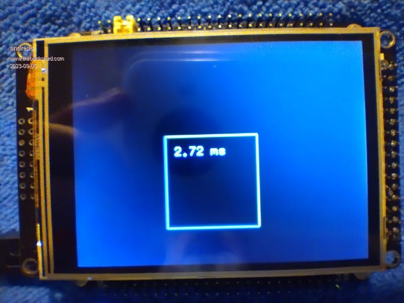

Posted: 08:34pm 04 Sep 2023
Hello,
I missed the TURTLE Graphics in ARMmite F4, so I wrote a tiny library:
> list "turtle-library.bas"
' turtle library
' (c) 2023 Andreas Mueller, Gerolsbach (AMI), version 1.3
Dim gx,gy,pen,farbe,heading As integer
Sub turtle_reset
 gx=0
 gy=0
 pen=0
 heading=0
 farbe=RGB(black) AND &hFFFFFFFFFFFEFEFE
End Sub
Sub turtle_pen_up
 pen=0
End Sub
Sub turtle_pen_down
 pen=1
End Sub
Sub turtle_move(x,y)
 If pen=1 Then
   Line gx,gy,x,y,,farbe
 EndIf
 gx = x
 gy = y
End Sub
Sub turtle_pen_colour(c)
 farbe = c AND &hFFFFFFFFFFFEFEFE
End Sub
Sub turtle_heading(h)
 heading = h
End Sub
Sub turtle_forward(f)
phi = Pi*(heading+270)/180
If pen=1 Then
  Line gx,gy,gx+f*Cos(phi),gy+f*Sin(phi),,farbe
EndIf
gx=gx+f*Cos(phi)
gy=gy+f*Sin(phi)
End Sub
Here is a test program:
> list
' test turtle
CLS
t = Timer
turtle_reset
turtle_pen_colour(RGB(yellow))
turtle_move(100,100)
turtle_pen_down
turtle_heading(90)
turtle_forward(100)
turtle_heading(180)
turtle_forward(100)
turtle_pen_colour(RGB(cyan))
turtle_heading(270)
turtle_forward(100)
turtle_heading(0)
turtle_forward(100)
Text 110,110,Str$(Timer-t)+" ms"
It needs 2.72 ms to draw a two-colored square.
-andreas

Posts: 6151
Posted: 06:23am 05 Sep 2023
  andreas said  Hello,
' turtle library
Sub turtle_reset
 gx=0
 gy=0
 pen=0
 heading=0
End Sub
Sub turtle_pen_up
 pen=0
End Sub
Sub turtle_pen_down
 pen=1
End Sub
 If pen=1 Then
 EndIf
 gx = x
 gy = y
End Sub
End Sub
 heading = h
End Sub
If pen=1 Then
EndIf
gx=gx+f*Cos(phi)
gy=gy+f*Sin(phi)
End Sub
> list
' test turtle
CLS
t = Timer
turtle_reset
turtle_pen_down
turtle_heading(90)
turtle_forward(100)
turtle_heading(180)
turtle_forward(100)
turtle_heading(270)
turtle_forward(100)
turtle_heading(0)
turtle_forward(100)
-andreas
That is not bad at all !! 2.7ms for 13 function calls that also include some graphics. Thanks Andreas !
