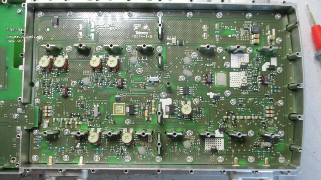

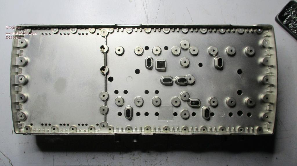

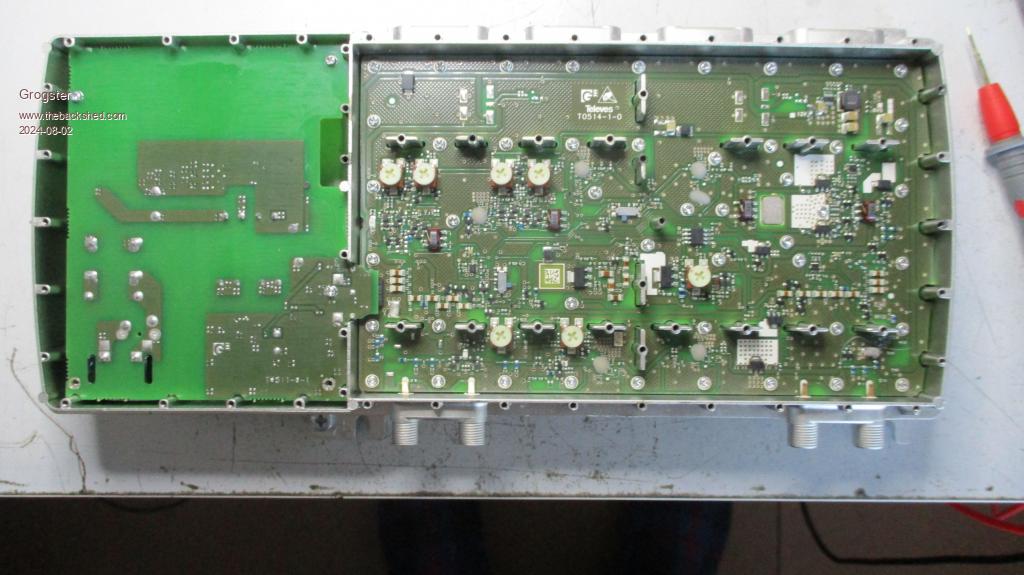

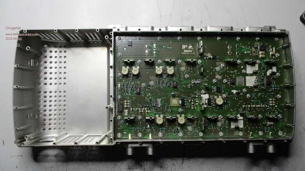

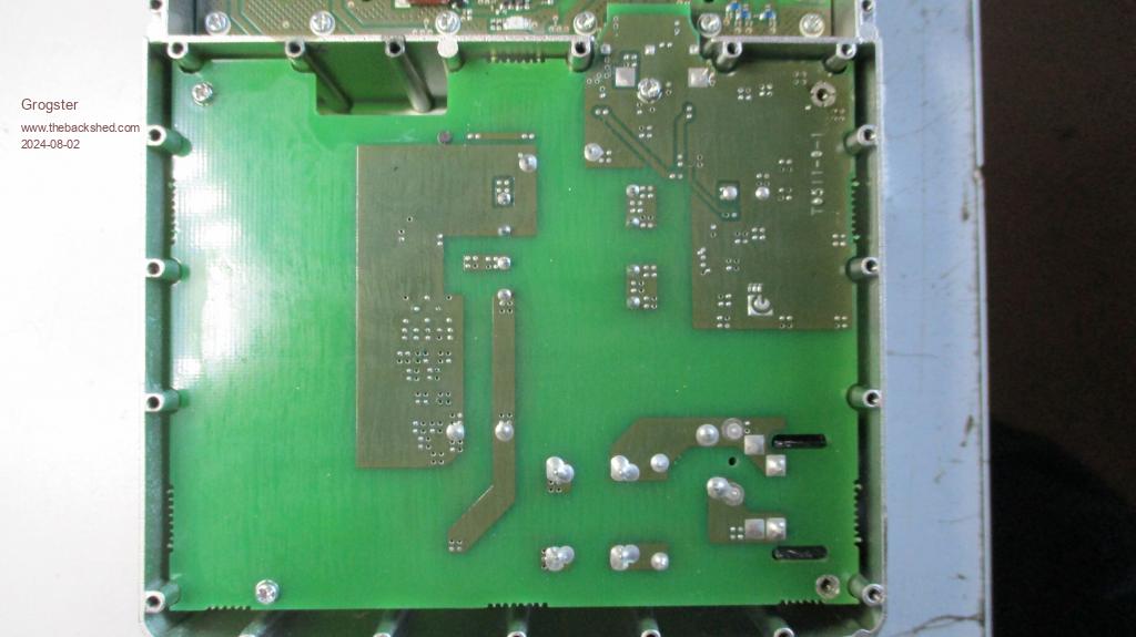

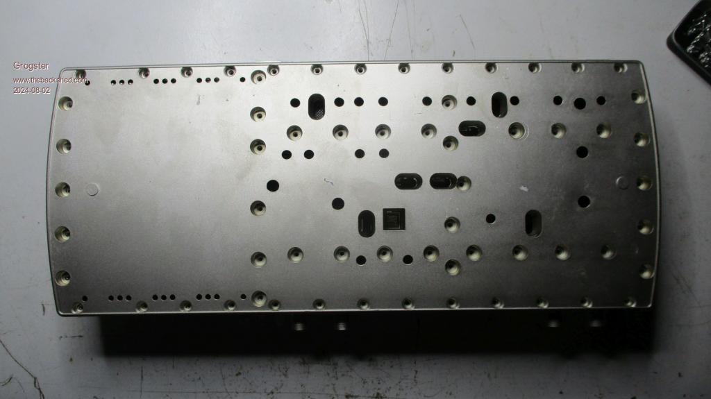

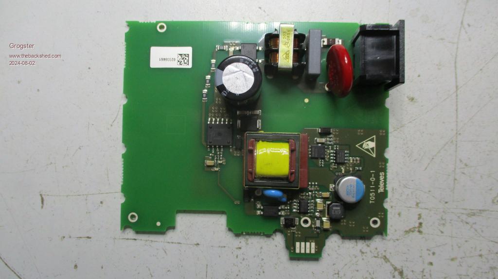

UPDATE:
I finally got around to looking into hacking these amps, so that I can power them from a LV DC supply, rather then trying to get 230v to work over the phone lines.
I took apart the spare Televes amp today - it is BEAUTIFULLY built, and built like a brick privy!!!
Take off the decal on the front, reveals the screws holding the diecast aluminum case together - 62 small machine screws!
...and that's JUST to get the lid off, so I could peek inside!
SMPS is simple single-rail 12v DC supply - yay!
Current consumption is 540mA @ 12v continuous, which I would expect for a TV amp.
That should be really easy to deal with either via a linear drop-down regulator arrangement, or perhaps a buck converter, as the original PSU inside the thing, is a SMPSU anyway.  If I simply remove the internal SMPSU, there is then plenty of room int there, to easily fit some form of 12v PSU, which I can then feed from either 24vAC or 36vAC via the redundant phone pairs.
I attach some photos.

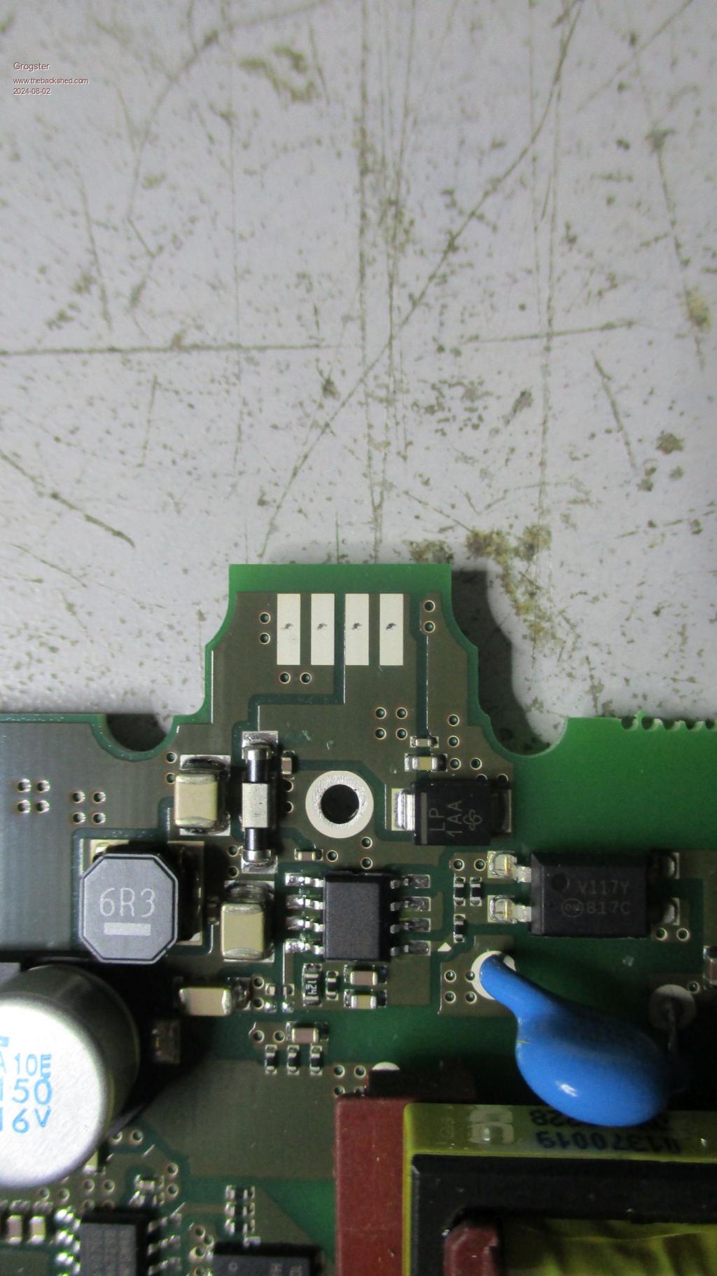

Posts: 6132
Posted: 06:38am 02 Aug 2024
Hi Grogster,
Looking at your photo's I notice few things on this power supply.
1/ There is 1 large electrolytic cap, which is after the secondary rectifier. But no inductor of any size, and second capacitor.
2/ There are 3 SO8 (2 nomal, 1 SO8-wide) chips in the secondary side of the power supply.
Since TV amplifiers must amplify AM modulated signals with high dynamic range, the 12V bus must be clean of any ripple and noise. So I expect that there is a 13.6V power supply, followed by a 12V linear regulator (in SO8 ?) or alike.
3/ There are 2 large test pads in the secondary side, potentially for measuring the 12V (or 13.6V), but also 3 smaller test pads exactly where the power supply passes the aluminum wall to thr RF circuit.
That would be a sign of 3 signals going to the analog circuit. One of them is most likely ground, the other 12V. But what is the 3'rd. Is it a "power good" signal, or a +30V, or +5V....?
In case you plan to replace the power supply with your own design. Make sure there is an isolation between input and the 12V output. You do not want the telephone ground cable to be hard connected to the coax cables in the TV system. That would present horor ground loops all over the area. So you need a transformer based dc-dc convertor.
P.S. Why replace the current PSU ? You work around the telephone line plan. The load is 12V 540mA = 6.5 watt, assume 7 watt. Since you have to work in the capabilities of the telephone line you can make a curve of volts/amps you think the telephone line can handle. There will be a peak (where the line can transfer most power) and that will be close to the maximum voltage you think you can apply to the line. That is not 12V 24V or 36V, but rather 48V or even 90V.
Can the built-in power supply work at that voltage ? When it can't, isn't it simplet to replace the bridge rectifier to a voltage doubler (need an extra E-cap), and drive the power supply with 60Vac or so... from the telephone line...
Just thoughts.
Edited 2024-08-02 16:52 by Volhout
Posts: 10048
Posted: 06:52am 02 Aug 2024
Hi chums.  I attach some more photos, and a close-up of the PSU output.
  Volhout said  In case you plan to replace the power supply with your own design. Make sure there is an isolation between input and the 12V output. You do not want the telephone ground cable to be hard connected to the coax cables in the TV system. That would present horor ground loops all over the area. So you need a transformer based dc-dc convertor.
Excellent point.
Thanks.
Posts: 6132
Posted: 06:54am 02 Aug 2024
Aha,
It has a post regulator (switching) to create 12V. And it is just 12V going to the RF circuit.

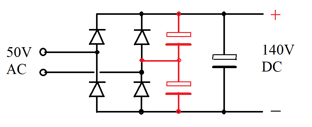

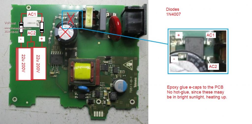

Posts: 6132
Posted: 07:16am 02 Aug 2024
This would suffice to run the PSU from 50Vac...
You could even leave the E-cap on the board, just add 2x E-cap and 2x diode, and replace the bridge rectifier.
Since the ripple in a voltage doubler results in half 2x half rectification, the ripple changes from 100Hz to 50Hz. Meaning that leaving the original e-cap on the board may be very useful.
After breadboard testing it, you can also make a PCB that holds the voltage doubler, and leave a more professional impression to the customers.
Edited 2024-08-02 17:20 by Volhout

Posts: 3389
Posted: 06:37am 03 Aug 2024
Volhout's voltage doubler can be achieved without the extra diodes.
Just connect the common point if the extra capacitors to one of the mains input pads.
The 240/120V switch on the back of computer power supplies does the same thing, linking the cap. common point to one mains input.
It acts as a regular bridge in the open position and as a voltage doubler in the closed position.
