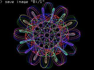

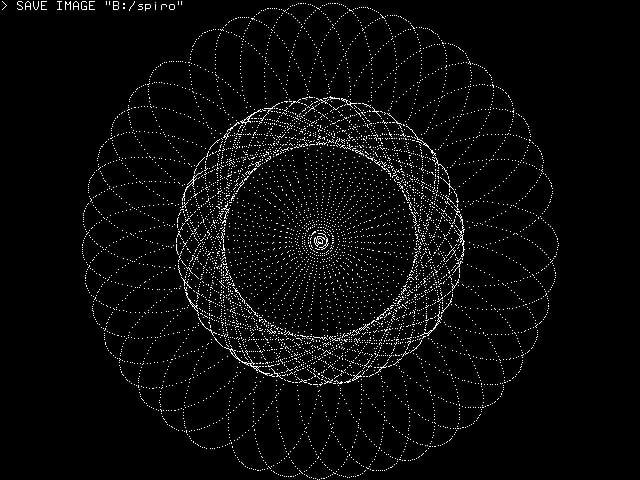

Posted: 04:52am 11 Oct 2024
Spirograph in monochrome & colour mode (1,2)
under .MOD music for your meditations :))
SPIROGRAPH.zip

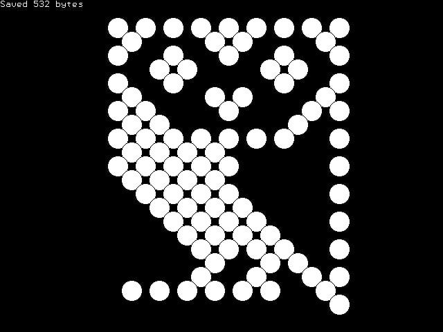

Posted: 12:48pm 11 Oct 2024
  Martin H. said  La Linea
La BuBla Owl
NX=18:NY=21
CSIZE=MM.VRes\(NY+2)
SX=(MM.HRes-CSIZE*NX)\2
SX=MM.HRes-SX-CSIZE\2
SY=(MM.VRes-CSIZE*NY)\2
SY=SY+CSIZE\2
R=CSIZE/1.3
Restore OWL
For IY=0 To NY-1
 Read D%
 For IX=0 To NX-1
   X=SX-IX*CSIZE
   Y=SY+IY*CSIZE
   If D% And 2^IX Then B=1 Else B=0
   If B Then Circle X,Y,R,,,0,1
 Next
Next
OWL:
Data &H15555,&H08282,&H11111,&H02828
Data &H11011,&H08282,&H14105,&H0A008
Data &H15551,&H0AA00,&H15501,&H0AA00
Data &H05501,&H02A80,&H01541,&H00AA0
Data &H00551,&H00228,&H00445,&H0AAA2
Data &H00001

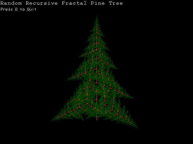

Posts: 12264
Posted: 02:18pm 13 Oct 2024
Here is one modified from the CMM2 Welcome tape originally written by Sasquatch.
Will run as-is on RP2350 VGA or HDMI or change to mode 0 for RP2040 VGA (black and white)
The code should give you most (all?) of the tools needed to implement the other CMM2 turtle demos https://github.com/thwill1000/cmm2-welcome/tree/master/turtle
Option explicit
Option default none
Dim integer TurtlePenup=1,TurtlePenColour=MM.Info(fcolour)
Dim float TurtleDirection=0.0
Dim float TurtleX,TurtleY
MODE 3
Option angle degrees
Option console none
Text 0, 0, "Random Recursive Fractal Pine Tree", "", 2
Text 2, 25, "Press Q to Quit", "", 1
turtle.penup
turtle.move MM.HRes\2,400
turtle.pendown
PineTree 70,19
Do :Loop Until Inkey$="Q"
Save image "b:/pine"

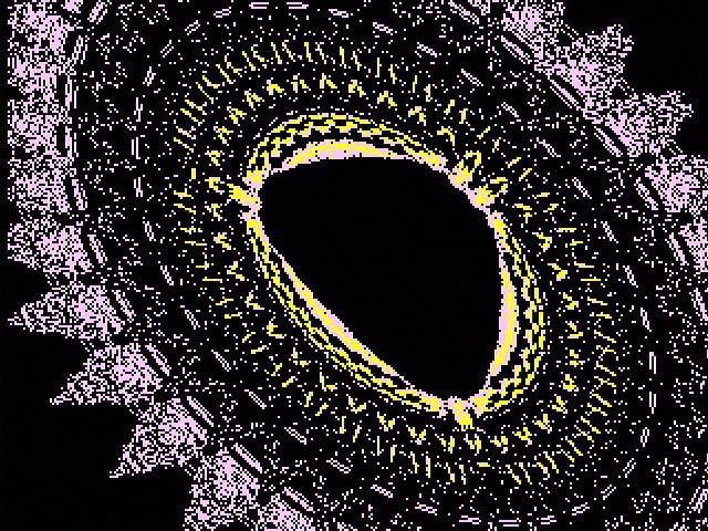

Posted: 05:15pm 20 Oct 2024
The Black Hole Mystery
MODE 2: CLS

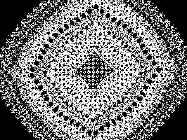

Posted: 09:42am 26 Oct 2024
Fractal Lace
CLS
A=1:B=-1:C=-13:K1=1.5:K2=1.5:X=0:Y=0

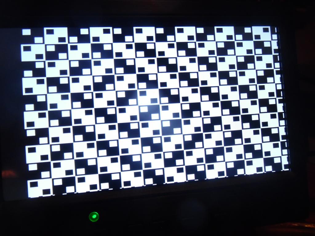

Posts: 2807
Posted: 10:17pm 01 Nov 2024
no lines but if there were they would not look curved
try it, better than picture
mode 2

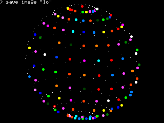

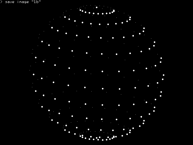

Posted: 06:59pm 07 Nov 2024
DISCO BALL
MODE 2
Option ANGLE DEGREES
FRAMEBUFFER CREATE
FRAMEBUFFER WRITE F
RX=MM.HRes: RY=MM.VRes: CX=RX/2: CY=RY/2
Umin=-180: Umax=180: Ustep=15
Vmin= -90: Vmax= 90: Vstep=15
SCALE=CY-CY/10
 For S=0 To 12 Step 3
 CLS
   For V= Vmin To Vmax Step Vstep
   For U= Umin To Umax Step Ustep
     U=U+S
       X=Cos(U)*Cos(V)
       Y=Sin(U)*Cos(V)
       Z=Sin(V)
     U=U-S
     C=Rnd*&hFFFFFF
     Plot_XY
     If Inkey$ <> "" Then End
   Next U: Next V
   FRAMEBUFFER COPY F,N,B
 Next S
Loop While Inkey$=""
Sub Plot_XY
 X=SCALE*X: Y=SCALE*Y: Z=SCALE*Z
 Y=Y/4
 X1=X-Y+CX: Y1=Z-Y+CY
 If y<0 Then
   Circle X1,Y1,2,,,C,C
 Else
   Pixel X1,Y1
 EndIf
End Sub
Edited 2024-11-08 05:00 by javavi
Posts: 2807
Posted: 07:31pm 07 Nov 2024
neat! hdmi 2350

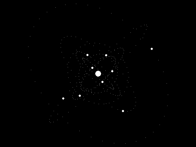

Posted: 01:37am 17 Nov 2024
The Mystery of the 9th Planet
FRAMEBUFFER CREATE
FRAMEBUFFER WRITE F
CX=MM.HRes\2: CY=MM.VRes\2
A=CX*5:C=&hFFFFFF
CLS
For i=7 To 31 Step 3
 For j=0 To 324 Step 9
   x=CX+A*Sin(j+i+t*i/200)\i
   y=CY+A*Cos(j+i*0.3+t/2)\i
   If j=0 Then Circle x,y,3,,,,C
   Pixel x,y
 Next
Next
t=t+.05
Circle CX,CY,9,,,,C
Loop Until Inkey$ <> ""

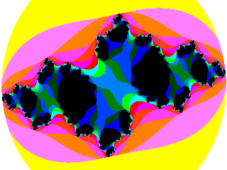

Posted: 08:07pm 17 Nov 2024
Morph
MODE 2

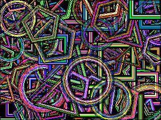

Posted: 06:11pm 18 Nov 2024
Geometric abstractionism
MODE 2
Do :CLS
For K=1 To 200
Q=Int(Rnd*5+3):If Q=7 Then Q=30
A=Rad(360/Q):S=Sin(A):C=Cos(A)
X=Rnd*320-2:Y=Rnd*240-2
R=Rnd*(Sqr(Y+X)/20)*20+16
 For L=-R/5 To R/5
  N=(Abs(L)<R/8)*Int(Rnd*16)
  U=R+L:V=U
  X1=X+U:Y1=Y+V
   For I=1 To Q

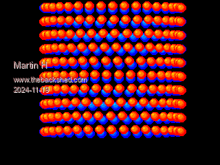

a litle animation inspired by the planet 9 demo
Mode 2
a=100:b=3:xc=160:yc=120
For n=0 To 9:For i=n To 180 Step 10
t=(i+90)*Pi/180:x=a*Cos(t):y=b*Sin(t):cl=(y<0):ball xc+x,n*20+yc+y-112,cl
Next: For i=170+n To n Step -10
t=(i-90)*Pi/180:x=a*Cos(t):y=b*Sin(t):cl=(y<0):ball xc+x,n*20+yc+y-112,cl
Next:Next
 Blit 0,0,0,200,320,20:Blit 0,20,0,0,320,220:FRAMEBUFFER wait
Sub ball bx,by,cl
For d=6 To 1Step -1
If cl Then :Color RGB(255,255-d*42,0):Else :Color RGB(0,255-d*42,255):EndIf
Circle bx+d/2,by+d/2,d,d
Next
End Sub
Edited 2024-11-19 22:03 by Martin H.
