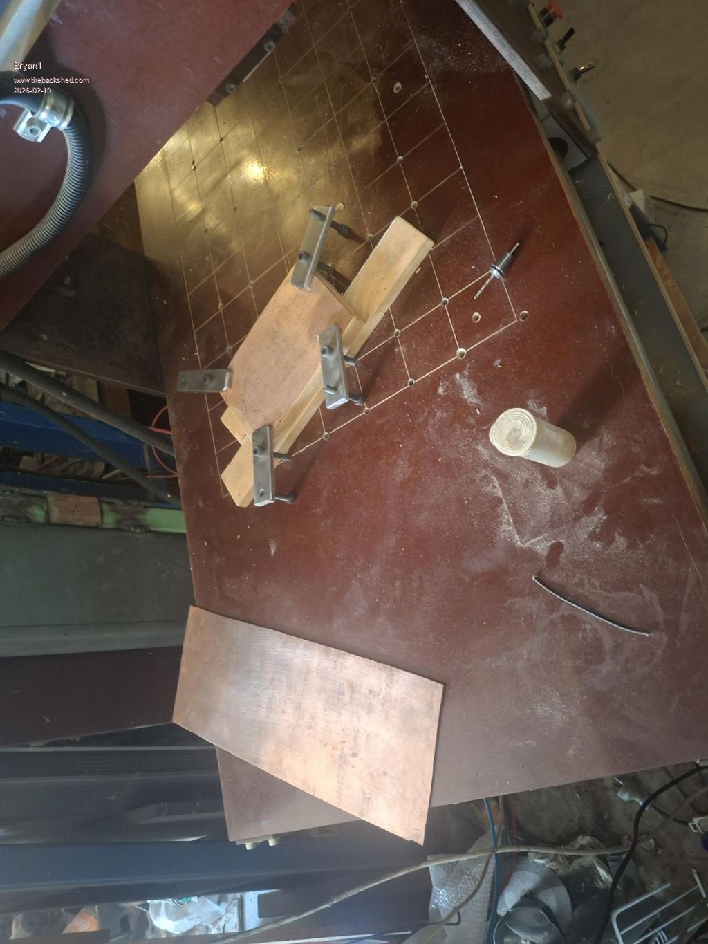

Well 6 months later got to thinking of making some perf plates out of copper so got Librecad 2D going on my MX.25 linux computer and found just how easy it was to snap to grid and soon got the drawing done.
So the next step DXF to GCode converter and found the result was like 141.5634 so thought not trying that. I just opened a text file  and looked at the snap to grid locations and made the file up which did take some time as there are 240 2mm holes along with 10mm and 19mm holes then use G14 to cut the diameter to 97.5mm.
The first job was finishing off the bed holes with are on a 50mm grid and tapped M6 so got plenty of mount points for the clamps. Managed to get a heap done then the X axis decide to give up for the day as the stepper was pretty warm.
So the next step was setting up the copper sheet so made 4 clamps and had enough cap screws to finish the clamps off.
The next day finished off the area I wanted for the holes and the X axis worked nicely, took the cnc to the other end.
Found that tub of 2mm drills so got plenty of spares then wouldn't one know it when trying to travel back on the X axis no movement and even with that fan I setup to cool the stepper the stepper looks like it's gone.
So got onto ebay and got 2 new steppers coming 57x84mm 2.4nM ones so got a spare for Y axis when it decides to say it's had enough.

Well while looking at the X axis with my scope yesterday saw the step pin wasn't working and for the ground connection at the time I just used a 2 pin connector and wire to join the connection. So I pushed the wire in and next thing the scope came to life.
So one little thing like that can halt everything.
