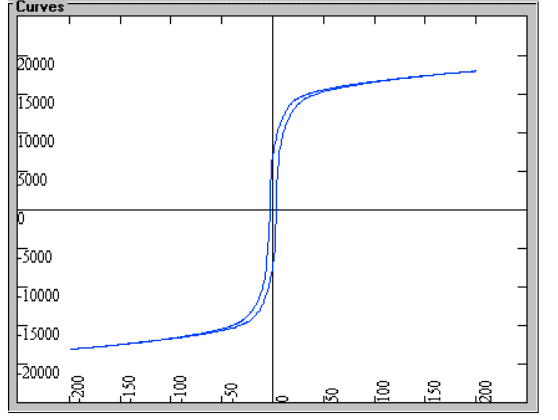

It is possible and easy to plot the B-H curve of a transformer.
A good and readable background on magnetics and B-H curves is
found here
B  is flux density
H is magnetising force
I like also the pdf of magnetically soft materials where a nice B-H curve is shown for a typical example.
B is vertical axis
H is horizontal axis.
For these toroids the B-H curve will be a narrow rectangle, very tall and not very wide when there is no saturation. This is because the Iron core is very magnetically soft. It will take any magnetic field and suck it all up. It will also not keep any remnant magnetism after the field goes away.
Compare that with a (magnetically) hard material like a permanent magnet as found in a hard drive. It takes a strong field strength and keeps it when the field stops.

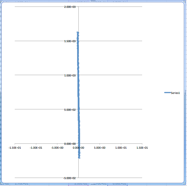

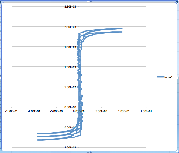

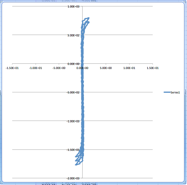

You can get the two quantities needed to plot the B-H curve easily.
The X axis is current. The Y axis is the integrated voltage across the winding.
Lots of DSOs can do maths on the inputs but I choose to use Excel to do the integration more accurately.
I thought it might be interesting to see the B-H curve for the above 1500W toroid
excited to 245V, even though it seems to be specified for 230V AC on the secondary.
I would expect some saturation at 50 Hz.
We know that when you drive a mains transformer, and this toroid is a "mains transformer", at higher frequencies you get less tendency for saturation. And when you drive it at a lower frequency than 50Hz, you will see more and more saturation.
50Hz, the is the beginnings of saturation, where the top and bottom of the
narrow rectangle are drawn out to the right and left.
60Hz, nothing at all
and 44Hz, where there is a lot of saturation.
All 3 graphs use the same horizontal axis scale, which is current.
The vertical axis is the integral of the AC voltage
as measured at the secondary winding.

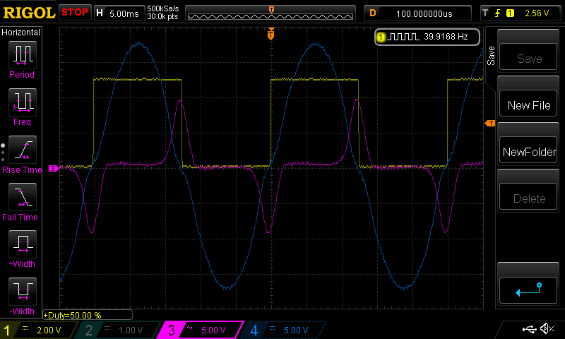

Here is the current and voltage at 40 Hz.
Purple is current
Dark Blue is AC voltage.
The current scale = 5V/div where 0.208V = 1 Amp and that means the
peaks are about 47 Amps.

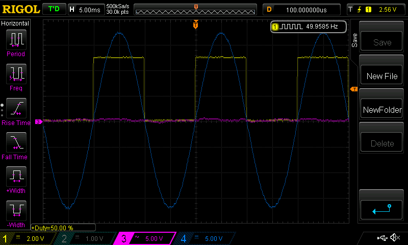

and at 50Hz, very much a different result.
The current is much less.
The DC current at 50Hz is 0.26A but at 40 Hz it rises to 0.86A
and it is clear to me why it increased.
Saturation of the toroid core can be thought of the time when the iron core can
no longer accept any more magnetising force from the primary winding and
so the primary winding becomes more and more a simple thick wire
and less and less an inductor.
