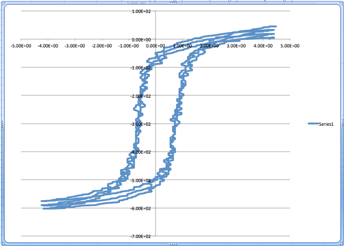

Here is the B-H curve of a IE transformer taken from a cheap UPS.
I think it was 600VA and had 2 x 12V 7AH SLA batteries.
You get about 15 minutes run time when you have a typical low
spec office PC and LCD monitor as the load.
This is at 50Hz:
This is a lot of saturation.
No wonder the UPS is cheap to buy. And the battery powered run times are poor.

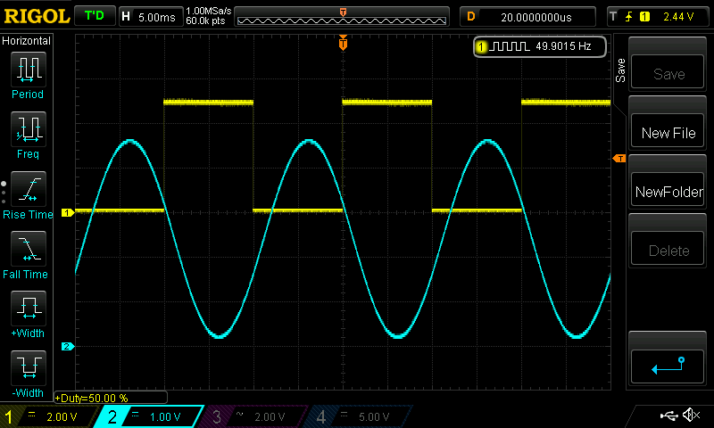

Hi Angelo
This is how nano1_7_etc type code works:
a 20KHz timer with PWM is set up. Each time the timer calls it's interrupt
some work is done. For the inverter application, we need a PWM pulse train
on one pin (D9) and the other pin (D10) is held LOW. This is maintained for 1/2 of
the 50 Hz cycle. Then for the other 1/2, D9 and D10 functions are swapped.
We are driving 2 half bridge inverter output stages.
The PWM pulse train is taken from a lookup table of precomputed values of
a 1/2 cycle sine wave.
I wonder what your project entails. I guess you are studying this at school or university. I think you would like one pin only to output PWM pulse widths
that range from near 0% to near 100%. This implies "zero AC volts" would be 50% width exactly. Now you will have a DC offset of about 1/2. This can be removed with AC coupling.

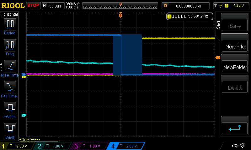

here you go:
nano_1_v7_no_bessel_angelo.ino.zip
Here is D9, low pass filtered with 4.7K R and 220nF cap, Light Blue
Yellow is D7, the 50Hz heartbeat or CRO trigger
Note the vertical scale and zero position for D9. It is DC coupled.

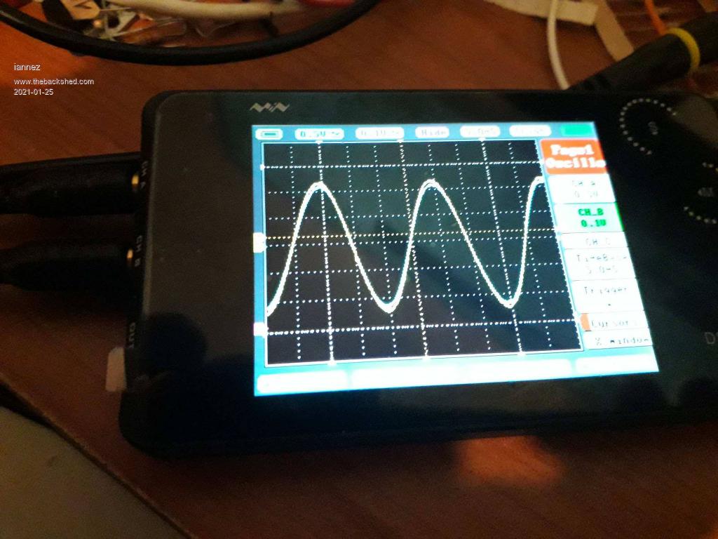

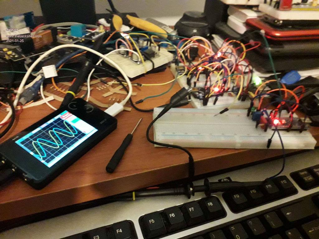

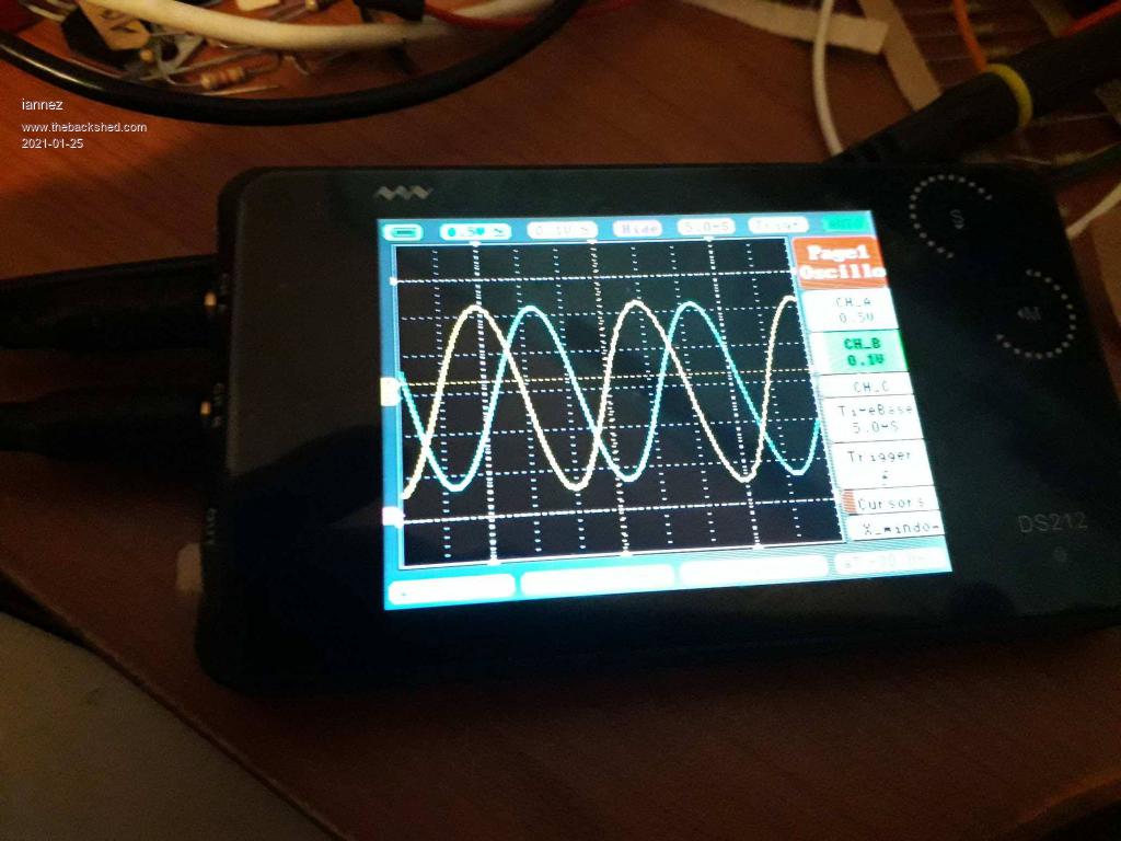

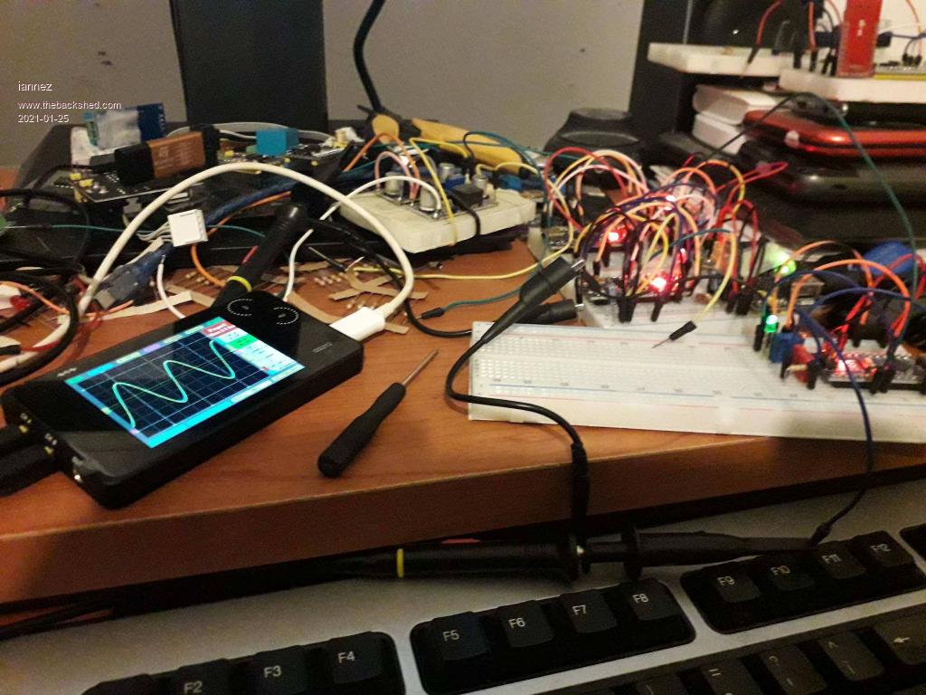

iannez
Joined: 05/07/2019
Location: Italy
Posts: 23
Posted: 03:31pm 24 Jan 2021
Hello Podia,
thanks for the edited sketch!
I almost understood how everything works ...
I am over 40 and I don't go to university, even if that's one thing
in the lineup that I would like to do sooner or later.
I consider myself an experimental physicist in heart and mind, first
because I love physics and then because I adopt this type of philosophy also in life, but in my daily work I am
a humble linux system administrator.
I have always had a passion for electronics.
 but unfortunately I discovered microcontrollers only this last year due to Covid as I am working from home and I have some time to devote myself to these studies.
I tested your sketch and obviously it works perfectly: D
as a generator I used the sketch present at the link on the previous page which uses the dds technique and produces a very stable sinusoid in frequency, also modifiable via pot if desired.
some photos:
phase KO, no pin D2 linked
phase OK, pin D2 linked via optocoupler and green LED light
in the last photo there are the two superimposed waves
I apologize for the awful setup.
I will buy a rigol 1054 as soon as possible :)
I only had to "modify" a couple of things to get the two waves in perfect phase with the same zerocross.
I read about this practice in one of your previous posts.
I inserted the _pcorrect variable which is managed through pin A0 mapped in the boundary values -200, 200 because I did not know regardless the correct value.
I did some tests :)
then I made the variable fixed so it doesn't flicker in real use.
volatile int _pcorrect;
void loop()
 _pcorrect = map(analogRead(A0), 0, 1023, -200, 200);
 //_pcorrect = -169;
ISR (INT0_vect)
phase_error = (pcint - _pcorrect);  //default value sketch orig. 4
I guess there is an automatic way to make the phase shift tend to about 0.
in practice now it is like the nano variac but with PLL and fullwave,
great for experimenting with a couple of things without using the H bridge
and using low voltage for now :)

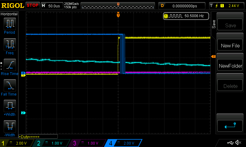

I just made a big change to the sync code where instead of adding +/- 1 extra pwm pulse to the output, I am now adding +/- 1 clock to the 20kHz PWM pulse generator.
This means finer control over the output waveform.
The width of the Dark Blue trace is the tracking error.
Before:
After:
It's about 5x better.
here is the improved PLL code:
nano_1_v7_no_bessel_angelo_syncv2.ino.zip
Again I use fractional math to calculate a running trim factor to the main PWM pulse gen frequency.
The tracking error is about 20us for a 50Hz frequency so it's
20uS / 20mS x 360 = 1/1000 * 360 or 0.36 degrees wide
It's +/- 0.18 degrees tracking error!

nano_1_v7_no_bessel_angelo_syncv5.ino.zip
is the result of a couple of days play.
I found I could tune the 50Hz by altering the 20kHz timer,
adding or removing one of the 800 clocks from the timer count.
I now do this in a more sophisticated manner:
for the entire 50Hz cycle, I modify the 800 clock count
adding or subtracting a clock (or not) to give the
required trim. Again I need a bit of fractional integer math.
The guts of the change:
i = pcount_delta/256;
ICR1 = PPWM - i;
pcount_delta = (pcount_delta - 256 * i) + pcount_acc + 135;
// 135 is trim for the 16MHz clock is not quite 16.0000MHz
// the trim puts the PLL loop correction at zero with a 50.0000Hz input signal.
// other wise pcount_acc would = 135 plus any calculated trim.
which occurs at the start of the 20kHz timer 1 overflow interrupt.
The PLL loop produces a value "pcount_acc" and this will increase or decrease
the frequency of the nominal 50Hz. If this = 0, then no change.
pcount_delta just accumulates the trim, and I get the top 8 bits, subtract it
from the 800 clocks, then calculate and leave the low 8 bits in it ready for the next
increment of pcount_acc.
This all permits me to carry 8 bits of accuracy after I do the integer division.
Results are good.
When the PLL is fed a fixed 50Hz to track from the signal generator
the original code is:
+ 50.0039 Hz
- 49.9988 Hz
with a 100uS wide uncertainty of lock position.
The above code gives:
+ 50.0014
+ 50.0003
and 20uS uncertainty
The frequencies are as reported by the DSO on the PLL locked 50 Hz output.

done some tests and with my miniDSO the waves are superimposed
with perfect tracking, i am saving to buy a serious DSO
that allows me to appreciate any changes or software tests.
it is impossible for me to measure in this way.
I just changed the interrupt mode for testing

The DG1022 is a good generator. Default output is bipolar.
You can set output to have a DC offset.
So, choose 2.5V DC offset with wave amplitude of 5V.
Output will now range from 0 to 5V.
The distortion you are seeing is probably due to the negative
part of the waveform output from the DG1022 being clamped to near zero
thanks to the nano digital pin internal diode protections.

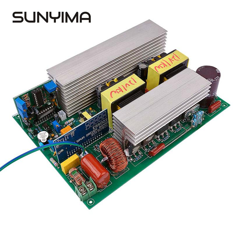

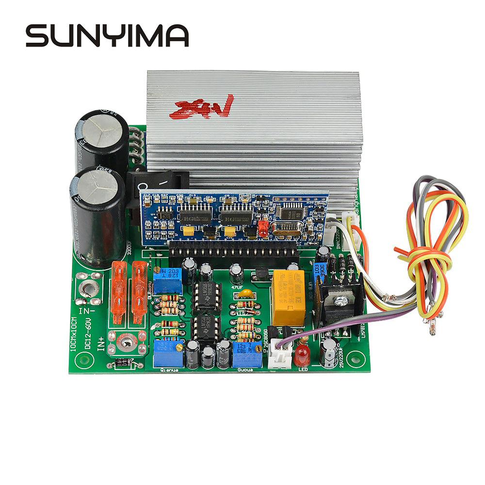

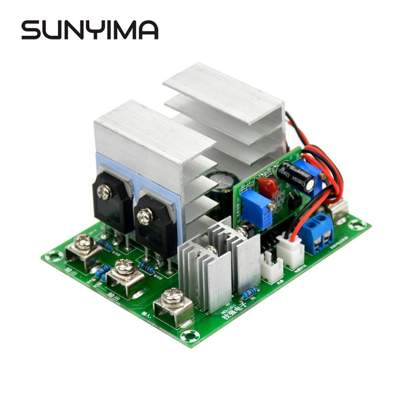

3 kinds of inverter arrived from aliexpress so i can also experiment.
the first, simple squarer that drives driversfinals:
the second, EG8010 which drives power amplifiers + recycled ups transformer.
the third, AC/DC converter with SG3525 and EG8010 for direct DC/AC
on H-bridge with high voltage.
with great amazement all 3 inverters work, proved simple
