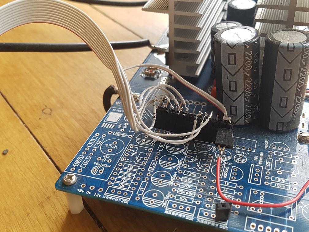

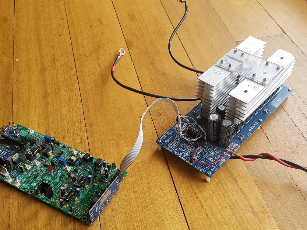

yes, here is how I do it.
I used a cheap bare PCB I obtained from the supplier and built the minimum,
being DC bulk capacitors, MOSFETS, gate drive resistors and diodes.
Nothing else at all.
The ribbon cable needs to connect
1LO, 1HI, 1VS, 2LO, 2HI, 2VS, DC ground, DC supply (48V in my case)
into the nanoverter 10 pin socket.
The inverter board is designed for the EG002 module and the pinout is
seen on the back of the module PCB.
I do not have any over current protection present.
The ribbon cable has long conductors that pick up and carry a lot of EMI
to both the MOSFET gates as well as back to the IR2148 driver ICs
This is not a well designed system. But it is outstanding in the ease of building, cost, and experimentation in my view.
This is a low frequency inverter, and so it requires a correctly sized inductor
in series with the primary winding of the output transformer. AC voltage feedback
is connected to the nanoverter.

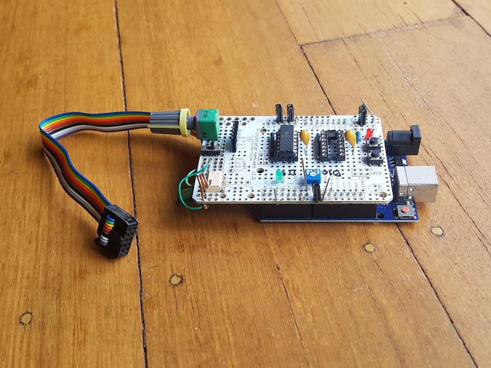

You can build the bare bones version of the nanoverter. This is the prototype
I made to prove concepts prior to nanoverter design.
It has only one IR21488 installed but you can see it's not very big. It sits on top of an Arduino Uno.
This board was used to develop most of the code including the mains synchronisation.
It also can and will run the above inverter power board.
You could build a similar small PCB for the gate drive and connect it to the Blue Pill, and then experiment away.

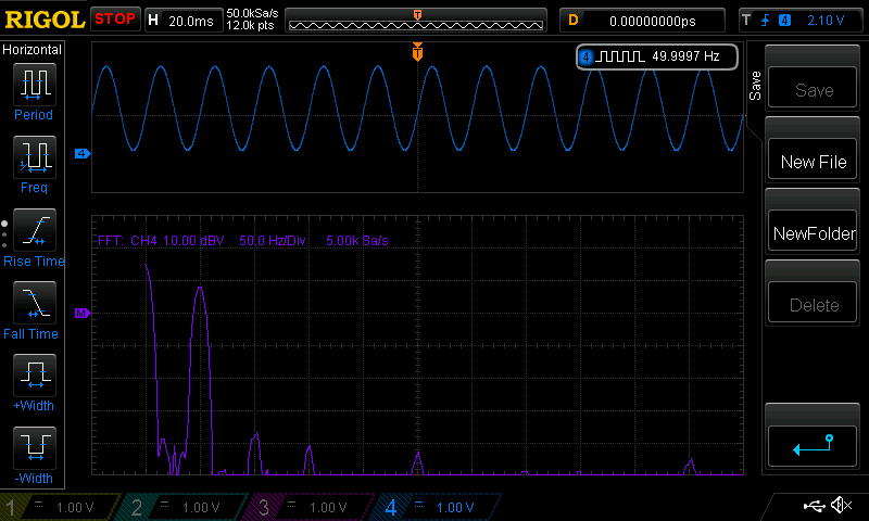

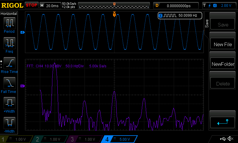

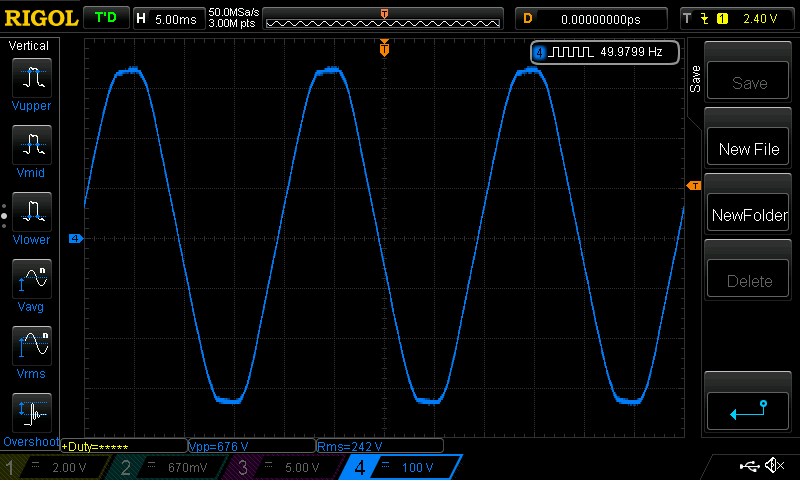

I think there is no value in trying to correct the shape of the AC output voltage.
My view is the AC voltage shape will always be something other than a nice
and clean sinewave. It will always have harmonics of various frequencies and power levels present that produce something like my street power voltage right now.
here is a FFT showing the harmonics of it
see the strong 250Hz component with -30dbV and the others
at 150 and 350Hz
These probably flatten the peaks of the waveform.
and for comparison, a clean sinewave, again at about 50Hz

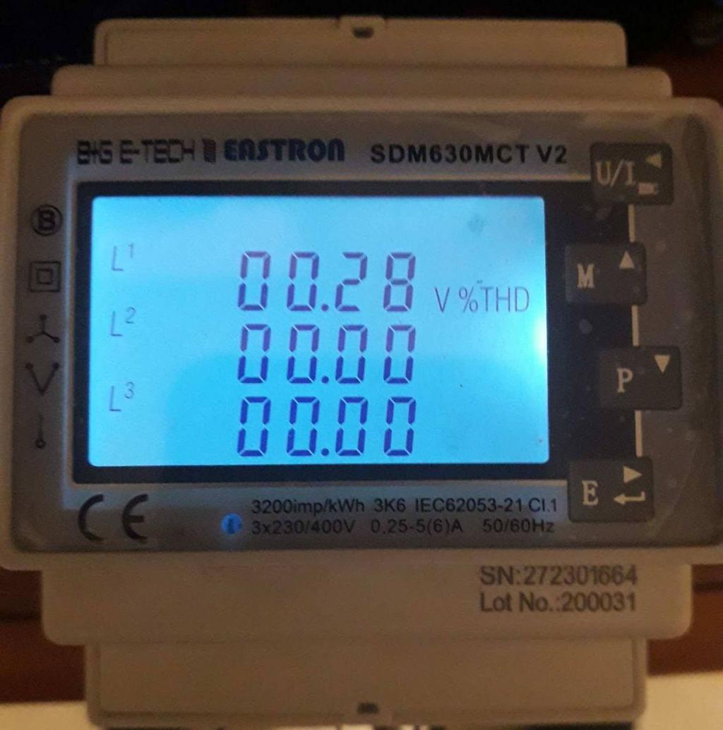

Good evening everyone,
Thanks for your answers!
I realized that playing with the 400vdc is not a good thing.
I remember that in one of the many jobs done as a boy (electrician)
to have taken the 10kv of a transformer for neon.
I lost use of my arm for 20 minutes.
and my heart was not so happy.
I understood that the LF transformer acts as a dam also for any peaks or current draws bidirectional, mitigating based on core type and sizing.
naturally also as a filter based on inductance or capacity present before or after.
i used all three inverters, but the one LF will be the base like test bench for experiments as you did.
excellent Peter, thanks for the support,
i checked what i have as hardware:
3 x ir21844 are equal to 2184? I don't think they are the same.
and 2 x ir2110
the other components are easily found here and there.
however I cannot find the schematic of your breadboard.
seen up here:
https://www.thebackshed.com/forum/ViewTopic.php?TID=9409&P=13
can you describe the pattern if you still have it somewhere?
do the navoverter boards advance to anyone?
I read about your THD analysis at this link:
https://www.thebackshed.com/forum/ViewTopic.php?TID=9409&P=5#105260
"Time to look at waveform purity. I calculate the THD of this prototype inverter to be about 0.5% (50Hz 70db, 3rd 25db, 4th 25db, 5th 20db, 6th 20db) via the DSO's FFT.
Not too bad at all. "
great, but the DSO Rigol can give you the distortion percentage too?
I ask because within a few months I will have to buy it,
it is essential otherwise I have no objective feedback on the changes made and the debugging of the problems.
i own this to test distortion.
0.28% because I measured at the output of the hifi ps audio conditioner.
at the input I have 3-4%.
Ciao! A.

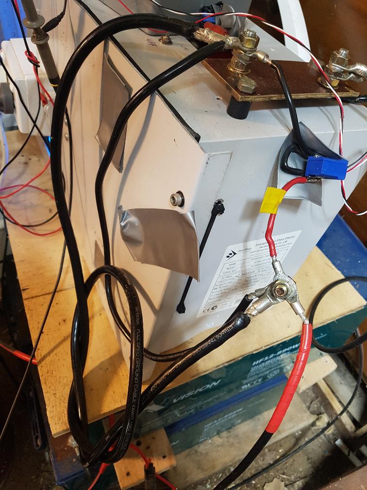

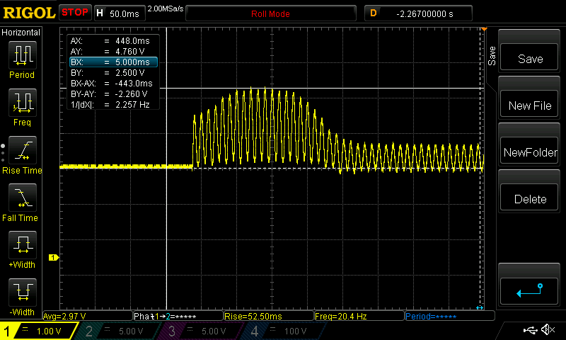

Today I was wondering what the peak current on the DC input of my victim inverter
was when I ran the air compressor.
The first test showed the current way exceeded 125 Amps so I needed extra
shunt.
in the below photo you can see the sensor (Blue) and the 3 shunts.
The smallest one is permanently soldered in place, to give 0.020V / Amp
I had to add the other two, to bring the sensitivity down to 0.0092V/ Amp
This means I can measure 2.5V/0.0092 or 270 Amps
Here is the switch on current for the air compressor:
Yellow is DC input current and 1 division = 1V = 108 Amps
Peak current is about 2.26 Volts up from the 2.500V zero level.
This is 245 Amps.
Once the motor settles down (and that only takes about 1/4 of a second)
the current drops to something more reasonable.
An interesting feature of the motor running is the negative current part of
the waveform. It is an AC induction motor after all so it has some reactive power component. This is what reactive power means - there is an exchange of current
between the source (the inverter) and the load (the motor) and this exchange
happens with positive and negative current.
I thought it best to see if I could put a larger load on the inverter.
So I switched on the 2500W 10 Litre hot water urn first, then ran the
compressor.
The Urn takes about 56 Amps DC from the supply. Adding this to 245 Amps is
about 300 Amps. Unfortunately the inverter popped the DC breaker.
OR was that fortunate? Anyway, it survived fine.

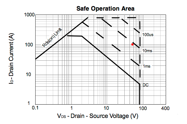

Some numbers on the above
245 Amps at about 47V.
If you notice, the waveform is sine but the frequency is 100Hz.
The peak current is at both the positive and the negative peak of the 50Hz
output.
Peak power during motor start is 245 x 47 = 11.5 kW
Wow.
In producing the sine wave output, current flows through (say)
the low side FETS of VS1 which is pulled down to ground and the high side FETS
of VS2 during PWM.
If for instance maximum voltage requires a PWM of width 80% that means
the high side FETS of VS2 are delivering 11.5 kW when only switched on for 80% of the
maximum time. So the current through those FETS is 11.5 / 0.8 = 14.4 kW at waveform peak current.
The powerboard in this inverter is a Madness 6kW totem pole type, with 3 FETS fitted on each of the 4 legs. This means 14.4 kW is passing through 3 FETS on the highside and 3 FETS on the other output low side.
Is this a reasonable result?
14.4 kW at 47 Volts is 306 Amps. There are 3 FETS so each FET handles 103 Amps.
The HY4008 specs give us something called Safe Operation Area
which is showing how much power (or volts x amps) is OK for different pulse widths.
here it is.
The two scales are log scales, you might not be used to these.
I marked a Red dot where 47V and 100 Amps is.
10 ms pulse width is shorter than the pulse widths used in the 20kHz
nanoverter.
looking at the above I think I am driving the HY4008 about as hard as it's
possible to go without fireworks.
Could anyone here maybe have a look at my argument and confirm or shoot down in flames as required? I am not an E.E.
Posted: 07:40am 12 Apr 2021
Safe operating area is a thermal limit of conduction loss only.
Ten milliseconds on, and then a cool down period significantly longer than 10mS.
Its switching on and off at 20Khz+ so there will be switching losses on top of conduction losses, and you cannot be sure that the current shares equally between the three mosfets.
But I think you might be getting pretty close to the limit, but difficult to know where the cliff edge of absolute ultimate doom precisely is.

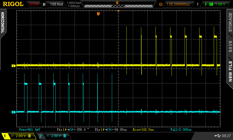

I have improved the nano/picoverter firmware, making the PWM pulsetrain perfectly symmetrical about the zero crossing points.
The results are good. (I don't know why I could not get to this point before.
Maybe I needed a couple of years away from the problem.)
This is the gate drive for V1 and V2 1/2 bridge drives.
In the past there was always a bit extra pulses just after zero crossing.
I have not tested this on a real live inverter yet so there could be a
nasty surprise but I doubt it.

The changes were 2 fold.
One was to time the changeover of D9 to D10 PWM at exactly the best time
which is before I write the new PWM width for pulse number 0 for a train of pulses
numbering from 0 to NPWM - 1
The next thing was to do this changeover before I wrote the new PWM width.
The sync pulse out D7 is now 2 PWM pulses early but the pulse train
is now symmetrical, probably to the nearest clock cycle.
