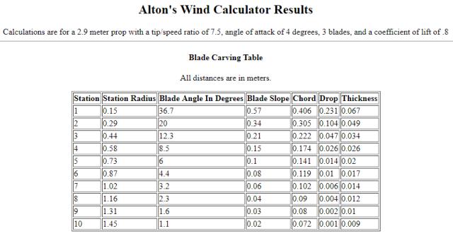

http://www.alton-moore.net/wind_calculations.html
Been using this wind blade calculator for years and it is pretty accurate

Hi Bryan1,
This was one of the first ones I had seen actually, but it says the same sort of thing. At the root, its like 400mm wide. That is massive.
Just doesn't make a lot of sense to me right now...

You might have missed this part.
Please note that near the hub you will usually be limited as to the blade's angle/slope, chord, and thickness by the size of the material. Usually it will suffice to use the largest result which fits in the material you are working with, or just carve the flat side of the prop from one corner to the other of the (rectangular) material. The outer part of the prop is the most important anyway.

I did miss that, thanks.
So is that saying, if the above table doesn't fit the material, then just wing it, and make it as big as you can at the root, and 'she'll be right'... ?
Then its basically a taper from the root to the tip.
Problem with the pipe is all the slops and stuff are not exactly easy, or possible to replicate.
I think ill just keep going with my hack job I am doing now, and see how they perform.

The centre areas is only a very small percentage of the total swept area so it does not affect it by that much. Near the centre the blades speed is much slower so that is why there is the steep angle and massive cross-section. That is in a perfect world which we don't live in, blades that are straight like the Aluminium ones still work well. Look at the giant wind turbines and see how they do it.

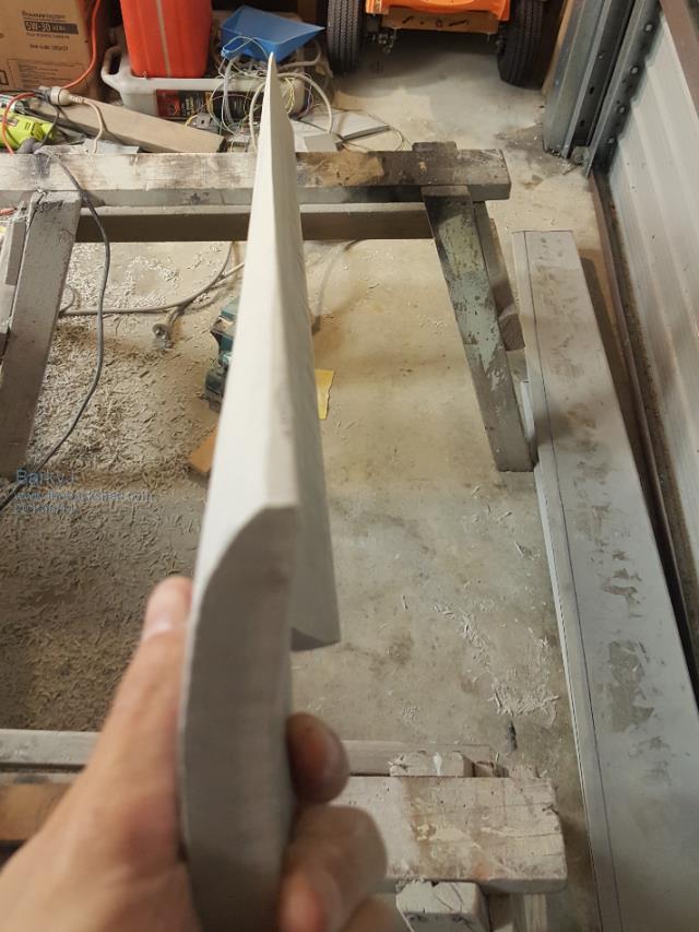

BarkyJ
Joined: 26/04/2018
Posts: 114
Posted: 07:47am 14 Jun 2018
I'll go weigh a blade shortly. Just have to go back to work.
Yep, one edge is sharp from about 1/4 down to the tip. The end of the tip is still pretty solid, so I need to take some meat out of that.
Unsure exactly how the tip end should be though. Somewhat rounded to match the 3m or so diameter I assume, but in terms of thickness I assume it needs to be thinned to be somewhat sharp at the tip too (not the edge I already have sharp, but the end)Edited by BarkyJ 2018-06-15

BarkyJ
Joined: 26/04/2018
Posts: 114
Posted: 09:16pm 14 Jun 2018
Blades are approximately 4.5KG each, at the moment. But still more trimming to go.
I'll leave the ends like an airfoil.
