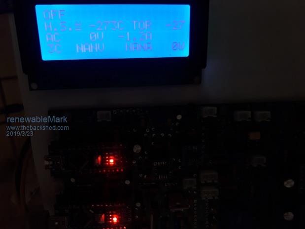

Ok, it looks to be related to nano2 code using a particular I2C LCD library.
I write to the LCD memory in the most direct manner possible.
I do not use LCD.print(blah,blah..)
This is a hangover from when I had all code running on one nano
so needed something fast when writing to the LCD.
I could not spend much time doing this before I had to service
PWM interrupts.
So I wrote LCD text, one character at a time, direct to LCD memory
bypassing the arduino LCD library overheads.
I wonder if the new LCD you have has a different controller and so the
way I do things will not work, ever, with your new LCD.
I need to change the code.
Maybe I can find the time to rewrite nano2 to use
the standard arduino LCD methods this weekend.

Frigg, sounds like a big job, sorry to be a pain mate.
Cheers Caveman Mark
Off grid eastern Melb

BTW I had two internet purchased lcd's, I thought they were the cause so got one from jarcar and it too has the same issue, so all three display the same trait.
Very frustrating how they appear to be made differently, you would think an I2c adaptor did just that and they all did it the same way, but clearly NUP.Edited by renewableMark 2019-03-23
Cheers Caveman Mark

  tinyt said   For the LCD that I purchased, I cannot get the backlight on unless I do a hardware mod or add the 'setBacklight' as follows:
lcd.begin(20,4); // LCD stuff
lcd.setBacklight(255); // <<<
lcd.clear();
Just noticed when this is added the nano lights up, loads then it briefly writes NANOVERTER, on the screen then it goes blank.
Without that extra line it just lights up. loads the nano then goes blank.
Cheers Caveman Mark

I did a quick and brutal hack of nano2 code so that it works using the same
libraries as Madness regulator
It's not good, but it works.
Not the sort of code I want to show the world.
2019-03-22_173528_nano2_2.ino.zip
Put this into nano2 and see if you get a display.
The backlight might come later.

Loaded that and it highlights
lcd.init();
And has below
In file included from c:\program files (x86)\arduino\hardware\tools\avr\avr\include\avr\io.h:99:0,

renewableMark
Joined: 09/12/2017
Posts: 1679
Posted: 02:08am 23 Mar 2019
Thanks,
that loaded ok, when the sketch is loaded the screen breifly said "NANOVERTER" then the screen lights up without any writing and the OC light comes on.
I have the reset (NC) plugged in. hit that a few times and nothing. Adjusted the trimpot then hit the reset, still the same, red light on constantly.
Cheers Caveman Mark

poida
Joined: 02/02/2017
Posts: 1515
Posted: 02:17am 23 Mar 2019
If the OC light is on, the inverter will never run.
Can you connect to the menu, via the serial monitor?
type "?" and press Enter, get a menu?
I am concerned that nothing much is displayed.
Even when shutdown, the LCD should show stuff.
renewableMark
Joined: 09/12/2017
Posts: 1679
Posted: 02:22am 23 Mar 2019
Tried that, it just restarts the nano, does the same thing and doesn't display the menu.
Cheers Caveman Mark

poida
Joined: 02/02/2017
Posts: 1515
Posted: 02:36am 23 Mar 2019
maybe this nano is broken?
you could pull it out of the socket, power it via the usb cable
and upload the software again. open the serial monitor and see what you see.
(need to wait at least 2 seconds after connecting via serial monitor
for any response..)
or maybe something on the board is stopping it from working.
first things first, let's see if the nano is OK or not.Edited by poida 2019-03-24
renewableMark
Joined: 09/12/2017
Posts: 1679
Posted: 03:17am 23 Mar 2019
That got it
Cheers Caveman Mark

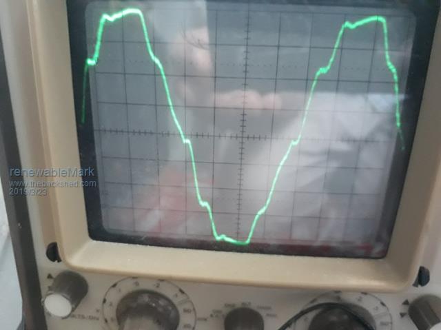

renewableMark
Joined: 09/12/2017
Posts: 1679
Posted: 06:01am 23 Mar 2019
OK running the house now, tripped a few times due to scr.
To increase the allowed current turn the trimpot anti clockwise.
So wave is perfect on everything apart from the dreaded inverter air con as below.
So how to smooth that out??
Tinker previously said to remove the ferrite, I'll give that a go.
Failing that what would smooth out the voltage to stop/reduce these spikes being placed on the machine?
Choke on air con 240v supply?
Big caps on 240v inverter output?
Cheers Caveman Mark
mackoffgrid
Joined: 13/03/2017
Posts: 460
Posted: 06:35am 23 Mar 2019
What brand and model is that inverter Air cond ?
Posted: 06:41am 23 Mar 2019
Would not have a clue Mark.
So many issues it could possibly be. But if the aircon is the only load that does it, that is probably the place to start looking.
I think I might run the aircon off the grid, and look at the current waveform as a first step.
renewableMark
Joined: 09/12/2017
Posts: 1679
Posted: 06:42am 23 Mar 2019
Mitsubishi SRC50ZSA-W
Cheers Caveman Mark

renewableMark
Joined: 09/12/2017
Posts: 1679
Posted: 06:43am 23 Mar 2019
  Warpspeed said   Would not have a clue Mark.
Yeah tried that, it's perfect running with grid.
Cheers Caveman Mark
