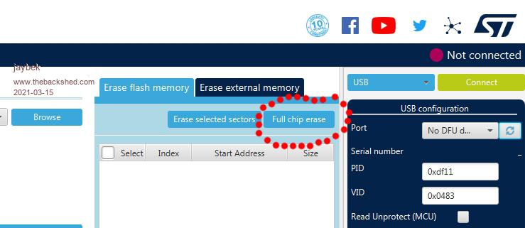

I picked up an F4 + LCD bundle. The USB bootloader and STM32CubeLoader appear to work fine, but Windows 10 doesn't see a USB port when I disconnect / reconnect with BT0 grounded. I tried "mass erasing" the board via the STCube app, a different USB cable, and different versions of the Armmite FW - no dice. Any diagnostic / troubleshooting tips on offer? I don't think it's a flaky USB connector or cable, otherwise the FW upload wouldn't work - right? Maybe pulling the battery to fully purge the board? I left the LCD disconnected thus far - does that factor into anything?

Try removing the jumper all together, as its not needed, this will eliminate possibility of it being in the wrong place.
Hold Key1 down while applying power, ie plugging in the usb cable.
This will ensure a full reset of MMBasic.
Also check in windows device manager to see if the USB port is coming up under Ports(COM &LPT)

I also had quite a few problems with bad solder joins on the USB connector - gave me intermitents just moving the board slightly. It's a !@#$% to get into to touch up as the nRF connector is in the way.

I just tried (a) holding down K1 at power-up, (b) pulling the battery, (c) connecting the freshly-flashed board to another PC running Win10, (d) running the STCube flashing process on that other PC, and (e) booting the F4 board with all jumpers disconnected.
I've also tried F4507b1, b4 and b7 - no difference.
I am 98.5% convinced there is no fault in the electrical part of the USB connection, as Windows detects it just fine when I plug the F4 board in while it is in DFU mode (i.e. with BT0 at 3.3V and BT1 at GND per "Appendix G" in Gerry's excellent manual), on two different PCs, using two different USB cables.
In all cases, the STCube application downloads/verifies the .bin file without any error.
Here's one more possible clue: in one of my DFU attempts, I checked the "Run after programming" in the STCube software, after which the USB connection was broken following the erase/write operation. Normally, the "USB1" bootloader connection remains alive after programming, and you have to "Disconnect" it manually in the STCube app.
The only other thing I can think of is I am not using the "right" model or vintage of the F4 board, but mine looks exactly like all the posted pictures - it's marked "STM32F4VET6".
Is there any other factory reset or "purge" option on the board, or any kind of "exerciser" FW image (e.g. diagnostic tools from STM) I can try to verify that the HW (particularly the USB com port) is or is not working correctly?

If you're up for more experimenting, you might try to see if you can get serial console as per page 22 of the F4 manual. Hook up a serial-to-usb module at 115200 to the J6 pins, press and hold the button on the F4 labelled K0, and reset or plug in usb power.

Firmware can't rescue a H/W issue. If you have a scope check things like the crystal being driven. The programming uses an internal clock so it is perfectly possible for the device to be programmed but not run if there is a H/W problem

If you attach the LCD and power-up does the LCD go all white and then clear to black? If it does then the processor is running and the issue is with USB. If not then it definitely isn't running properly. If it is running try using a serial console as explained above.

@RetroJoe.
I had the exact same errors with my board, as you describe.
I got it to run by pressing the "Full chip erase"-button in STM32CubeProgrammer, before uploading the firmware.
Hope it does the trick for you to.

@ jaybek, Thanks! I did try that at one point (I tried just about everything :), but it seemed to hang the STMCube app. I'll give it another go. What FW version are you using?
@ Peter, I can confirm that the LCD, if connected at bootup, is white and stays white I.e. all pixels on.

  Quote  Peter, I can confirm that the LCD, if connected at bootup, is white and stays white I.e. all pixels on.
This means the processor isn't running. I would suspect the crystal and load caps as a first try
