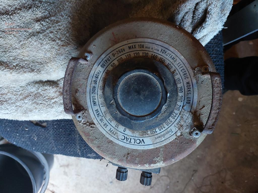

Well this Mad inverter build just got a new twist I do have an old variac here I blew the fuse on trying an old water element I had here.
Lost the fuse for it and got the tape measure out so around 200mm diameter and 80mm high, it does look to have 1.6mm wiring on it and as the name plate say it's good for 2.4Kw so thats is going to be the donor toriod for this build.
Now I have been trying different configs of chokes now I have the Altronics LC meter and this small toriod with 7 turns of my enameled wire got 12 mH so I may need to setup pin 9 on a nano to test it first as I do have the scope here to look at the knee.
I do have a couple of 8010 boards here so if Eddy is looking he can have one if he wants as I did get a couple for my first inverter build.
Cheers Bryan

Hey Bryan, that toroid/choke sounds wrong and may be just ferrite material as for a common mode choke, and not made up of iron dust material. The choke for an inverter should be more like 40uH or ~ 300 times less than 12 mH???
Cheers Mike

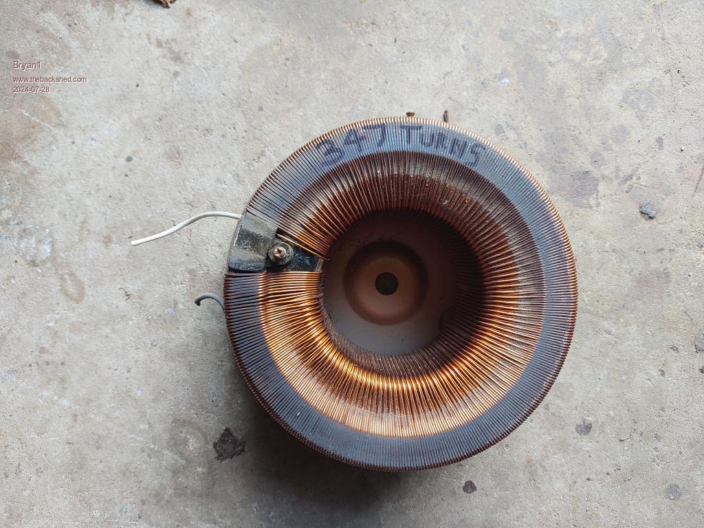

G'Day Guy's,
Well that old Variac has become a donor for my inverter projects.
It was a bit of fun to get apart with generation old phillip head screws need a touch with a chisel to get them moving.
The wire is 1.2mm and 347 turns so hopefully this can be used. Now the bottom plate is there loose and with a 80mm hole plenty of room to put a decent primary in.
Regards Bryan
