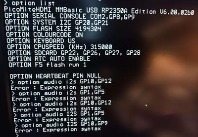

electricat
Joined: 30/11/2020
Location: Lithuania
Posts: 299
Posted: 09:01am 25 Jan 2025
latest beta, RP2350 HDMI/USB
entering --> OPTION AUDIO I2S GP10,GP12
Gives "Expression syntax"
tried different combintions
My MMBasic 'sand box'
Posts: 12176
Posted: 09:06am 25 Jan 2025
  Quote  latest beta, RP2350 HDMI/USB
Not according to the screenshot. In any case GP12 is used for HDMI.
Edited 2025-01-25 19:09 by matherp

electricat
Joined: 30/11/2020
Location: Lithuania
Posts: 299
Posted: 09:32am 25 Jan 2025
Right. I tray eliminate such overlooks, but failing.
I must be more accurate in future
