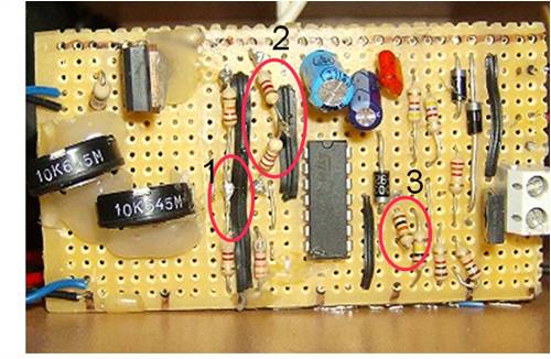

can you post a photo of your board ?
Also check the value and location of the 10k resistor and jumpers.

Posted: 07:52pm 19 Feb 2010
this is the photo

Posted: 08:31pm 19 Feb 2010
I don't see one of the jumpers for paralleling the pots, are they both there ?
I'll look closer later.

Posted: 08:35pm 19 Feb 2010
it is there under the silicon right side of the low volt trimmer

I have a few questions about the board as its a bit hard to see clearly.
1...looks incorrect to me(solder bridge??)
2...What is the combined resistance of R1 here.
3...What value is this resistor as it looks like 1K and should be 10K
What voltages do you have on pins 5,6,7 as looks to be something wrong with op2 voltage, as when op1 (pin1) goes low the relay switches off.
This would indicate op2 (pin7) was high, at the time op1 goes low.
Op2 should be low (1.2 -1.5v) and go high when the voltage is around 12v or adjusted to suit.
You will need to check op2 voltage and get that to be high at 12 volts and go low at about 0.2 volts above 12v.
This not happening so no hysterisis.
Pete

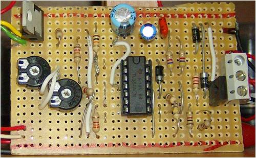

I also noticed you did not use a socket for the ic, so I must ask what type of iron and heat settings you used when soldering on the chip itself especially if you have tried more than one.
Bob

Posted: 07:18pm 20 Feb 2010
hello again and thamks for your questions shows that you game me some time.
answers
Bob i used standard solder and a 60 watt solderind device(i dont know the english word for it).
in this bord i did not tried other ic's.
i tried them on the second board atemting to debug the board
Pete
1 i just cut the resistor and test the resistanse and then resolder it again it seems that is bridged but it is not i left some of the wire and it is above the other resistor show it seems like a bridge.
2.the combined resistance on my multimeter is 10,2k oms
an 8k and a 2,2k
3 10k the last one i had it has a thiker red line, 3 times check on my multimeter .
I will leave this bord for the time and i will try again with a new one.so i can cross check the two boards.for the hysterisis problem i will just power the controller from the windmill not the bateries.
what do you thing about that?

Use a socket this time for the ic they are cheap or even a used one if you have some junk around; this will keep the heat and possible static from your soldering iron off the chip itself and make it easy to swap out chips without damage.
Then install the chip tl084 last.
You also need some type of varible power supply to set the high and low pots; using the windmill alone may let the magic smoke out.

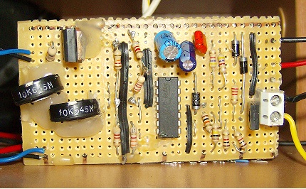

kalamidas
Joined: 19/02/2010
Location: Greece
Posts: 21
Posted: 08:50am 21 Feb 2010
this is the third board and this is the readouts
12v 13.5v 15v
0.61 1 14 6.46 0.61 1 14 6.46 0.61 1 14 6.45
3.53 2 13 3.92 3.71 2 13 3.94 3.89 2 13 3.34
2.83 3 12 5.90 3.21 3 12 5.90 3.47 2 12 5.90
7.89 4 11 0.01 7.89 4 11 0.01 7.89 4 11 0.01
2.85 5 10 0.01 3.21 5 10 0.01 3.47 5 10 0.01
2.86 6 9 7.10 3.21 6 9 7.32 3.47 6 9 7.32
7.10 7 8 590 7.28 7 8 5.90 7.32 7 8 5.90
