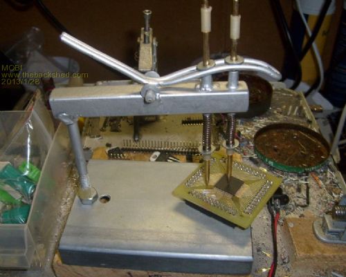

HI,
Downwind made me a tool for locating SMD devices to facilitate easier soldering. He doesn't remember posting a picture of the tool.
I found it wonderful for holding the PIC32 in place while I soldered it.
The curved lever allows one brass pin to be lifted before the other so that the back pin can hold the PCB still whilst positioning and then pinning component. It is brilliant.
In the back ground is the jaws of a PCB holder vise that allows the board to be flipped over.

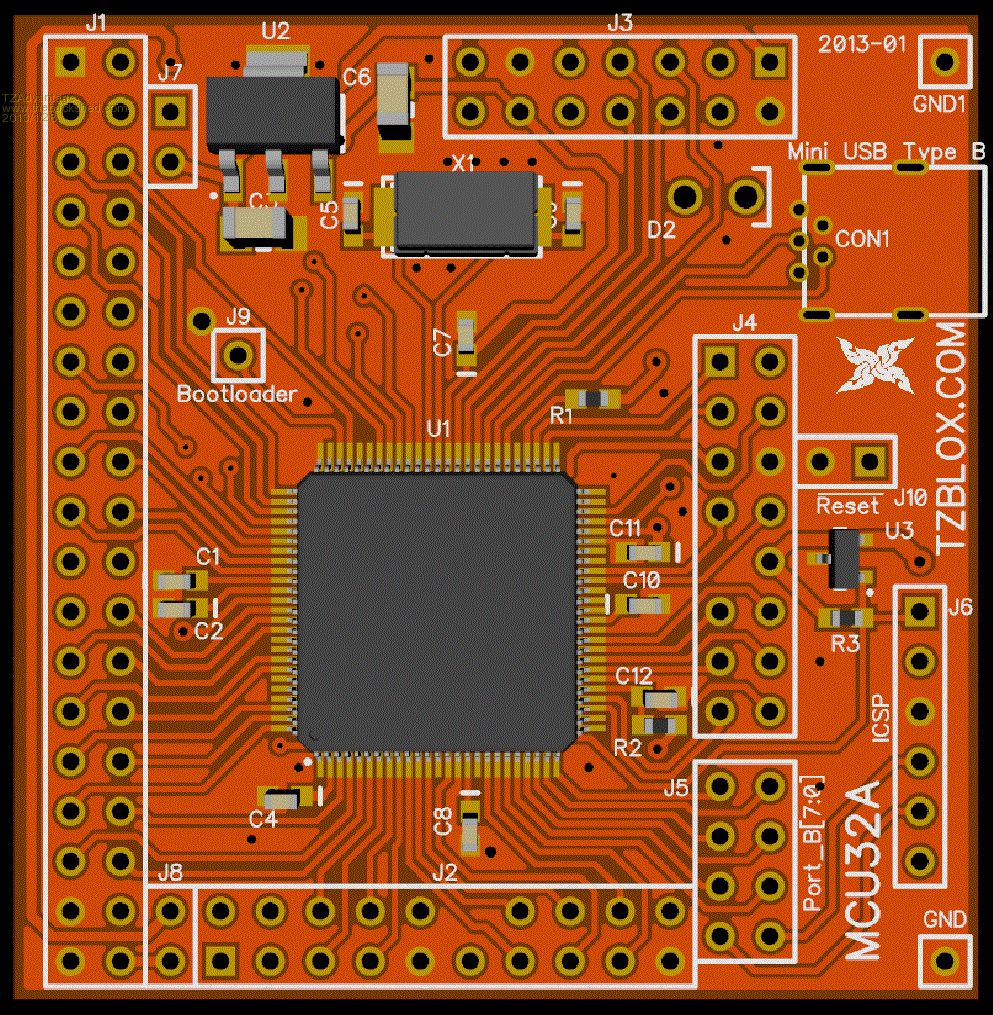

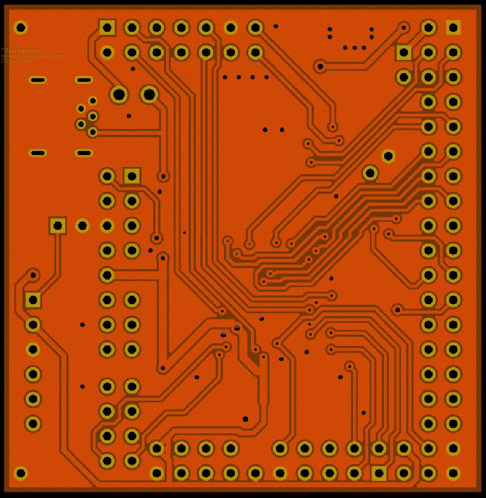

Here are my schematics of the small pic32 board.
I would welcome feedback and error spotting.
It also contains tables summing all the possible pin uses.
My first project using Diptrace, it went pretty smooth.
The design has many uses in mind and can be hooked up in different ways.
With female connectors it can be used for prototyping. For production it can be put on a 'motherboard', use a backplane when lots of circuitry has to be controlled, a board can be piggy backed (this will be my way of mankig it MM compatible), or pigy back a small CAN and LCD module, or a GPS module etc...
The goal is to make the step from prototyping to final product very smooth as you can use the same part for both.
In the minimal form it should already be able to run MMBasic and use it through the USB with a terminal.
After error spotting this will be send of to make some prototype pcb's, if someone wants want to help me test it, i would be glad for the help and send you one.
(Printing to a pdf has some label offset problem. Not able to fix that, probably need another, i use bullzip pdf printer now. No such problems with a real printer.)

Size of the board is 50mm x 49mm.
front:
Back:

  TZA said  After error spotting this will be send of to make some prototype pcb's, if someone wants want to help me test it, i would be glad for the help and send you one.
I wouldn't mind helping you test it and bear any costs you may incur as a result. I like the design and about the same size as my breakout board too but with all the power & reset chips etc.
If you do a parts list, I think that C1 (10uF) needs to be specified as tantalum or similar low ESR (1ohm).

I am waiting to get all of the parts used to be able to finalize the pcb design.
Sometimes certain smd sizes are hard to get, so i am trying to source the most common sizes. Especially C1's pads can change if i need a bigger footprint.

According to Geoff's site:
It must be a low ESR Tantalum capacitor or a 10uF ceramic SMD capacitor between the solder pads for C5 (or C3). The best fix is to use a 10μF 16V Ceramic with a X5R dielectric.
A 10μF 16V Ceramic X5R is 1210 size and a 6.3v one is 0603.
A 1210 is close to impossible to put on the board, a 0603 is what i currently use.
Would there be a big difference between a 16v and a 6.3v version?
The ESR on X5R dielectric should be lower then 1, even mbetter then tantalum.
Is ESR the most critical or other characteristics?
I am trying to source a few of those, but mainly here it is sold on a reel, and that means 4000 pieces.

  TZAdvantage said  Would there be a big difference between a 16v and a 6.3v version?
No difference in capacitence between the two, but the breakdown voltage is the thing. According to the Microchip PDF and comments by MOBI, this needs to have a voltage rating of at least 6v, so 6.3v should be safe, and was the one I would choose over the 16v one.
Can you not order from Element14 - there are stores in Australia, England and the United States - you can order as many or as few as you want, of any type you want, therefore not requiring the purchase of reels of parts...

The higher voltage ones often have lower ESR, but i am certain the X5R is low enough.

  TZAdvantage said   Here are my schematics of the small pic32 board.
nice bit of layout, but a few suggestions:
1. place all the pin headers on a 0.1" grid, so the board can be attached down to veroboard or similar and have all the pins line up. that is one of my main complaints with the arduino, where one of the headers is off-grid;
2. i'd up the footprint of the 10uF ceramics if you can, it is always easy to solder a smaller package onto a bigger footprint, but not vice versa;
3. provide thermal relief around all component leads and header pins that connect to any ground or supply planes. as it stands, you'll find pins on headers that are connected to ground quite difficult to solder, and even more difficult to unsolder. "thermal relief" means keeping the pad isolated from the surrounding plane, and connecting to the plane with just a cross of 25 mil tracks. similarly with the SMD capacitors, which will be quite difficult to solder otherwise. the only exception is the tab of the 3v3 regulator, where you want good thermal transfer.
