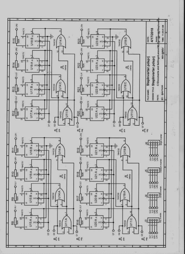

Posted: 11:53am 27 May 2017
Thats a really nice looking circuit board. Well done !
Funnily enough I also did a 1K to 3.3K change myself, although it made no difference to actual operation.
Check the data waveforms coming straight out of the eprom, there will be a burst of noise every time the address bits change. The clocked latch should remove all of that.
I like to see that the latch actually clocks well after the data chaos has subsided.
If you use an eprom faster than about 150nS and high speed (HC) cmos chips, as I expect you already have, it should all be fine.
There is no reason why there should be a problem, but just check that everything is squeaky clean and no possibility of occasional noise glitches.
Your waveforms all look very nice from what I can see, but its vital there are no occasional glitches.Edited by Warpspeed 2017-05-28

Posted: 02:27pm 27 May 2017
Thanks Tony, that's high praise and appreciated.
Yes, I took note of your various comments and incorporated them. I ensured the eprom was better or equal to 150nS (I think its 120) and all the logic is HC except for the slow or 2nd 4040 .
I will investigate further to ensure there are no glitches coming out of the eprom. I am wondering about making a detector to catch glitches etc and logging it, as a proof that all is well.
Posted: 03:53pm 27 May 2017
There should not be any problem, the output latch cleans up the whole show.
The rest of it should now be fairly straightforward.
If you begin with the largest inverter and get that going first, then successively add the others. Its probably the most logical way to proceed.

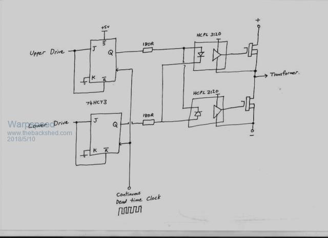

Posted: 07:24pm 08 May 2018
  kanchana said   Any updates on this type of cascade inverter ?. Any one tried to program micro or any updates on the built. I am thinking of building a one
Yes, its still slowly evolving, and the latest effort has advanced a very long way since the original prototype.

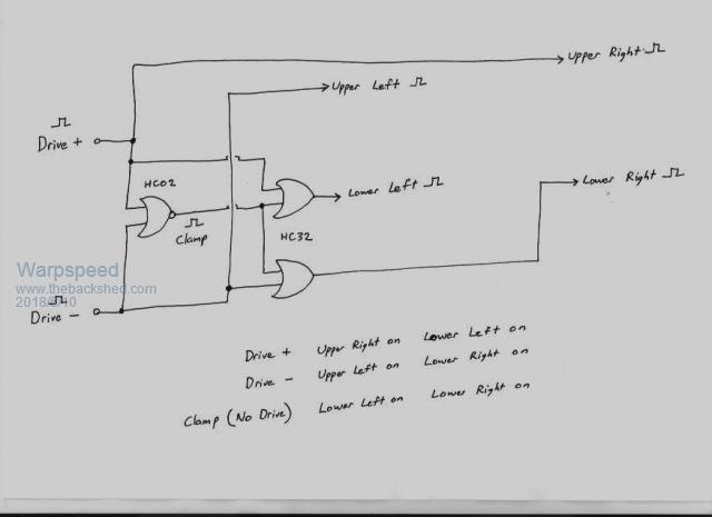

Another step forward was to use the main four mosfet bridges to provide clamping action to the transformer primary directly. Two diagonal mosfets turn on in the usual way to enegise the transformer if a positive or negative square wave voltage step is to be developed.
For zero volt clamping mode, I turned on both lower mosfets simultaneously which provides an effective low impedance short right across the transformer primary.
This all works very well, and it definitely simplifies things a lot.

Now I can have some thing to work with . I came up with this schematic , how to use new clamping method using the main 4 mosfets?
2018-05-10_180603_TEST.pdf
Regards kanchana
Posted: 09:34am 10 May 2018
First I used some logic gates to develop the four individual bridge drive signals from the two eprom data bits.
These four bridge drive signals then must have some suitable dead time added.
I did that using JK flip flops. A logic low instantly resets the flip flop giving fast turn off.
But a logic high on the J input does nothing until the next clock edge arrives.
The frequency of the dead time clock can be changed to set the required dead time.
The advantage of doing it that way is that with one movable link I can change the dead time on all sixteen JK flip flops together.
And then there is the inverse opto coupler connection trick which makes simultaneous cross conduction of both upper and lower mosfets all but impossible.

excellent work . Any significant advantage of changing the dead time often . I believe it should be 1us or larger
Regards kanchana
Posted: 10:26am 10 May 2018
I built all the drive circuitry first, without really thinking through what I wanted to drive with it.
Originally I planned on mosfets for the whole thing, but since then I think I will first try some really big IGBT half bridge power blocks that I already have here for the two larger inverters. These are slow, but switching at only 50Hz there is no real need for speed.
IGBTs are more suitable for much higher voltage. This will run off thirty lithium cells at around 100v nominal, so IGBTs are borderline. But I have these big 200 amp monsters that I would like to put into something, and I will give them a try first.
I expect to have around 1uS to 3uS dead time initially, but we shall see.
