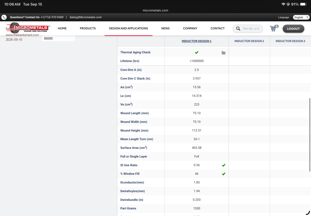

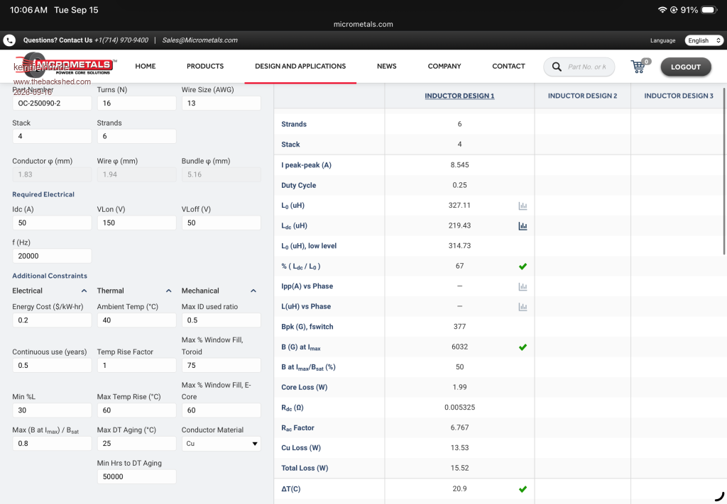

That kool mu core would work but it requires quite a bit of copper to get the copper losses down and it’s quite. A bit of turns. I may purchase another core and stack two of them. With one core you’re loosing an lot of inductance at 50 amps because it’s operating on the tail of the curve.
I was looking at micro metals and trying different configurations.
I found a really good potential design.
It uses a stack of 4  OC-250090-2
16 turns
If they aren’t too expensive I’m thinking about trying this design.
Edited 2026-09-16 03:09 by kentfielddude
