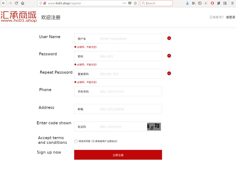

Well theres good news and bad news....
Bad news is HC01.com is currently dealing with sales in China only atm
Good news is that they are 'thinking' about setting up an english online store possibly, perhaps, maybe...
They also have a rather large range of other modules in their lineup too, usb hc12's, bluetooth, wifi, all sorts of fun toys
There are definitely clones/fakes out there not being made by HC01.com, real ones have the thick white printing on a blue pcb, and t300 crystals, anything else is not a HC01.com board
I am attempting with her help to set up an account atm, and might possibly be able to provide a 'idiots guide to buying hc12s', they do do paypal or direct debit via bank accounts (I'd stick with paypal I think) so if I can figure out what buttons to push and put it in a simple step by step instruction set, you would be able to order directly from them even though its in chinese....
fingers x'd, we'll see if it happens (currently I am stuck on their account section doesnt accept my australian address, I am awaiting a reply on how to 'trick' their system into accepting an aussie address...)

They sell in singles or small numbers, but only in China atm
I have access to a Chinese reader, plus the email contact speaks (types) English very well
I have a literal translation of their ordering page, and am in the process of trying to get an account with them atm, the issue is that their website signup doesnt allow for an overseas address, phone number etc, and is throwing errors at me, I have contacted my email contact and am waiting for a reply to see if either I can be manually entered into their account system, or what format the account data needs to be in to be accepted by their online form.
Obviously doing this in a language I dont speak (or read) isnt the easiest thing, but am making some progress, if I am successful, I will (probably) be able to make up a 'cheat sheet' to ordering directly from their website (a click on this button, type this in here type thing with pics etc to make it easy for an english speaker to fill out their forms etc)
This is the end point I am aiming for, whether it will be achieved?? who knows...
A lot still hasnt been determined about their ordering system (can it post anywhere or only in China via their online shop?? dont know yet, neither does my contact, she doesnt know if it has been done before, they have sent some big orders out manually via email to overseas, but that would obviously require either a large single purchase by one person to resell on, or a group buy as a single bulk order. If we can order via their website in small or single units, that would be the best- short of them actually redesigning it for english users lolEdited by Boppa 2018-05-17

Working on something like this- IF I can get their online shop form to accept non Chinese street addresses and phone numbers, and IF they mail out of China via their website... otherwise we would be stuck with bulk ordering and doing it all via email (what they currently have done in the past)- my email contact has confirmed she can (and has) done this before, but being able to order small quantities through the shop direct to the person wanting it would be preferable obviously
If we can get it to work that is...

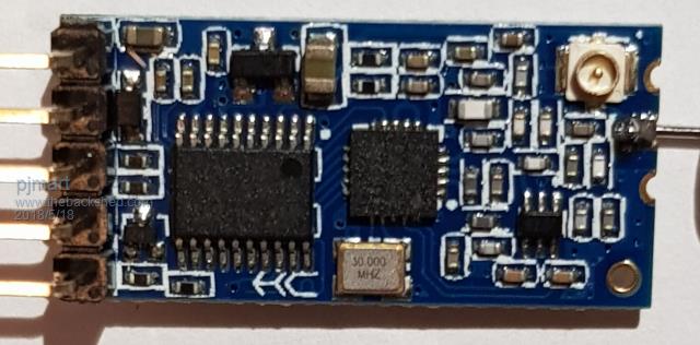

Some further information.
I purchased 3x HC-12's back in 2016 which meet the criteria as original(T300 crystals, heavy white silkscreen on the back).
Earlier this year I purchased 3x more from a different source only to find they will not communicate with the older ones but work quite happily with their own batch as previously reported by Grogs and others. The silkscreen on the back is quite thin and the crystals are marked 30.000MHZ so I assume they are clones. I don't have any other means of checking frequency.
Just after this discussion started I purchased another 3 as replacements, doing as much checking as possible beforehand and they arrived today. On inspection they all have metal encased crystals marked as 30.000MHZ but the back silkscreen is very thick as per my originals. I have now tested all 3 and all talk perfectly with the originals but not with what I think are clones.
This now suggests that the T300 marking on the crystal is not an absolute go/no go criteria although the heavy silkscreen coating is.
The latest batch was purchased on Ebay (Seller: colortop9).
I have just received replacement T300 crystals from Element14 (thanks Grogs) and will try upgrading the clones in the next few days.

That's interesting, and the first report of a 30.000MHZ marked crystal actually resulting in correct operation. I got the impression that the genuine ones all were marked as T300, as also backed up by the info Boppa has got out of hc01.com
However, it is still useful information to have, so thanks for posting.

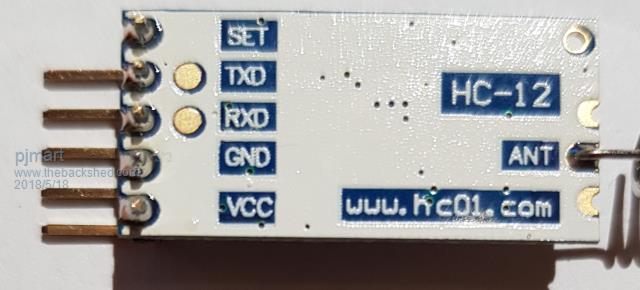

Can you please look on your ones marked with 30.000MHZ and the thick silkscreen, and see if the Vcc pad is square on the top, but ROUND on the bottom? Genuine seems to do it this way, clones have a square pad top and bottom for Vcc - as well as the thin silkscreen.
As the RF chip can be tweaked to suit the crystal in use, hc01.com COULD still use the out-of-spec crystals, provided they tweaked the registers in the RF chip. They may have done just that. The cloners will not have, which is why a direct copy of the original does not work correctly with the out-of-spec crystals the cloners used.
Base on your post, I will stop paying as much attention to the crystal from now on, and just concentrate on the thick white silkscreen as being more likely genuine, and if you have a milky see-through silkscreen, they are likely clones.

The Vcc pads are certainly rounded on the underside and the topside is now obscured by the header. I did look before attaching the header and think that the top pad was rounded although cannot be 100% sure.
Have attached photos.
