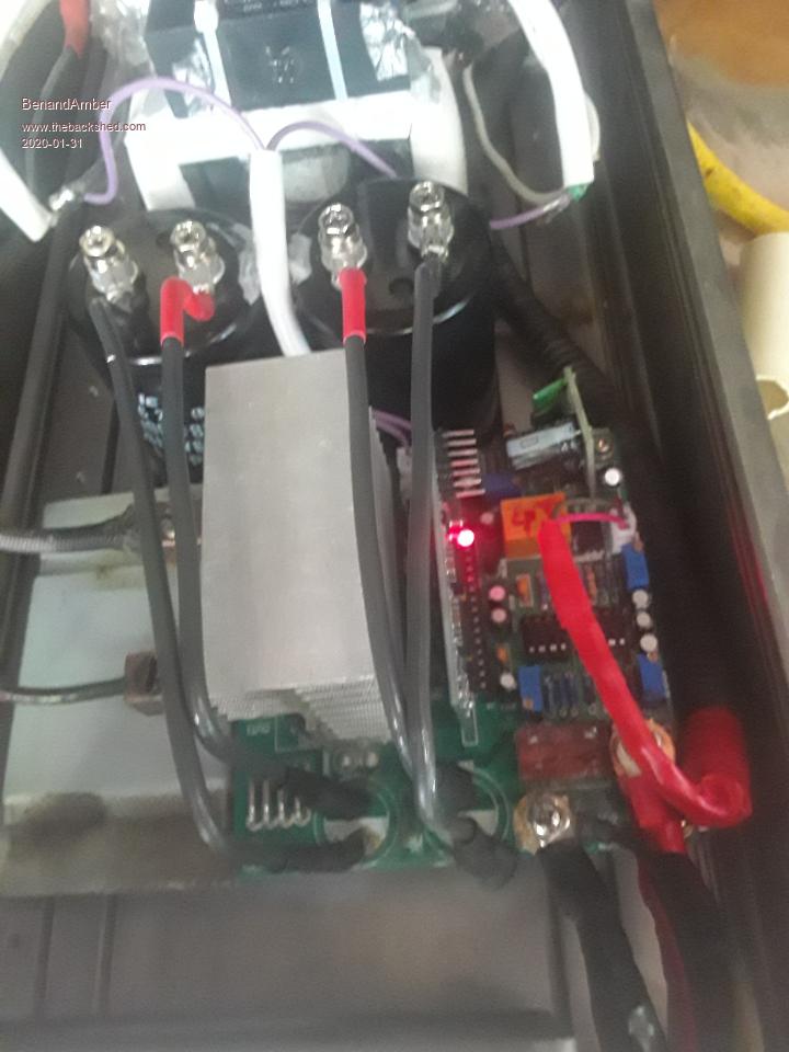

I have the 10000 what China board pretty much finished
I'm just waiting on a 48 volt fan to come in
I've decided not to use the 12 volt fan Outlet on the board
I've kind of chickened out on it it has a little jumper over by the 48 volt step down
I contacted the company I got it off of
they said it was just for testing purposes
it looks just like it was made to change the input voltage to me
And I'm afraid the jumper maybe set in the wrong position for the wrong voltage
The little ones cheap I don't care to blow it up
But I have a lot of money in this big one
Somebody needs to give me a hard time so I can get that final push if it blows it blowsEdited by BenandAmber 2019-05-30

Update
The little China board inverter is doing great
I gave it to my dad to use as a backup when his electric goes off
I plan on eventually building another one and using higher amperage mosfets
If anyone has any suggestions on what mosfets I should use please feel free to comment

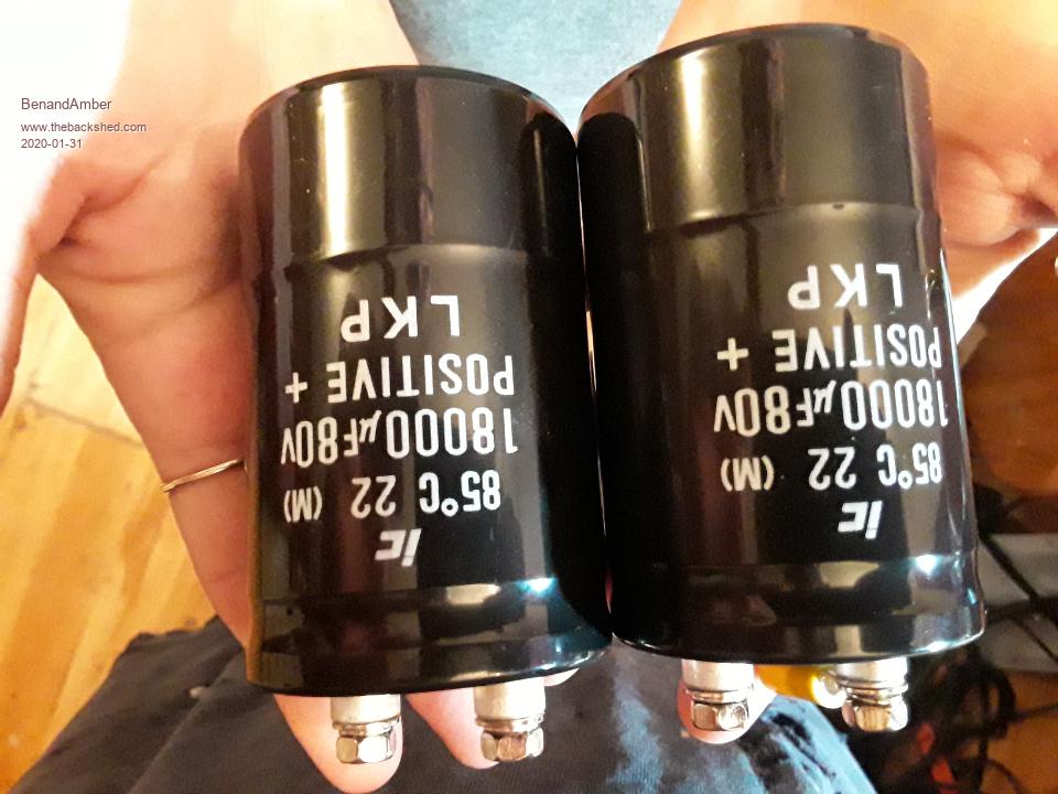

These are the caps I used in it
noneyabussiness
Joined: 31/07/2017
Posts: 527
Posted: 10:20pm 30 Jan 2020
Those hy5608's seem to be on the money..
I think it works !!

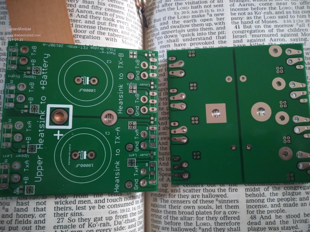

Posted: 08:23pm 22 Jan 2021
It took me a long time to get to these
Most definitely worth the wait
They are very well thought out right down to the price
These amazing little boards are 5 bucks for 10 of them
Thanks mack!!

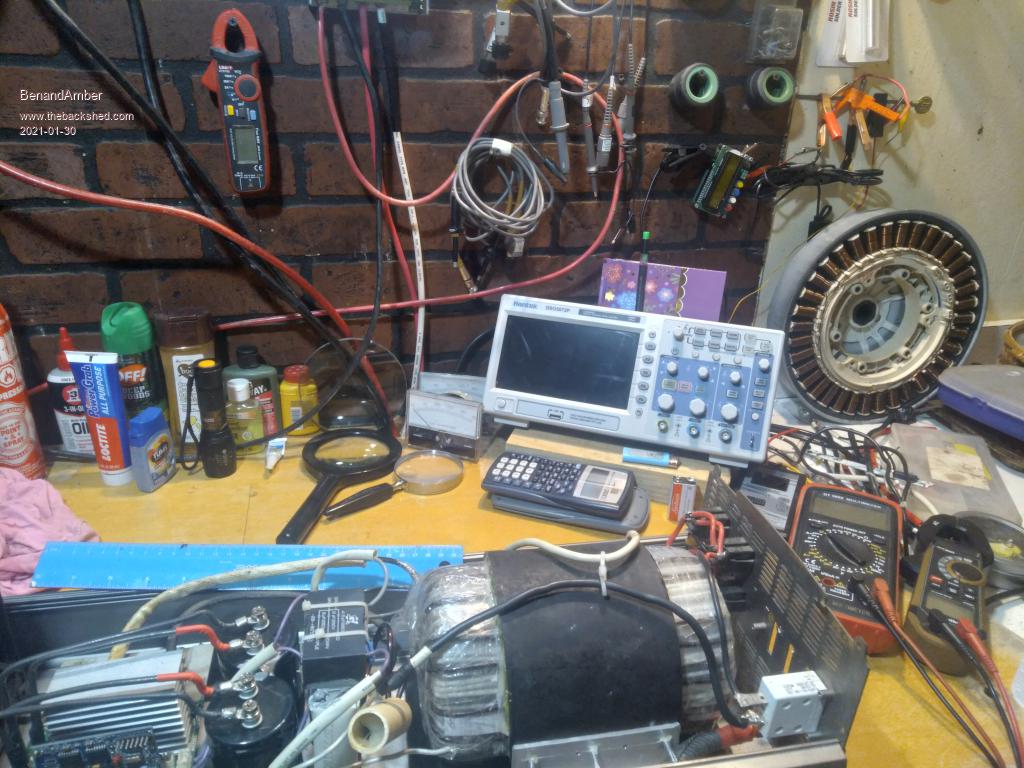

I got as far as taking the top off of the little 4 mosfet china board inverter
It works so well as is
That and freezing cold made me give it a few days to think a little more about it
The pic shows the scope sid gave me along with the awesome little inverter
