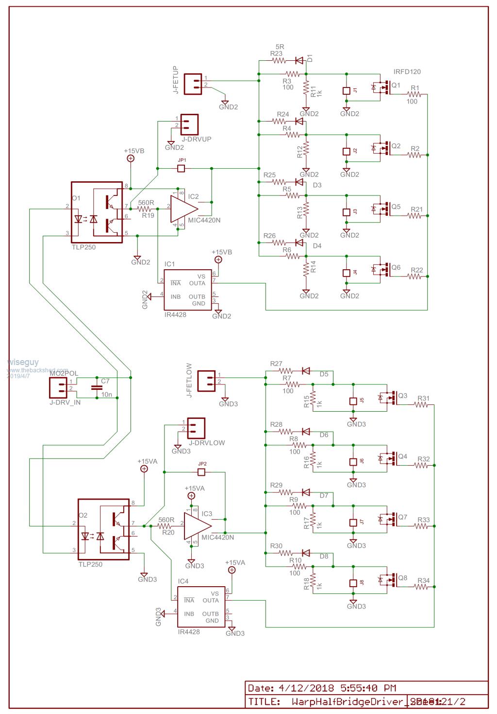

Tony, I have been perusing your schematics for the half bridge driver. What is the main purpose of the IRFD120's - is it to hold the Fets off strongly during power up and when not being driven? I assume JP1 is bridged when driving non paralleled FETs?
The JDRV connectors are for the large iGBT's ?
What is the purpose of the 560R into the MIC4420 - Im sure its not there as a decoration, but its not immediately obvious - is it just a small delay?.
I am considering doing a FET layout but Im kind of doing a peer review. I have some ideas I would like to bounce off you about maybe using digital output optos (2 in 1 8 pin Dip) and alternative isolated 12V supplies for simplicity and cost down. I imagine you frowning at this as it currently works - I would like to keep it that way too!
Another question - if the opto plug was removed during operation, would it be better to open circuit the transformer as it appears to be now or to short it out by default ie drive the two lower FETs on?
If you have described this circuit already can you give me a link? Edited by wiseguy 2019-04-08
Cheers Mike

  wiseguy said   Tony, I have been perusing your schematics for the half bridge driver. What is the main purpose of the IRFD120's
That is not one of my circuits you are looking at?

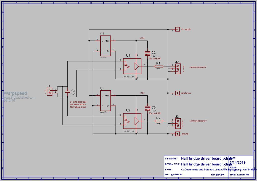

Here is the schematic of my half bridge board.

I'm glad you posted that circuit - it doesnt get much simpler.
I was looking at this, labelled as "Warp half bridge driver"
It was in my Warpinverter folder.... - sorry - maybe came from Andrew ! Edited by wiseguy 2019-04-08

One question though still remains - if the opto plug was removed during operation, would it be better to open circuit the transformer as it appears to be now or to short it out by default ie drive the two lower FETs on? Assuming it can be done simply.
Cheers Mike
Posted: 03:06am 07 Apr 2019
I have actually swapped around opto plugs with the inverter running, no problem at all.
If an opto plug is pulled out, both upper and lower mosfets (on one side) both lose drive and both just turn off safely.
The desirable condition of having a continuous conduction path through the transformer primaries at all times, only applies if you are trying to generate a correct low distortion sine wave.
If any inverter, or any inverter half stops working, the inverter output waveform becomes badly distorted, but its not a destructive condition.
Edited by Warpspeed 2019-04-08

Posted: 03:10am 07 Apr 2019
I was picturing the inverter driving a large load, the transformer/bridge that stops working due to the opto drive stopping - then the whole inverter output voltage that is left (3 stages) effectively driving the open circuited transformer and other side bridge ? Of course the worst effect is on the lowest voltage stage - Do I need to draw a diagram or can you follow my ramblings ? Edited by wiseguy 2019-04-08
Cheers Mike
Posted: 03:53am 07 Apr 2019
I understand what you are saying, and that too is not a problem.
The non driven inverter (or inverter half) still has the mosfets and their inverse drain source diodes connected.
The now non driven transformer primary tries to "thrash around" but is constrained between ground and the positive supply rail. Its not a harmful condition.
All that happens is the inverter output sine wave has chunks missing out of it, depending on which inverter has decided to stop working. It can still drive a load, even a very big load, but the voltage will be reduced and the inverter output waveform distorted.
The whole inverter is very benign, very fault tolerant, and very difficult to kill.
If it does stop working, there is a pretty good chance a fault will be only in one isolated part that can quickly and easily be replaced or repaired.
Its not like a PWM inverter that is either working properly, or there is total devastation.Edited by Warpspeed 2019-04-08

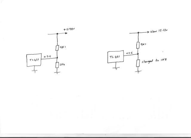

  Warpspeed said
The circuit component values are all pretty much standard, and there is a voltage divider connected directly across the dc output pins which consists of a 9K1 and 2K4 on the 12v devices.
If the 2K4 is replaced with a 1K8 the output voltage increases to typically 15.1v.
Altronics have the 1K8 surface mount resistors in packs of five.
Question, does this mod work the other way, like reducing the output voltage?
I bought some 24V modules because they were very narrow which is what I was after.
Tracing the circuit at the output shows its quite similar but with different resistors.
R6 =1K, the one above (to the + rail) = 8K6.
I tried a smaller value, 5K1 instead of 8K6 but the output voltage went up.
Then I tried changing R6 but somehow managed to blow the module.
Anybody know if altering the feedback to the THX208 chip would work?
The other problem is this particular module does not start up below 50V DC input, could that be improved as well?
Otherwise I'll have to go hunting ebay again for the 12V version of this particular size module and try to boost the output voltage.

Klaus when I first started this answer I had not been able to find a data sheet, however I have since found one. Before commenting further can you confirm if the circuit looks anything like the attached data sheet on page 11 Here
Dont bother with the parts list in the datasheet as they are for a 5V output.
If you traced the whole circuit and it is different please post it and we might be able to help further in setting voltage and lowering startup voltage.Edited by wiseguy 2019-04-11

Klaus, there are a few things to bear in mind.
These little power supplies must be made by the millions for standard wall pack plastic moldings for all the various shapes and sizes of mains plug used around the world. The only thing that has become pretty standard is the physical size.
The basic circuit is similar too, but not always exactly the same. So when you reorder, the second batch might be completely different.
The basic topology is a flyback supply, with two separate secondary windings on the transformer.
One winding supplies internal power for the chip, and the main secondary supplies the main output load.
When you cheat by modifying the feedback resistors, this will directly effect the dc voltage the chip has available to run on. Boosting up the output voltage from 12v to 15v will have a similar effect on the dc voltage supplying the chip. Not sure what that voltage actually is, but its going to increase by 25% which is very likely quite safe.
If we go the other way and reduce the output voltage from 24v down to 15v the dc supply to the chip falls to only 62% of what its supposed to be, that may be o/k I really do not know.
Its worth a try I suppose.
How about experimentally reducing the voltage from 24v down to 12v (or less) and see if that works reliably. If it does, than its going to work fine set to 15v

  wiseguy said   Klaus when I first started this answer I had not been able to find a data sheet, however I have since found one. Before commenting further can you confirm if the circuit looks anything like the attached data sheet on page 11 Here
Thanks wiseguy, but that link does not work here (not found message).
I have only traced the output side so far but may yet tackle the input side.
Anyway, what I found most annoying, and this will affect all the 48V version warpinverter builders, is the startup voltage is too close to 50V DC for comfort. I know, warpspeed uses 100V so it does not affect his inverter but for the 48V crowd it will have to be sorted so these modules start up from above 40V DC reliably into a load - every time.
Now, you being the resident expert on switch mode power supplies , what would be the effect of increasing the input capacitor?
My modules use a 4u7/400V electrolytic here. I could fit a 330u/63V of similar size instead. Don't have on at hand to try, unfortunately.
I might try to decrease the 24V output to 18V, the HY4008 gates should handle that (abs. max is 25V).
The other solution is to order the style module you mentioned in 12V version, they are cheap enough at about $A 1.- each. I actually like them better as they are quite a bit smaller too, I wish you had mentioned them earlier .
