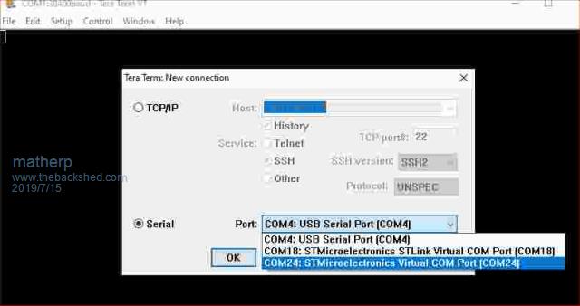

Posts: 6272
Posted: 06:56am 15 Jul 2019
Finally my STM32F407evp6 board arrived with the LCD.
Flashing worked fine, thanks for the detailed description.
Problem: It was not recognized by Windows through USB.
Tried re-flashing it 3 times. No luck.
Tried waiting minutes and reconnecting. No luck.
Googled around for this problem.
Found a hint about removing R21, tried that, no luck.
And something about clocks not on the right frequency. Have no idea how to influence that in a boot loader.
Will go look for a serial interface. May have a 1455 somewhere.
Otherwise this board becomes a brick in the dust bin.
Posts: 6272
Posted: 09:41am 15 Jul 2019
@matherp,
Have you used this info to create the MMbasic software for the F4? Maybe it has something that could lead to a solution for the USB not found ….
https://blog.brichacek.net/wp-content/uploads/2015/10/STM32F4-and-USB.pdf
Posts: 12244
Posted: 12:03pm 15 Jul 2019
The code uses the standard STM supplied libraries and I can promise it works fine. What version of Windows are you using? STM provide a driver for versions other than W10 which doesn't need one.
Given that you programmed the board (presumably over USB?) we know the clocks etc are fine and the wiring is OK on your board.
Posts: 6272
Posted: 01:12pm 15 Jul 2019
Hi matherp,
Using W10. So that shouldn't be the cause. As far as I can interpret the W10 popup it doesn't get the ID's when USB is plugged int. And there is a popup that the device had an error "last time it was connected". As if that applies to the programming itself. But the programmer reported success.
As instructed, I closed the programming software.
Now I think of it..
But I did not do a "safe removal".... Maybe that is essential. Not sure.
After the success in programming and verification I closed the Cube programmer, and pulled the USB.
I will try the safe disconnect tonight.
Posts: 12244
Posted: 01:22pm 15 Jul 2019
Also worth trying a good quality cable if you are using the one supplied and, of course, do the programming with the screen disconnected.Edited by matherp 2019-07-16
Posts: 6272
Posted: 05:46pm 15 Jul 2019
@matherp / lizby,
Tried a bit more with the F4 board, but could not get it to work.
Output in device manager:
Device USB\VID_0000&PID_0002\5&aea7634&0&1 was not migrated due to partial or ambiguous match.
Last Device Instance Id: USB\VID_04D8&PID_FA8D\5&aea7634&0&1
Seems like when changing the bt0/bt1 bits it starts as a different device (VID/PID), but still has the same ID. Maybe clearing the registry is needed to get it recognised.
Edited by Volhout 2019-07-17
Posts: 12244
Posted: 06:02pm 15 Jul 2019
Serial port I get USB\VID_0483&PID_5740
DFU bootloader device I get USB\VID_0483&PID_DF11
Always worth trying a different USB port for the different modes of use.
Are you using a laptop? USB power issue?
Edited by matherp 2019-07-17
Posts: 3888
Posted: 06:14pm 15 Jul 2019
Sorry to hear about your problems. After some initial difficulties with the first F4 I tried, I've now got 6 of them working--some with the original cables and some with new.
I have no idea why it didn't work at first but then did (original flashing of MMBasic with the STM32CubeProgrammer worked every time).
Hate to ask, but you're sure you have the jumper positions changed from those for flashing to those for MMBasic programming as shown in the first post of this thread?
On Win7 laptops, I had to install a driver, but not for Win10.
You might try flashing the version with OPTION SERIAL built in (on page 4 of this thread). Then you could see if you can connect to console via usb/serial to COM1. That won't be the best long-term solution, though--you probably couldn't expect updates.
Wish I could offer more concrete advice. Good luck.
