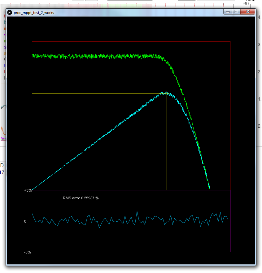

here is a video of the mppt tracking, running the program contained in the zip file above
I change the knee position of the current curve, which of course alters the location of the power peak.
It works nicely. With less noise it finds the peak faster.

0.6% RMS tracking error. Not too bad with this amount of noise.
proc_mppt_test_2_works.zip

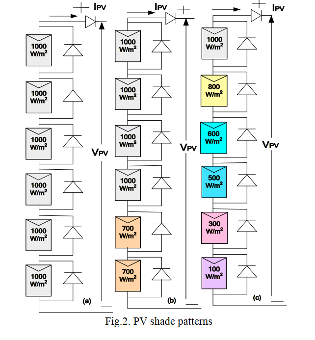

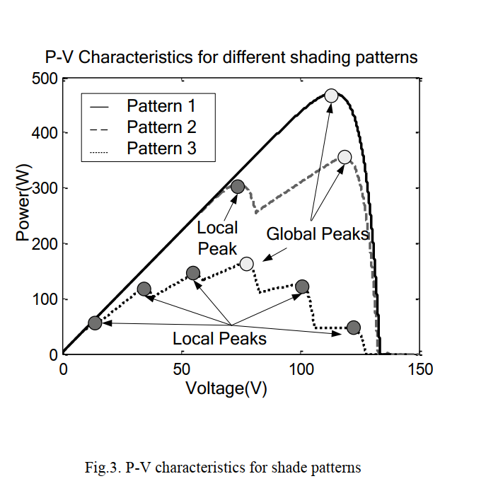

The reason I will incorporate the periodic max. power scan is due to shading of parts of an array can cause multiple power peaks. My MPPT code will not find always the maximum peak among a few, it will just track to the top of the first one it sees.
the paper from here shows some potential situations.
and here are the P-V curves for the above 3 examples

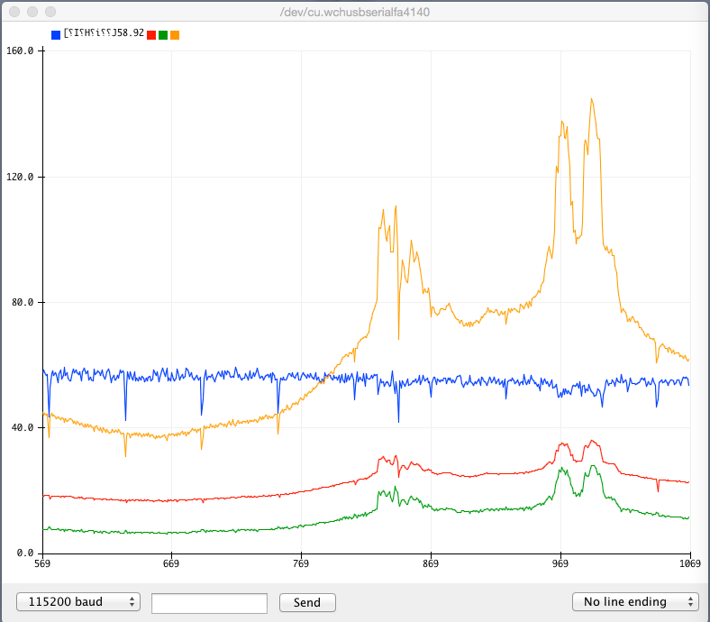

Below is a graph of a certain time this morning when the sun nearly broke through.
Peak power was about 1500W.
Power INPUT is Orange, divided by 10
Blue is Volts IN
Red is Amps OUT
Green is Amps IN
The x axis is 500 points wide, 1 second per point.
You can see a periodic short dip in output power. This is when the max power scan occurs. It is satisfying to see that after max power is determined, it is quite close to the power that was tracked just prior to the scan. It means the MPPT tracking is working well.
The bucket of water (that holds the 1 Ohm load resistor) has nearly come to the boil
https://youtu.be/H2wleS350hA

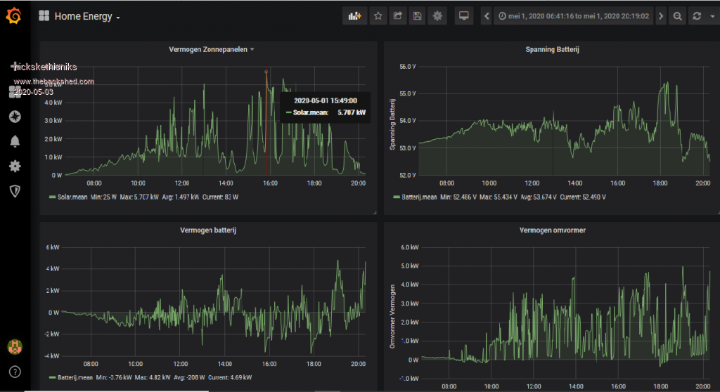

I use an Re-1215, it should be one voltage, 12V is enough, even 10V will do. I have a s*load of certain components that are not allways the right fit, but it should safe me money, not allways. Btw, it has the same footprint then for example a recom R05B15 and it has - an +15V outputs. So you guys had a bad day huhm? I made a record with that powerpcb yesterday:
I don't consume that much energy btw, but I activate a heating element in my heat storage tank (3kW) as soon the battery voltage is 54V. The heat is used to warm the bathroom and the small office of my wife, they both have floorheating.
So 5700W! that's more then 100Amps pumping in the battery (load)!
(btw there is a small gridtie inverter coupled to the ozz inverter)
