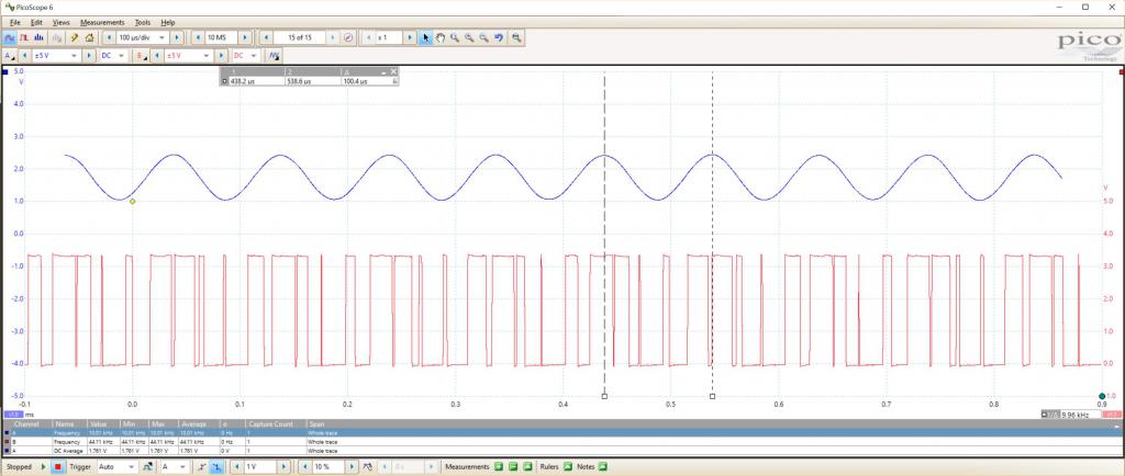

Attached is the output of my scope of a 10KHz waveform (PLAY TONE 10000,10000). The bottom trace is the actual pwm output. The top trace is the same data passed through a digital filter with a 5KHz knee.
Inspection of the bottom trace shows that there are no "odd" pulses and the filtered output appears perfect.
I have made one tiny change to the priority of the audio interrupt in b13 but since I couldn't demonstrate any issue in earlier versions I can't see if this has had any effect

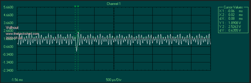

I am not sure if it van be found with your setup. Your low pass filter may hide the artefacts because the rolloff at 5k(*) and I had to use deep memory at the scope to make it visible (at 10khz you may need 10000 cycles before you capture one).
If it really is the wrap around interrupt, feed it to a gpio pin, put the scope in persistent mode, you can see if it is stable, and always equally wide pulse width.

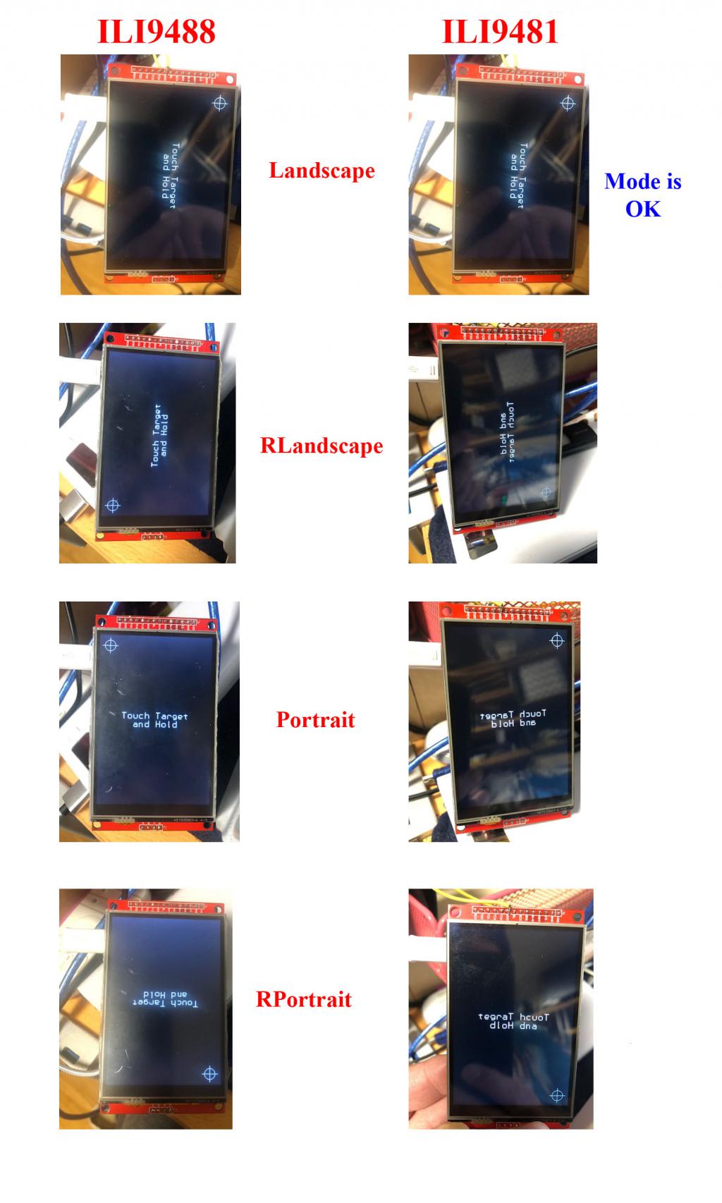

Hi Peter, All,
  matherp said  Mick
Can you try all 4 orientations and let me know which are correct and which not - thanks
This was very hard to describe so I have compiled pictures, ALL photos are taken with the display in the same physical orientation as can be seen by the white USB lead on the top left of each image.
I will leave it to you to work out what needs to change

Thanks for the pics - looks like they have wired this display different from the normal ILI9481. It will take multiple iterations to get right. Are you around for lots of trial and error?

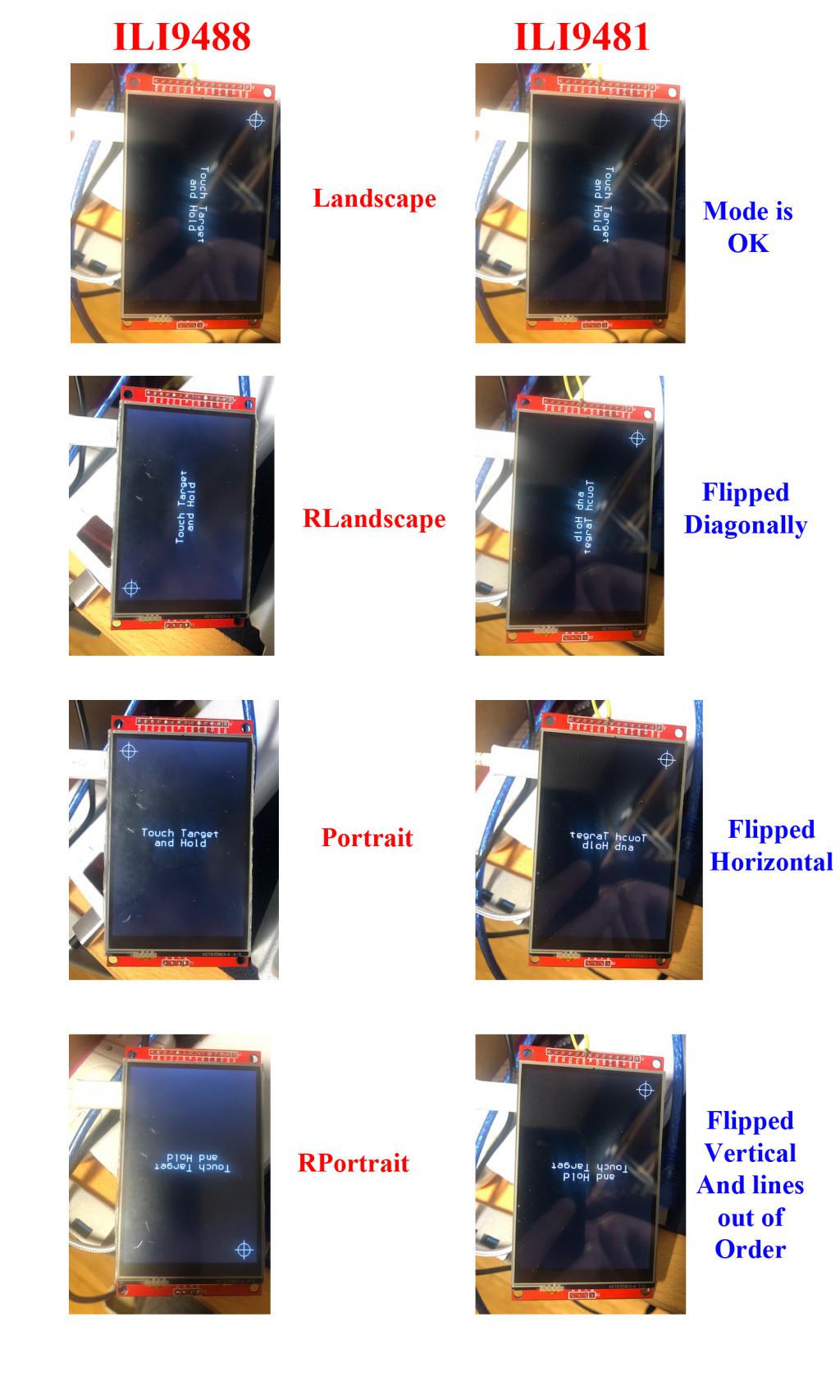

Hi Peter, All,
Same same but different. There are changes from earlier but the 3 modes are still incorrect
It is interesting that in PORTRAIT mode the Target is in the same place as previously but the Text is chr by chr flipped horizontally.
Kind Regards,

AFAIK the PWM runs stand alone and only the capture/compare register is updated with sine samples. Is this a DMA thing ? Or is the ARM putting new values in (under interrupt?).
Anyway, when the compare register is updated at the wrong moment you may get a whole 44kHz cycle that is faulty. But this would happen far more frequent I guess.
Anyway, the faults in the audio happen at "random" moments, but sometimes they happen around the peaks of the sine wave, leading to a higher peak value. When the sine wave is 3.3Vpp, the level cannot get any higher, but if you use a higher frequency, the filter rolloff will attenuate the sine wave to a lower level, and the peak can be used to trigger the scope.
But you need a hardware filter to change the PWM to a sine wave.

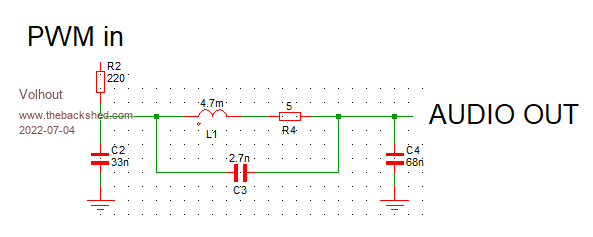

So what I do is:
PLAY TONE 16000,16000
With my current test filter, this gives a 1.5Vpp sine wave (with intermodulation). Then I trigger the scope at 0Vdc and adjust the trigger upward until (single shot) I get a trigger. You can clearly see the fault.
This is the filter I currently use (these components where in my bin)
These "glitches" occur also at the high side.
Why am I using this method, of a frequency in the rolloff of the filter ?
Let's assume the values put into the PWM are the correct values. But they are simply delayed for some cause. The delay causes the frequency (temporary) to be lower, and lower frequencies are not attenuated that much, so they lead to higher levels. And levels you can trigger easily on a scope.
If you look at the markers in the oscilloscope picture, you see that these are 0.08ms appart. This means that in the 16kHz (62us) since wave there is one 12kHz (80us) cycle. So there is an 18us delay in the update of (one of the ? ) values of the sine wave.
Edit: the 18us is close enough to 22us, the cycle time of the PWM. Maybe the new value misses the pwm update slot, and the previos value is repeated once more, before, in the next slot the new value is used. Pwm updates are most likely hardware synchronized with the wrap around of the counter in the pwm.
