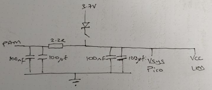

  Turbo46 said  Hi Tom, this is the best I can come up with for now. My ability to draw a proper schematic is limited for now.
Looks "proper" enough to me.
  Turbo46 said  The transistor will be switching from a relatively quiet supply unlike the 'noisy' Pico supply so the resultant PWM should be relatively noise free.
This I don't "get". Running on battery, everything except the controller circuit (pin 36, 3V3) has exactly the same supply, the battery via the schotky diode (SW10), power switch (SW10) and decoupling capacitors ultimately connected to the Pico (pin39, VSYS), LCD and amplifier.
  Turbo46 said  Try whatever speaker you like, the sound quality and volume may vary but it is not the source on any noise. That's another side track you can go down later.
OK, but like supplying the amplifier from a completely independent supply it is easy to do and potentially educational.

Hi Tom, Mick,
I would power the pico from it's switching regulator, not from a linear regulator. The onboard switcher can handle power, peripherals, wide range battery voltages.
I would power the audio amplifier (PAM8403) directly from the LiPo (3.7V). It is designed for single cell (3.7V) use.
To limit the noise in the audio (caused by the onboard switching regulator) we need to add something like Turbo is working on with the diodes or LED's. This is the part that needs some engineering. The solution with the transistor is nice, but many more components (since it needs a quiet 3.3V, e-caps, etc) where diodes/LED's do not.

  Quote  This I don't "get". Running on battery, everything except the controller circuit (pin 36, 3V3) has exactly the same supply, the battery via the schotky diode (SW10), power switch (SW10) and decoupling capacitors ultimately connected to the Pico (pin39, VSYS), LCD and amplifier.
The resistor and the two capacitors will filter or decouple the supply and hopefully remove most of the noise produced by the Pico. so switching on that supply using the transistor should produce a PWM signal that has none or very little noise superimposed on it.
The electrolytic will remove most of the lower frequency noise while the 0.1uF will cope with the higher frequencies. Standard electrolytics have an effective series resistance (ESR) which does limit their high frequency response (tantalims are better).
Not sure if that answers what you don't get.

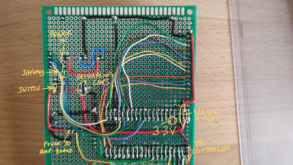

I don't imagine this will help, but can't hurt:
I note now that the + line to the "amp board" is coming directly off the switch, not after the decoupling capacitors, but there is another pair of decoupling capacitors on the "amp board".

Posts: 1694
Posted: 11:56am 31 Mar 2023
  Quote  I note now that the + line to the "amp board" is coming directly off the switch, not after the decoupling capacitors,
Hang on a minute. You said earlier that the 10R in series with the amplifier was causing problems. If that was in series with the amp why weren't the capacitors in the circuit.

  Turbo46 said  You said earlier that the 10R in series with the amplifier was causing problems. If that was in series with the amp why weren't the capacitors in the circuit.
EDIT: I think this was me failing to distinguish arse from elbow, this is what it looks like flattened out:
The amp board (infact the whole audio train) is a breakout that amongst other things includes the (now 2.2R) resistor another pair of decoupling caps and the PAM module.
One of the things I got right with this build is I didn't solder any audio to the main board, instead there is a 4 pin header taking power, earth and two sound channels.

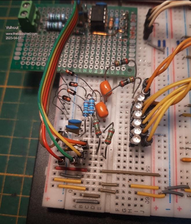

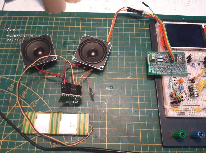

The small speaker will most likely not give you the performance you desire. Minimally you will have to give them an acoustic chamber in some form. I achieved significan improvement by placing my small speakers in a toilet paper carton tube. But I assume your handheld game housing could also work as such, as long as it is more or less a closed system.
The circuit itself is not very critical if you only want computer sounds up to few kHz.
This is my setup without the carton tubes (they are visible at the top edge of the photo. Bottom: the 1S LiPo (3.7V), the PAM8403 with (not visible) volume control. The 2 speakers (1.8"), to the right my breadboard PicomIte.
In my setup I have used the picomite switchmode powersupply, and that generates quite a lot of noise and buzz. I have minimized the buzzing by clipping the PWM signal in a diode clipper. For those who wonder why double diodes and AC coupling. Using a single diode of LED gave huge non-linearity.
With the little speakers the sound was so-so (missing all low frequencies). But with a decent speaker... the Dires Straits where very enjoyable (despite the 5kHz rollo-off of this filter). I use the Dire Straits live album because it has so much dynamics, from very silent and mellow sounds, up to roaring guitar.

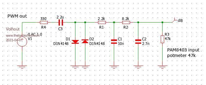

This is the filter I used (1 per channel L and R). I guess, the diodes and the 330 ohm resistor and 2.2uF capacitor can be removed, when you use a linear regulator for the picomite power.
It should be more than adequate for the game sounds, and has 30dB rejection at 44kHz with NO INDUCTORS...
The filter can be made in SMD, so it will only be sugar cube size PCB (for stereo).
But honestly...Tom... the essence is in the small speakers, and how to get them accousic best coupled to the user. The PAM8403 is amazing, how much sound you get from a single lipo when using a decent speaker...
P.S. for those who notice the constant noise when volume is turned up high: this is becuase the audio output of the PicoMite is only 10 bits. Now adays people are used to 16dB or more audio DAC's and a -90...-100dB noise floor. In this picomite we only have -55dB.

Thanks Tom, your hand drawn schematic is how I think the circuit should be. If there are more bypassing capacitors on the PAM then you can't have too much.....

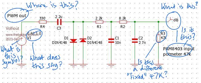

Posts: 3413
Posted: 11:53pm 31 Mar 2023
The heartbeat LED can be disabled but it is just highlighting the problem. As it switches on and off it is loading / unloading the regulator so its noise is changing.
OPTION HEARTBEAT OFF  will make it less obvious.
In Toms annotated circuit:-
Where is this? = PWM out = Pico audio out pin
What does this say? = DAC01 = digital to analogue converter 1
What is this symbol? = signal source
(above three are all the same thing)
Is this a "different" 47k? = no it is the PAM8403 input potentiometer.
What it this? = dB = measurement point (in decibells) for the circuit simulator - not part of the circuit
Is it this? = no
