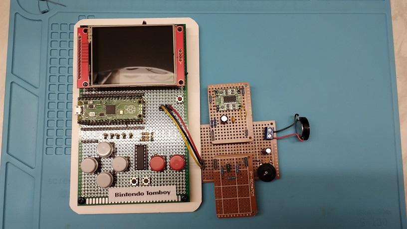

Hi Volhout,
"More electronics than an off-the-shelf-chinese cicruit":
... and not yet good enough.
Now I acknowledge that I need to double-check my work, and that this isn't using your inductor filter (I did construct that on a solderless breadboard but it didn't seem any better - probably my mistake)
The suggestion seems to be that the problem (if I am foolhardy enough to exclude user error) is upstream with the power-supply ... more investigation required.

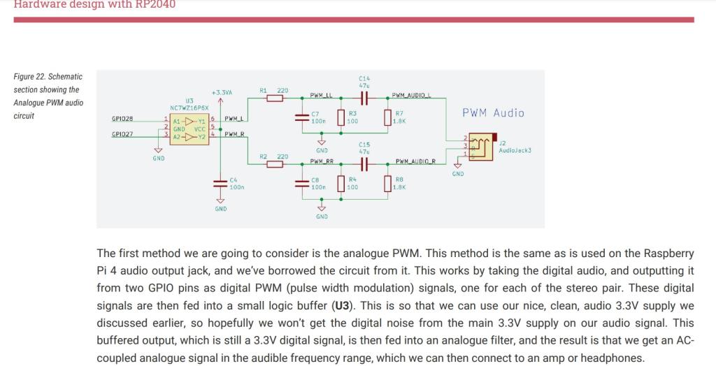

saw this circuit
Posts: 5072
Posted: 07:15pm 24 Mar 2023
@Eejit,
It is very friendly of you to help us find a solution for Tom, but not every pi is the same pi.
The Pi4 uses PWM output at 192kHz.
If you want 20Hz...20kHz, the Pi4 has to reject 192kHz (around 10x the highest frequency 20kHz).
That can be done with simple RC filter as shown in above schematics.
The PicoMite runs PWM at 44kHz (2.2x the highest frequency). Using the Pi4 audio filter will not reject much of the 44kHz PWM frequency. You need a better filter.
It does not harm trying, but you will end up with a lot of 44kHz (inaudible that is) and digital amplifiers (class D) will distort heavily, and cats will avoid your picomite....

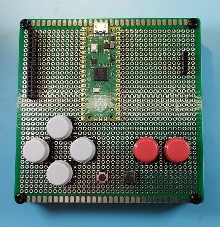

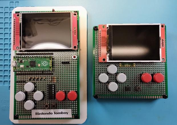

Hi folks,
Whilst the brain trust are thinking about the audio I thought I'd have some light relief and start figuring out the layout of the Mk2 prototype.
Here it is with its older brother:
And here it is with its top off:
1. The area to the right of the Pico is for the audio circuitry, the speaker can go underneath.
2. The area to the left of the Pico is for the LiPo charger module.
3. The Pico is not flush mounted but sitting ontop of a set of male header pins that raise it sufficiently that the USB can still be attached, it's still just low enough that the USB cable doesn't get entangled in the SD card under the display - though I'm half inclined to desolder that and bodge a micro-SD reader in its place.
4. I haven't decided whether I'm going to include the shift-register or just wire the buttons via resistors to 8 GPIO pins. I need to decide how to allocate the GPIO and I want to keep pins for an I2C channel and a serial channel free.
