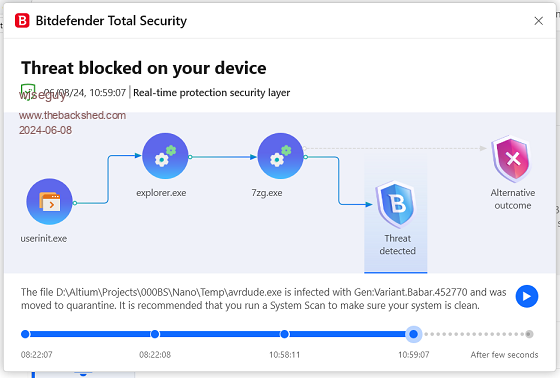

wiseguy
Joined: 21/06/2018
Posts: 1338
Posted: 01:34am 08 Jun 2024
I finally figured out the real program name and downloaded and installed it.
The first message I got was from Bitdefender the screen shot is below.
I don't really fee comfortable to continue with it, what is your opinion ?
Edited 2024-06-08 11:36 by wiseguy

KeepIS
Joined: 13/10/2014
Posts: 2290
Posted: 02:15am 08 Jun 2024
This is the correct github address - Bitdefender and others are know for false reporting.
AVRDUDESS
Click on big GREEN code button and download ZIP - no problems here and I just downloaded it.
