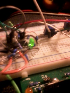

ok found anothewr chip will ressurect the cct asap but having a little break atm also could you tell me the purpose of "R9" please... Edited by sparkey 2011-11-14
sparkey
Joined: 15/06/2011
Posts: 819
Posted: 04:58am 13 Nov 2011

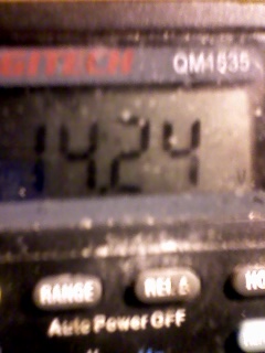

houston we have lift off i may need to run the "cal-b" again but it seems to be throwing the relay at arond 14.2/3...Edited by sparkey 2011-11-14

ok here ya go the led and relay at engaguedged mode

this is the drop out voltage on the down slope that the relay cuts out it is cutting in at about 14.2 volts this may be a little high not shure though and i dont have a load to test it on as i only have adjustable supply to test on my gen is rated much higher dont use twelve volt gear....

like the 4000 series chips they would have to be the most finicky chips ever brought on the market i went through thre different manafactures before i got a 4013 flip flop that would work like it should ....piece of trivia there the relay cct is still working thoug since i got it going i found that the problem was not the chip in fact what i had done was run "r8" to pin 14 in stead of pin 13 once i did that fix everything dropped into place nice work on the mod there with the 339 i was nearly at a state that i was going to try use a "tl074 " in stead but the old 339 made the grade next i will be looking at the 317 mod ..i guess it all comes down to the divider network of the 47k and the 33k "r1/r2"

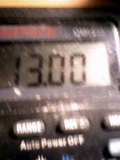

thanks for that ..len.... i actully have it latching in at 14.5 volts and on the down slope cut out at 13 volts so thats fine i guess ... now i guess its up to him now what he wants to do...yep just got the increment set and on my 50 dollar "dmm" its cutting in at 14.5 volts and on the down slope its unlatching at 13.0 volts given the fact that my meter is only 6 monts old i`d say that its within .05+ or minus of its value being close enough for me....Edited by sparkey 2011-11-15

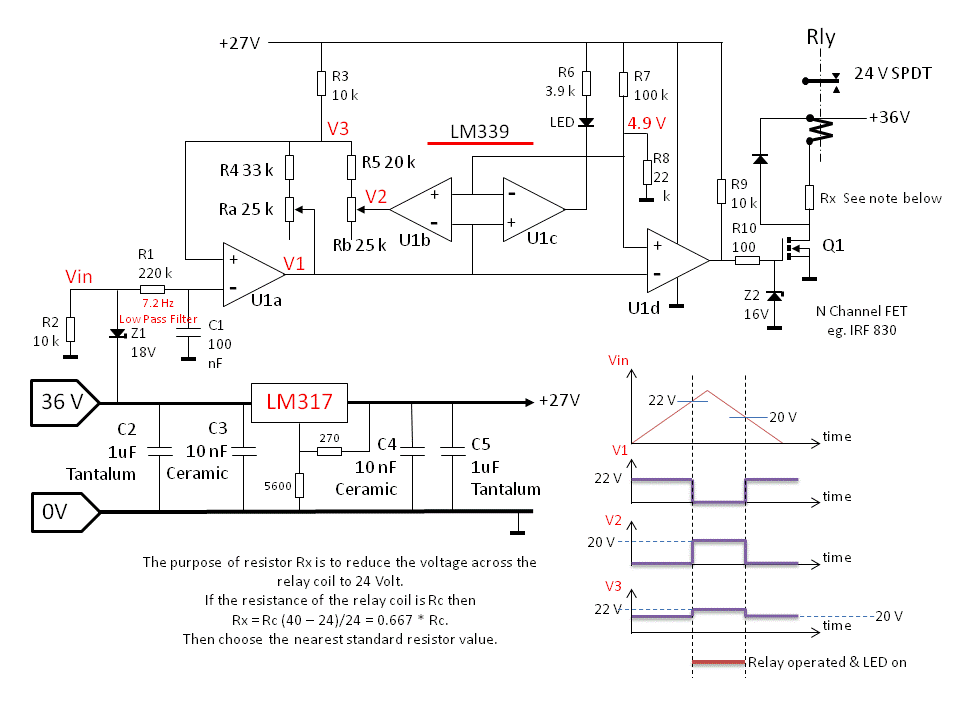

Here is the Circuit, Circuit Description & Calibration Procedure for 38 ~ 40 Volt version.
It is easy to re-calculate the resistor values if you need to change the levels.
Let me know if you want to avoid using a relay & drive the dummy load with a MOSFET.
Len

Sorry, I added the wrong Circuit Description & there were some errors in the Calibration Procedure.
So Here they are:-
2011-11-17_072019_Calibration_Procedure_36.pdf
2011-11-17_072100_Circuit_Description_36.pdf
Len
