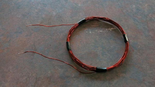

Part 9: Air core inductor possible or am I on drugs..
Air cored inductors can not saturate and so I wondered is it feasible to make one for our home brew inverters.
From the wikipedia inductor page for a short air core coil we have
L = (r2 x N2)/(9r + 10l) uH
where
N = turns
r = radius of coil (inches)
l = height or length of coil (inches)
So I had some 1mm diameter single core wire laying about.
I made a coil of about 4" diameter, 13 turns, and about 0.3" high
The LCR meter measures it at 27.4uH
The formula gives (2 x 2 x 13 x 13)/(9 x 2 + 10 x 0.3) = 32 uH
Close enough for me.
The resistance of this coil is 0.35 Ohms and that may be a problem when it’s passing primary winding currents for realistic loads.
It looks like this:

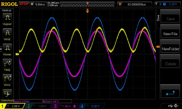

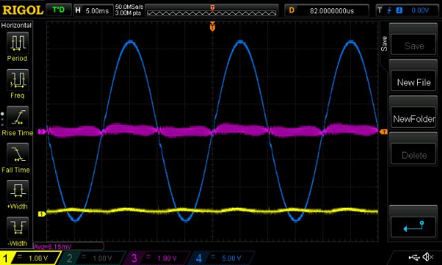

But it works fine, here are the two DSO captures at idle and under 440 W load.
idle
440W load
The coil gets hot very quickly and it no wonder why. (pink trace is primary current, 41mV/Amp scale, so 1.44V = 35A)
35 Amps RMS through 0.35 Ohms = 429 W
I want to make the same coil with much ticker wire, 13 T of 4” diameter coils means about 4 meters of cable. This wont cost too much.
I am thinking that maybe I don’t need anything other than an air core coil as the primary side choke. No more saturation worries!

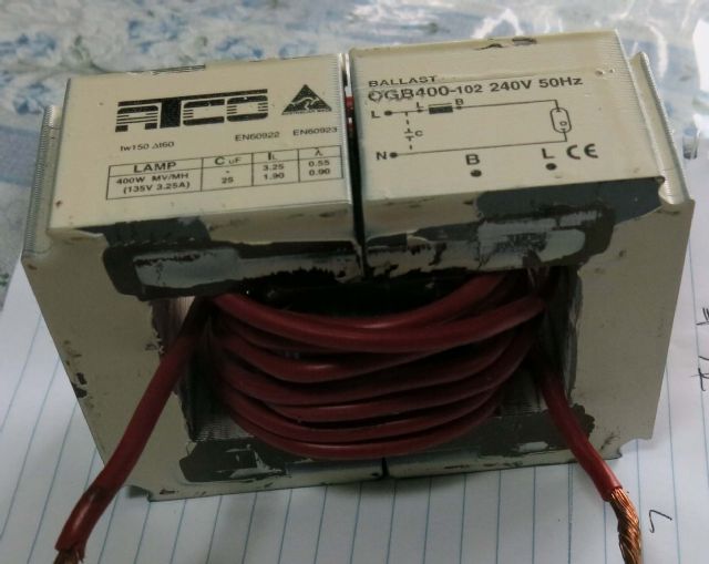

In the quest to find a cheap or zero cost choke I tried one of these
from a 400W bay light. I rewound it with 8 1/2 turns, giving 50uH.
here is the inductance test.
Conditions have changed. 17V supply, 10.2mV /5.5A = about 2mv/Amp
yellow is gate drive, purple is supply, light blue is current
It seems to be good for about 75A
The inverter power I am interested in is 700-1200W power levels with peak efficiency
