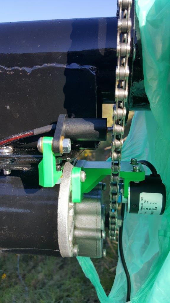

So, the motor for the Turret movement is installed, 9 tooth gear on the motor, 44 tooth sprocket on the base of the turret. 300 RPM motor, PWM'ed for a slower speed.
I have a gear tooth sensor which I am using as a home sensor, and I ended up going with the Encoder option, so have a quadrature encoder which outputs 2400 pulses per revolution, so overkill but working really well.
Have the controller just talking to everything today for the motor with some test logic, so I can manually adjust the position of the turret and move to specific positions based on the encoder output. Works great, but more stuff to add in there yet.
Before I installed it all on the mast, I bolted the motor and encoder and a dummy sprocket together and had the motor moving the sprocket to a set position based on the current wind direction. So if I move the sprocket with my hand, the motor would periodically return it back to the current direction of the wind, based on my wind sensor. That all worked really well and enabled me to get the logic right for that part. So in practice on the turret, it will do a similar thing. The encoder will keep track of the position, so if it does move a little with the wind or overshoots in movement etc, then it will correct itself periodically.
I have Auto and Manual modes on the controller, so in Auto it will follow the wind, and in Manual I can move it wherever I want. I am planning to be able to apply offsets if required, so I can play around with the heading and see how the power output changes. Stuff for me to learn with essentially.
I will be able to turn it out of the wind if the wind gets too strong, or offset it from the wind a bit etc, should be rather neat. I can also turn it into the park position, so I can lower the mast and put it in the maintenance position (where it is in the video below) so the blades are facing the sky. 1 man job to raise and lower it already, worked out really well.

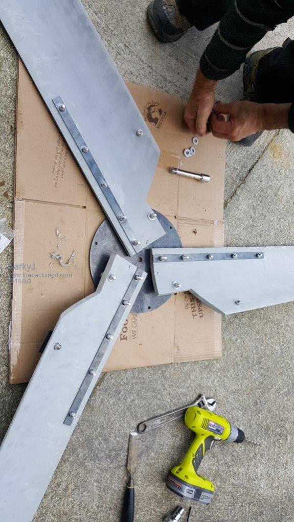

Blade wise, I got the blades bolted to the hub with their support braces, and I am pretty happy with how it all turned out. As a starting point, I just set the angle of attack to be the default where the blades wanted to sit, and I will experiment from there, by changing the angle by spacing out the leading edge. Once I have something I am happy with, ill smooth out the brackets a bit and possibly even fill things in, but this is a start just to see where we are at. I also balanced the blades by drilling a hole through the centre of a bolt, and hanging the whole assembly from the ceiling of the garage, having it hang about 100mm above the ground. I then put weights on blades and got it all sitting level. I was going to put a weight near the tip, but at this stage, I have put a large fishing lead on the hub itself. Looks ugly, but until I get things a bit more finalised, this works well, and things seem happy enough to try.

3D printed some solid brackets for the encoder and the Home sensor.

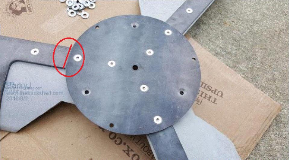

I havn't been on this site for a while, just having a quick look,its a nice looking build you have here,,, don't mean to put a dampner on things but after looking at your hub I have a concern that it is not going to be strong enough, too thin, not enough strength for that diameter blades,in high winds/rpm the blades are trying to move clockwise/anticlockwise,twisting/flexing forwards and backwards,,really doing there best to ripp themselves off the hub,and if the hubs too thin they will take a part of that with them when they leave..

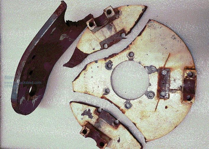

I would double up the stengthening of the whole hub and blade mount strutes ,If you don't then I would stay well away from it in high winds,,but thats just my opinion.Edited by flc1 2018-08-04
Boppa
Joined: 08/11/2016
Posts: 816
Posted: 12:07pm 03 Aug 2018
I tend to think it might be a bit light too- what thickness is it??
the Delco's had a 3/16 thick plate hub and they often bent the hub (thats 5mm near enough) with 75cm blades

Really?

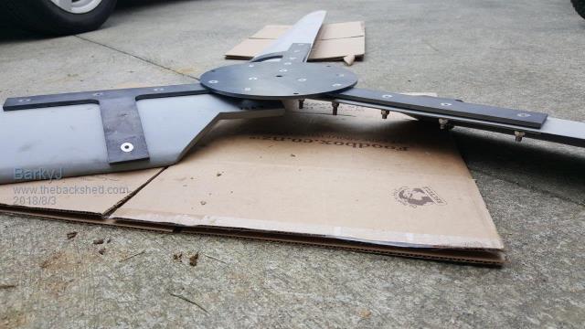

The plate in the picture is 1 of 2, both are 6mm thick and bolt together, the arms going out are also 6mm thick. The backing bracket on the other side of the blades are just 3mm thick but are basically just a glorified washer, and the blades are 16mm thick.Edited by BarkyJ 2018-08-05
Madness

Is it possible to put another round plate on the other side, that would give it a lot more strength?

As an armchair observer I too would suggest putting another disk on the windward side, perhaps similar than the rear disk plus similar steel brackets. So you end up having the blade sandwiched between equal strength brackets.
Also, turn the screws around so the smooth countersunk bit faces the wind.
Never under estimate the centrifugal force on your balancing weights, they *must not* move under any circumstances.
Do make a very good weather cover, with shaft seals etc unless you like to do a lot of maintenance. Something the birds do not like to sit on on windless days too.

The bolts are countersunk as the heads are between the two plates. There is another plate the same size as the one pictured which bolts to this one, and is what joins it to the generator. The main generator shaft goes through both plates also. I am likely to put a smaller plate on the windward side but I haven't got to that yet.

Hi Member everyone seem to worried about the thickness of the mild steel plate and its strength that barky is using on his project, so 6 mm steel place should be ok but if it was for i would better go for 4-5mm bisalloy 400 or 350 grade steel plate as they are much stronger and better for drilling holes which would need good quality drills bits as well

IMO" & sorry Dywer ... (long time no see ) 6mm is weak and at the point marked it will flex and eventually crack and break. How long is only dependant on your wind zone / blade length, balance turbulence . Thats my 2 cents worth but you look like you are doing it your way and looks like you have a good grip on electrics etc.
If you have another blade hub, sandwiching the ABS Blade with both hubs on the shaft is the easiest & strongest method. but then it comes back the ABS Plastic and its fairly flexible. I used it a long time back for my first blades , got real sick of picking up plastic shavings and it does not like staying straight making tip run-out impossible .
Just to show --Below is a 6mm hub torn apart and the clamps and tube added strength to then allow flexing at the next weakest point. Both of these failures are from the same place in the Strzlieki Ranges behind Melb which I would think is one of the most violent windiest locations in Aus . This particular location 40 - 50klm is just gentle & regularly + 70klm - 100klm gusting, the 12mm x 100mm mounting arm is bent like it red hot . On a previous fail, After shedding the blades and the tail it turned the F&P dual head into an anemometer and I can only imagine what rpm it got to before the abrupt stop.
Failure time here is accelerated x 10 compared to even high wind areas. On the up side ,The latest F&P Mk3 the Prototype has been flying there for a good 12mths and being the last F&P / LG design I will do . I will put some pics up in another thread when I get time.

Thanks Fillm,
That's a scary picture you posted there.
We don't get winds like that at all where I am, however fully taking what you (and others) have said on board.
The failure on your hub though seems to be at the end of where the blade would be, like its been levering at that line where the inner clamps have been.
Mine has the long plates running under the round hub to the point of the inner CSK bolts, which also has 16mm thick blades running up to that point, and then another thinner plate on the windward side. I'm looking at what I have and would be surprised if it manages to break through all that - but you guys are the experts, not me.
As mentioned, it is not just 1x 6mm round plate I have, it is 2 of them. But I have it like this so I can remove the whole blade assembly off the windmill, leaving the 2nd plate attached still which is attached to the generator.
I have always been contemplating adding a smaller plate on the windward side, which ties the blades together there, but I originally thought that was going to be overkill.
Anyway, tomorrow I am putting the blades on as is, just for a low wind test, we are only expecting like 6-20km/h winds, so nothing extreme at all, but I just want to get them on and see if it spins ok unloaded, and see if the controller is registering all the bits correctly, as its hard to simulate spinning motion while adjusting load - my drills just aren't up to more than about 30s of running.
I will be taking it down again the same day.Edited by BarkyJ 2018-08-08

I don't see this as an ultimate strength problem, but as a metal fatigue problem.
The hub is definitely going to see some very high cyclic stresses that very slightly flex it first in one direction, then in the opposite direction. Fine cracks may begin to appear at the surface at the highest stress points, usually where there are dramatic sudden changes in cross sectional area.
Corrosion in these fine cracks may add to your woes, as moisture wicks into the cracks and remains there.
Then one day in a fairly stiff breeze that it has already survived countless times it will unexpectedly fail, go out of balance, and then completely self destruct.
What you really need at the hub is very high stiffness, which material thickness alone will not usually provide.
Gussets, ribs, rolled edges or whatever to make the hub really stiff without being unnecessarily heavy should be the aim.

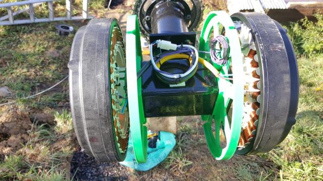

So the single 'old style' male-male shaft connects the two rotors together, and they are on the splines of the shaft, so locked in at both ends. The nacelle and bearing arrangement I have posted about already, determines the spacings and I designed it as such to utilise the correct parts of the shafts, so no cutting or welding of the shafts was needed at all. One end has the longer threaded male end, and this locks to the 2x 6mm plates I have. The other end basically has a flat waster on it and lock nut, and just stops the rotor 'coming off, that end, and pulls the rotor and bearings etc all nice and tight.
The first plate has 5x 10mm 'buffered' fingers which go through the peanut shaped openings on the rotor. There are 10 peanut openings on the black rotors, and I have 5 fingers which go through these openings. So as the prop turns, its linked directly to the outer plate, which is bolted to the inner plate, which has fingers which push on the rotor in 5 places, which turns the rotor, turning the shaft, turning the 2nd rotor. Basically.
When I say 'buffered', its basically just a pressed on plastic tube over 10mm solid welded in studs into the 6mm round plate. (Ive not pictured this plate to date in my posts). It is a hand pressed in neat fit, so it basically makes the rotor and first plate, one piece, once tied to the centre shaft. There is a 3D printed solid piece which sits between the rotor and this metal plate, which essentially fills in the gap, as the rotor has a stepped section right by the shaft output, and this is not at the same level as the ribs of the rotor, or the edge of the rotor. So I modelled this and printed a plate which levels everything out basically. The 5 metal pins which go from the first plate through the peanut shaped holes of the rotor, pass through this 3D printed plate also.
So this plate with the fingers, threads over the 12mm thread on the main shaft, and bolts to the 2nd plate around the edge, but also goes over the centre 12mm shaft too. So no power is directly applied to the spline of the shaft from the prop plate, as both spines have rotors on them.
It's a little interesting and makes you go 'hmmmm' a bit, but when you think about it, it's solid as, totally sandwiched and nothing can 'go' anywhere, and should translate the prop power through to the dual rotors nicely. Hopefully. :)
Hey, if someone didn't try it, who would, right...
I came up with this solution after looking at all the washing machine pieces I had, and started threading bits on to each other, and soon realised that I didn't need to weld any shafts to achieve a dual rotor, and the input of power into the system could be achieved indirectly through the rotor, as long as the pieces were solid in contact and essentially became a single piece. So that is what I set out to achieve and I think I have done so, but we shall see. It might explode but I somehow dont think it will.
