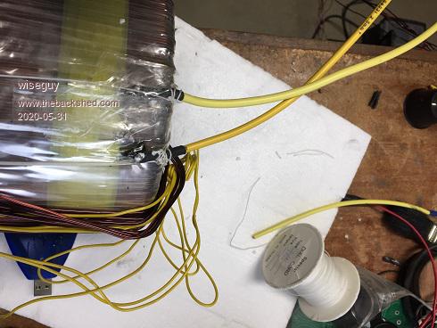

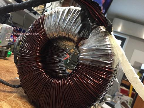

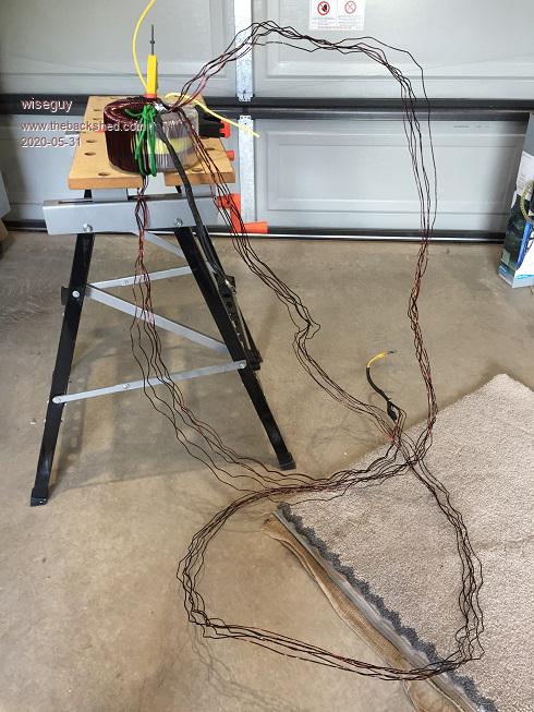

I needed to get more serious about finishing my inverter, moving has gone well and now getting settled into the new house.
I earlier bought two largish toroidal transformers from ebay, which were good value but they had issues. The secondary wires on one were very "wobbly" and I did not really trust them.  Both had a secondary voltage of 35.8v from 240VAC in, it would need batteries 1.414 larger or 50.62V MINIMUM for 240V out.
I contemplated just using a few more cells and running a system voltage higher than 48V, but then I scored a Sirius super cap 48V nominal energy storage system, for minimal cost, that is fully charged at 54V Max and fully discharged at 44V.  It is only 3.6kWH but that should get me through the night after a free re-charge during the day.
Normally I refer to primary as the magnetising exciting winding (240VAC) however from this point onwards I will refer to the 240V as the secondary and primary as the 48V inverter driving winding, even when feeding 240V into the TX for testing..

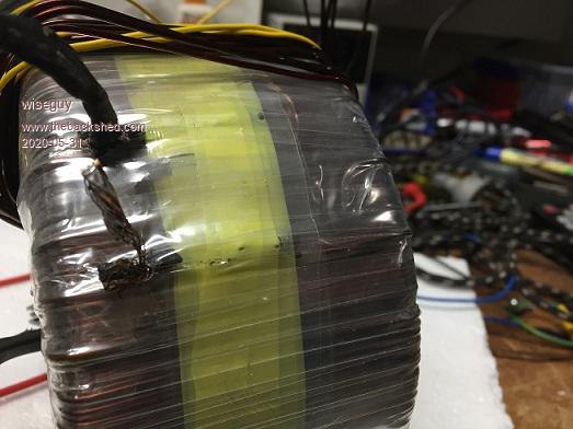

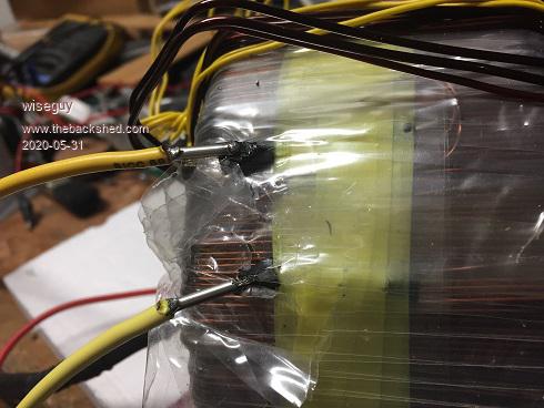

So I bit the bullet and set about fixing the dicky leads on one transformer and to lose some primary turns on both, to allow operation down to 44V.  This entailed unwinding a large part of the primary until I was able to effect a repair on the secondary stubs that had about 10mm of multistrand wire available & that had had some leads poorly connected & soldered - dressed up poorly by someone before I bought them.
Unwinding....UhOH
Just a few strands holding the 240V winding
Repaired with soldered bootlace ferrules
Fixed
Second from left is smaller diameter than others
Ready to rewind with guides

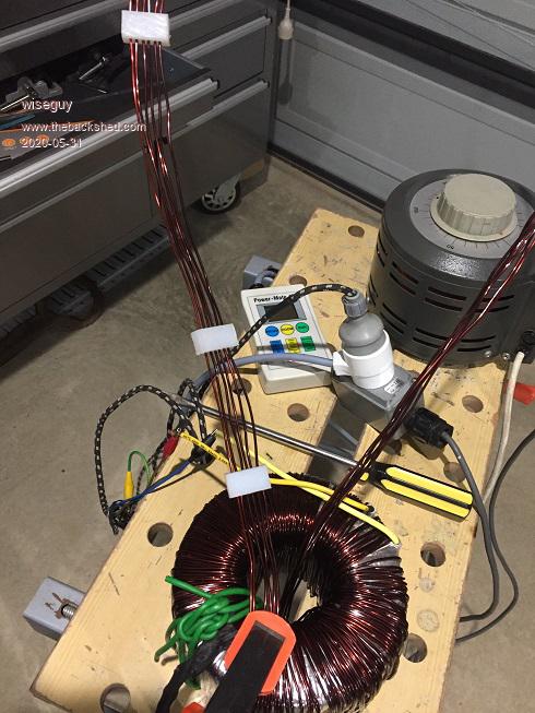

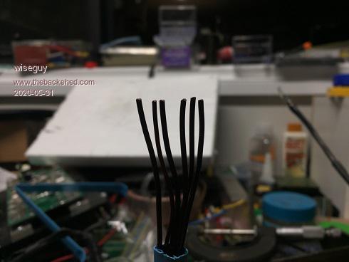

The actual voltage required for 44VDC to AC is 44 x 0.7071 = 31.118VAC.  So I needed to unwind/rewind back enough turns to reach the required ~31V.
The primaries were 6 in hand of 5 x ~1.85mm ands 1 x 1.65mm.  At about this point I attached a temporary 10 turn winding to determine the volts per turn. I was pretty surprised to find 7.74V with 240V on the primary.  That gave me 310 turns on the secondary and 40 turns, yielding 30.9677V required for the inverter drive winding.  Sure there is relatively low magnetising current, but these turns seem a lot more than the Aerosharp toroidals that were being wound by others here.  Most ended up with about 1V per turn, whilst mine is close to 0.774V per turn.
Unwinding the primary a long way was relatively easy going but I could sense that re-winding the 6 strands of 1.85mm wire at once was going to be a right bitch and it was easy to pick where my re-winding effort started - its a bit akin to refolding a large map - it usually never refolds back up looking the same as before you unfolded it.  I never counted the turns it was too difficult with their complicated scatter/overwind method so as I got close to the right number, I carefully applied mains and checked the primary voltage which was 25.7, 5.4V shy or another 7 turns required.

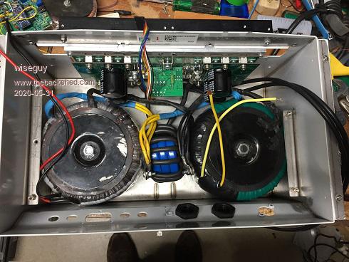

Having completed both units, next I joined the primaries together, ensured I had the secondary's phased correctly and applied 240V to one secondary, measuring from the other secondary was within 0.1V of 240V (much less than 1 turn)  ensuring parallel operation would be fine.

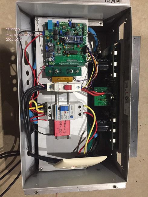

Next I mounted the 2 transformers into an old Aerosharp box, one at each end.
Then hacked the chassis to fit my inverter board/heatsink power stage and fitted a small aluminium panel to mount the nano and some DC & AC circuit breakers.  It did not feel quite right squeezing ~ 5-6kW of inverter into what they had previously allowed for ~ 1.6kW but it squeezed in.  Now lugging the box around, which is unbelievably heavy for its size, is a real task.
It worked first time, running off first one, then 3 x Elteks (~110A overall capability), I could easily start my compressor concurrently with a 2.4KW fan heater, idling along at about 80A input current.  At this stage I am uncomfortable with the 3 switches for pre-charge, turn main CB on then hit the run switch and then get it right in the reverse manner later to shut down.  My next investment will be one of those wonderful LEV2 solenoid/relays that can switch 900VDC and 500+ amps.

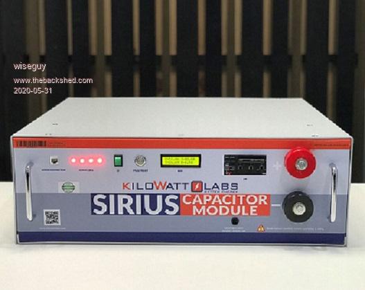

Then I can use just one small single toggle switch to charge the capacitors, when charged up, the solenoid will be driven in to enable the high current feed and the nano will then ramp up the output.
Soon I will get brave enough to join the inverter to my 48V energy storage unit, perhaps then I will get my wife to turn it on......

I use this type
Congrats on getting it working.
Re the start up procedure, it's no big deal having to pre charge. I have the same setup on my house and van  units. The house one obviously just runs 24/7 and never gets turned off.
The van one I just leave going on stand by. All it's doing is keeping the caps charged, which is bugger all energy requirement. When the unit is required, just a quick press of the momentary button starts up the control board and it's going in a couple of seconds.
That saves mucking around with the pre charge.
