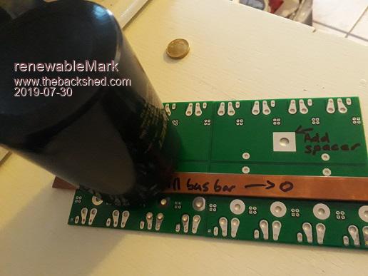

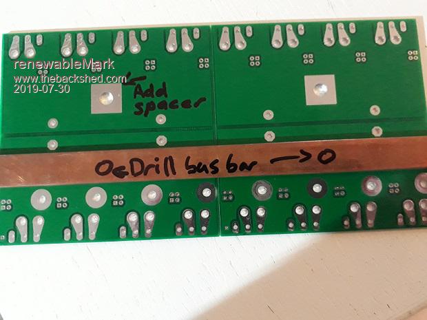

I was planning to solder it, so if an area 16mm or so left blank that would save me scratching it off.
Probably don't need to bolt it down, that amount of solder should give a good mount, but maybe a bolt hole at each side will prevent the surface lifting from the board.

Have you thought about bolting the buss under the capacitor so when you bolt the capacitor on it also connects to the buss bar? The positive side cold also be bussed all just spaced out.
The private messages are off-line so I might ask Tony or Gizmo to provide each other with email addresses so I can send you images, gerbers etc while we work this out.

That's a ripper idea!!
WTF didn't I think of that
I could just use the boards I have now then.

What a simple fix.... ripper!
Just need to strip back the solder mask a bit.

Mark, it's not a "fix" it's a cleverly engineered feature
Posted: 12:07am 30 Jul 2019
The busbars will also greatly stiffen the whole circuit board assembly to carry the weight of the capacitors and tie everything together mechanically.
Its then possible to put together a really physically large inverter, using "thin" standard 1.6mm board material, and standard one ounce copper layers.
A further advantage is that it all comes apart very easily if ever anything needs to be replaced. Its difficult enough soldering really heavy parts in place, its a lot more difficult unsoldering things without making an unholy mess.

I only have lengths of 250mm long, just wondering whether to scarf cut and solder.
Found http://www.georgewhite.com.au/
3.2x19mm $21+gst per metre..... ripper, just buy a length.
Cheers Caveman Mark
Off grid eastern Melb
Posted: 01:58am 30 Jul 2019
I would just use aluminium to begin with. Its cheaper and much easier to work with and Bunnings have a good range in various lengths.
Pretty easy to later on replace with copper from George White when happy with how it all goes together and works.
Use the original aluminium busbars as a drill guide for the copper.
