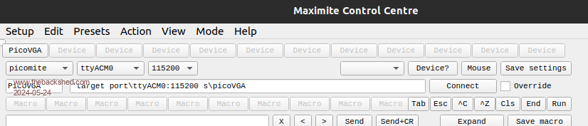

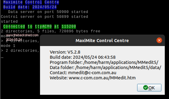

Things are confusing. I have tried version 5.2.8 MMCC May 24 build on linux.
When I manually set the settings according below screen, and save this configuration as PicoVGA then your fix for the file manager in MODE 2 works (with an error, but it works (*)).
In the MMCC inf file in the /data folder following information is visible:

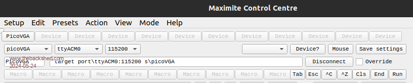

Then I close MMCC, and restart MMCC. The screen looks like this:
For some reason unknown to me, configuration PicoVGA is using "PicoMite" as type. And not "PicoVGA". Maybe this is the default mode (used to be "Maximite"..??).
Anyway, now your fix does not work. Maybe because it is target to only work with "PicoVGA".
(*) the error is generated after the EPOCH command and says "Invalid character "=" "

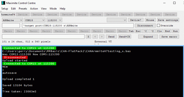

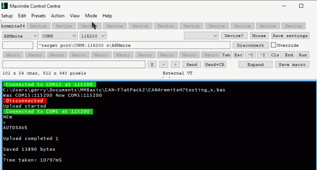

Hi Jim,
I think a little bug may have crept in somewhere. I am sure previously I could send a new file from MMEdit via MMCC with a different target and it would connect to the correct device no matter what MMCC was or was not currently connected to.
e.g. my target is 'target port\com5:115200 s\armite
If MMCC is connected to a different device or even disconnected from a previous device then it will disconnected from that device, say its connecting to the new target, but then load to the old target. See below.
If you first clear the box in MMCC that holds a copy of the most recent target then it all works as expected, changes the port and loads to the new target.
Gerry
F4 H7FotSF4xGT
Posts: 6643
Posted: 03:11am 15 Aug 2024
Gerry,
The 'target line in your code is supposed to have priority (unless the Override box is ticked).
I did a bit of work trying to remember the last device between program loads and I suspect I stuffed up something in the process.
Tomorrow is going to be a wet day so I will do some testing and sort out a fix.
