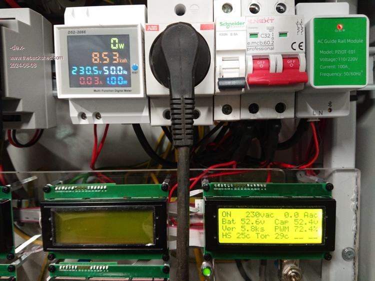

Posted: 01:02pm 08 Jun 2024

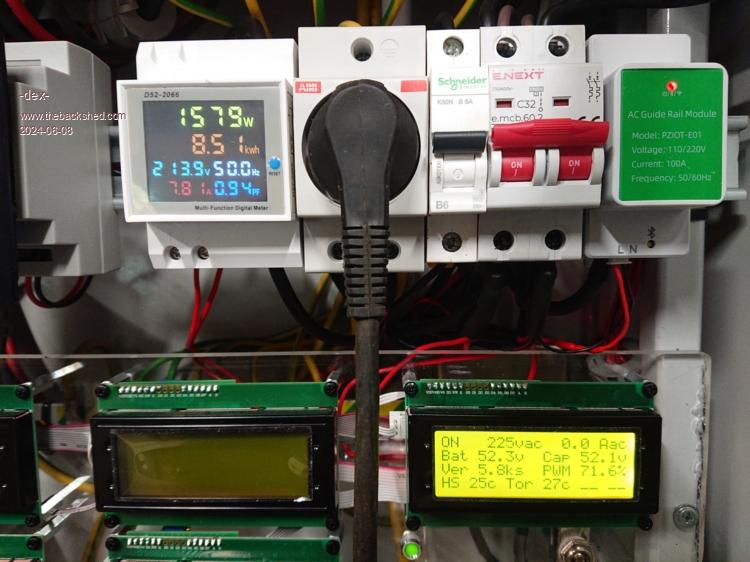

I disconnected the current sensor cable and then loaded the inverter.
There is still the same AC voltage drop, as on the photos below.
On the photos you can see additional power meter, it is at the inverter output, the inverter LCD shows the remaining parameters you asked about.
Please do not rely on the AC voltage from the inverter's LCD, it has probably not been precisely calibrated.
The mod with the link on pin A7 to GND has already been applied previously. Then this solved the problem of zeroing the current on the display. It did nothing to stabilize the voltage. To be sure, I checked again, A7 is shorted to ground.
Edited 2024-06-08 23:13 by -dex-
wiseguy
Joined: 21/06/2018
Posts: 1336
Posted: 02:02pm 08 Jun 2024
Thanks for that Dex it is very revealing.  It tells me the servo loop from the DC input through inverter transformers choke etc to Ac output& fed back around the loop to the voltage feedback  is happy. I deduce this because the two modulation percentages are almost the same. If there were impedance problems anywhere the % would increase to make up the shortfall.
I suspect that if you measure with an AC RMS voltmeter at the two pins feeding back the AC output right at the Nano control board it will have exactly the same voltage reading of 230.5 give or take half a volt for the instance of no load and ~8A load.
It appears there is impedance between the 230V transformer output and your multi function meter.  It can be roughly calculated by using the difference between the loaded and unloaded AC voltage which is ~ 16V and the current difference is ~ 7.8A that tells me there is a voltage drop between the AC output winding and when it finally is measured by the meter.  The resistance you are looking for is ~16/7.8 or around 2 ohms.
Maybe you should grab a true RMS meter and start hunting. Hint, at 8A load, measure (ACV) between the same active wire immediately at the closest point to the toroidal with the other end of the meter to the active out of the multifunction meter, note it - then do the same at the other end of the 230V mains wiring  (neutral?) from tranformer to meter neutral out. Add the two noted AC voltages together and I suspect the sum will be damn close to 16VAC.  Good luck and be careful probing !!  Note the AC output probably passes also through the Mains contactor/relay assuming you installed one, it obviously needs to be closed to measure the voltage drops.  Welcome to ohms law. (I hope this is all correct I hate humble pie)
Do you have an AC line filter in the 230VAC circuit too?
Edited 2024-06-09 00:33 by wiseguy

Posted: 10:04pm 08 Jun 2024
Dex just out of interest, you might also try it with a purely Resistive load - I have big old 2.2kW electric jug I use.
This way LCD ACV voltage should be within a volt or so the the true RMS Mains monitor. Not going to make any difference to your fault finding, but at least you will be looking at roughly the same numbers on the meters and any handheld meter that you are suing.
BTW That AC monitor model appears to be very accurate against my expensive True RMS meter.

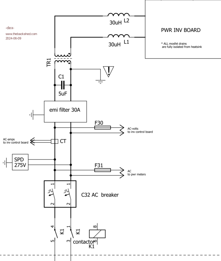

-dex-
Joined: 11/01/2024
Location: Poland
Posts: 104
Posted: 06:03am 09 Jun 2024
Good morning!

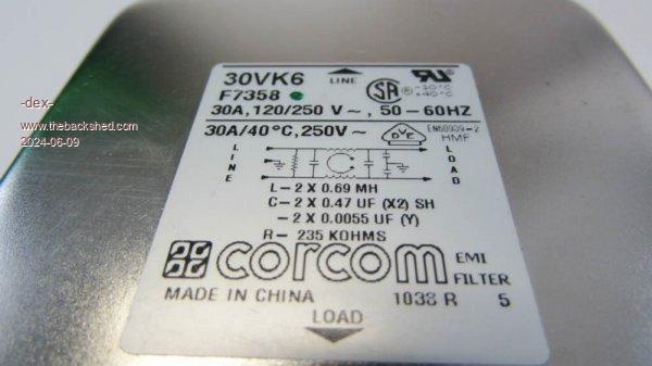

So I'll refer to the first answer. There are basically 3 components on the AC source - input pin route on the controller board:
1. EMI filter
2. Fuse
3. Ferrite beads
Everything is connected as in the diagram.
Both meters on din rails and the "inverter's meter" wires are connected at one common point.
RV1 behaves correctly, I can change the input voltage with it. But why does the system do nothing to change the SPWM % when the AC voltage drops?
I could observe large changes in % SPWM in case of significant changes in the DC voltage on the power rail.
Edited 2024-06-09 17:16 by -dex-

Another possible thing to try is to move the secondary winding earth point to the output side of the EMI filter.
As the metering and feedback are taken from there it might minimize any interference.
It may also do nothing, but there is only one way to know for sure.

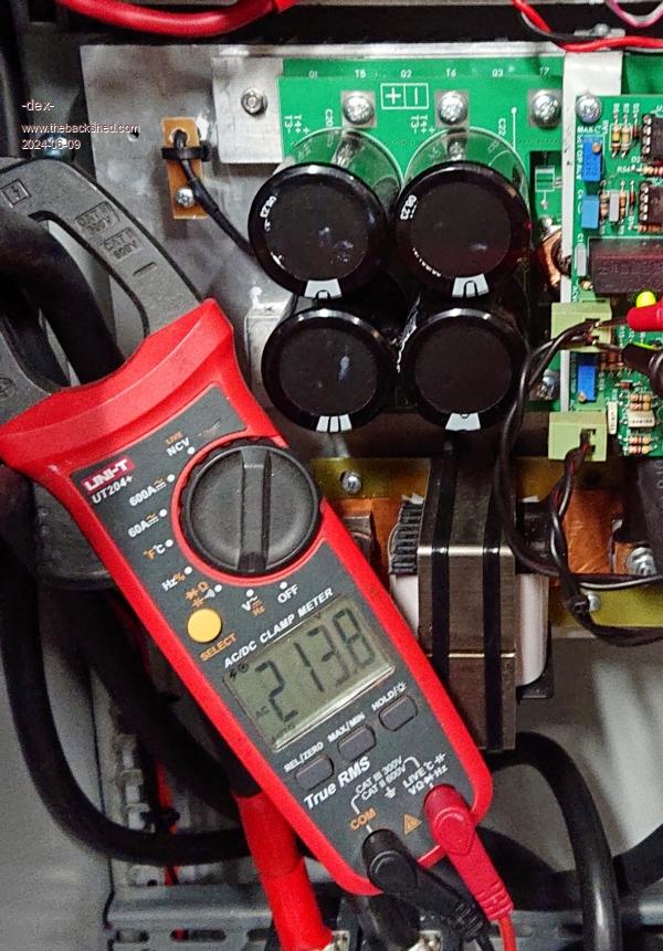

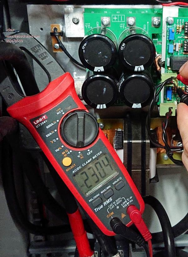

-dex-
Joined: 11/01/2024
Location: Poland
Posts: 104
Posted: 08:56am 09 Jun 2024
  wiseguy said  Hi Dex I was waiting for you to do the first test,
"I suspect that if you measure with an AC RMS voltmeter at the two pins (J2) feeding back the AC output right at the Nano control board it will have exactly the same voltage reading of 230.5 give or take half a volt for the instance of no load and ~8A load."
Please measure the AC volts at the connector with an RMS meter for no load and with an 8 Amp load 8 is not critical 6-12 amps will do higher is better. What are the 2 AC voltages ?
Here they are.
No load
~8A resistive load
wiseguy
Joined: 21/06/2018
Posts: 1336
Posted: 08:59am 09 Jun 2024
Excellent - we are making great progress!
Thanks for the pictures and wiring diagram, do you have the control card mounted just some millimetres above the main Power Fet PCB ?
Edited 2024-06-09 19:01 by wiseguy

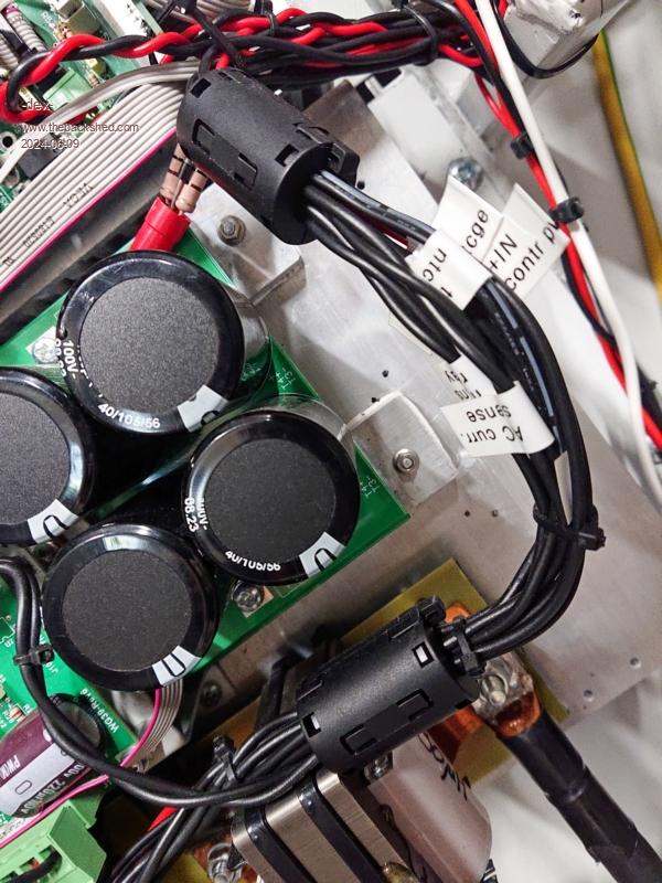

-dex-
Joined: 11/01/2024
Location: Poland
Posts: 104
Posted: 09:15am 09 Jun 2024
Yes, about 4cm above power fet pcb.

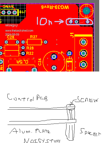

I believe that is the problem it is noise pick up under U1 & U2. Rather than you mount a whole metal plate, can you fabricate a small copper foil shield that covers the underside of U1 & U2 and the D1, D2 & D3 about 40mm square at a guess and soldered to 3 or 4 earth points 5-6mm clearance is fine.  It does not have to be real pretty just avoid the mains connections and check clearance between other points and the shield and that nothing squashes it against other soldered points when you install it.
I would like to make an observation that it would have been better mounted to the side of the main switching parts or at least have a metal shield the same size as the board if you are going to mount it so close to the noise - I have never tried doing that.
The only way that the servo loop can be happy with less volts at the feedback point is if injected noise is adding to the feedback volts causing the voltage at A0 to be the same for the cases of 230V & 214V.  More load = more noise - reduce output voltage a bit to be in balance again.
Edited 2024-06-09 19:36 by wiseguy
Cheers Mike

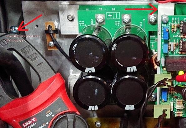

-dex-
Joined: 11/01/2024
Location: Poland
Posts: 104
Posted: 09:51am 09 Jun 2024
I can add an aluminum plate underneath the entire controller board.
Please clarify what kind of grounding you mean.
Casing is earthed, so the heatsink and controller holder also have casing = earth potential - red arrows.
Should the aluminum plate have the "-" potential of the battery or the earth potential?
And there's one more thing that makes me wonder. If the noise signals the controller to reduce the voltage at the output, I should notice it in % SPWM, and according to what the LCD shows, it remains unchanged.
Edited 2024-06-09 19:57 by -dex-
wiseguy
Joined: 21/06/2018
Posts: 1336
Posted: 10:00am 09 Jun 2024
I would be happy for either or neither it does not have to be earthed. I would put it to ground if I had to chose. I believe that KeepIS put it to B-.
The plate does not have to be earthed to ground or B- but it must be connected to the PCB groundplane area (through the 10n capacitor you need to fit). Next step is to put the capacitor of at least 10nF - preferably a multilayer ceramic, from the PCB ground-plane pads to the screw solder pads just near J1.  The screw should have a metal spacer to the plate once the plate and the ground plane and sensitive nodes are at the same "noise" potential I believe it should cure your problem.
Edited 2024-06-09 20:02 by wiseguy
Cheers Mike

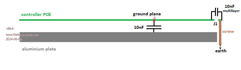

-dex-
Joined: 11/01/2024
Location: Poland
Posts: 104
Posted: 10:42am 09 Jun 2024
Before I do anything, I want to be sure that I understand what I read, and I'm not sure of that.
Is this what it's supposed to look like?
wiseguy
Joined: 21/06/2018
Posts: 1336
Posted: 11:10am 09 Jun 2024
It is easier to write than draw the picture. Make a plate of aluminium same size as control PCB
Screw aluminium plate where pcb is now, use spacers to screw the plate to the existing spacers (I hope you have 4 spare spacers female to male).
Now solder 1 and only 10n capacitor on PCB pads just next to J1.
Now screw control PCB onto the spacers sticking up from the aluminium plate.
Put wires/plugs back to control card and retest.
I will draw a picture but not possible for about 1 - 1.5 hour.
Edited 2024-06-09 21:10 by wiseguy
Cheers Mike
wiseguy
Joined: 21/06/2018
Posts: 1336
Posted: 11:24am 09 Jun 2024
I got my 4 year old assistant to draw this.........
What can I say...... drawn with a fingernail on a touch pad....
Cheers Mike

2)Could you also remove the AC feedback wires from the clip on ferrite suppressors and retest. (leave them off for now)
3) Could you please remove the ground connection marked in a triangle with ! on it ie the node of the transformer leg and the mains filter leg and retest. (leave it off for now).
