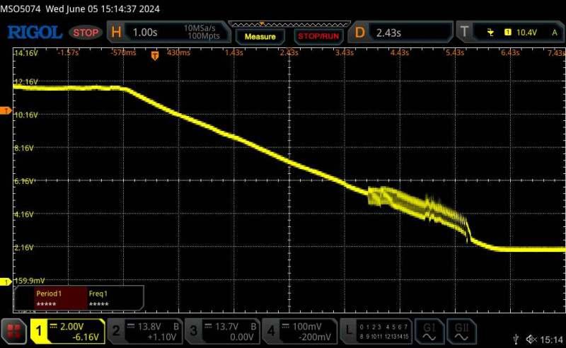

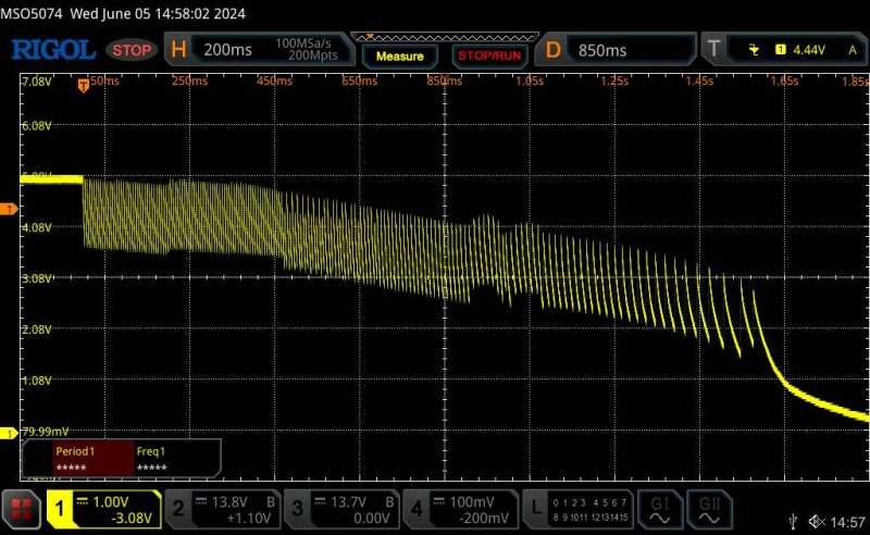

I caught it on video. The flickering is more visible on the LCD than on the controller board. The inverter was not loaded, all MPPT chargers remained turned off. Video 3 Video 4 I tried with 10k resistor on off wire to ground, 5k, and 2.2k. Even with 2.2k a flickering are still there. Guess this is still to small load to discharge it quick. If your web-browser can't open & play video directly in a tab, you can try to download file by right clicking, but you need some program or app to play *mp4 file. My MPPTs use different power supply, showed few post earlier, and this is shutting down without any flickering thus amnesia doesn't occur even when loaded code to nano-mppt-controller and nano-lcd with bootlader. Edited 2024-06-05 05:01 by -dex- |
KeepIS![]() Guru ![]() Joined: 13/10/2014 Location: AustraliaPosts: 1868 |
Looked at both videos, slight backlight flicker matches the +5 supply LED. Trying to discharge the cap bank with resistance is not going to make any difference, the cap bank is below 12v when this happens. It can be either 12v or 5v regulators and as mentioned in other conversations, we are using different +5v regulators. My 12V regulator is a 1A version. +5v is an MP 1548-PSU-01, the amount of slight flickering I see is unlikely to cause any issue with the Nano or inverter, the RX & TX LEDs are not flashing which is good. Under these conditions, the LCD-Nano should not get corrupted, as I said, I have never had this, and mine have been running under very adverse conditions with more power cycles then I can count. I know you were absolutely having trouble with this, and it looks like the fix we came up with has worked. So I will remove the bootloader from LCD and Inverter Nano, as stated in my last post, and stop the USB controller from driving the Nano Reset - Both are simple 3 second mods. In many posts, and in my old thread or correspondence, I have noted that 5v SMPS regulators have a slightly pulsed output below regulation on fading DC input, so this is nothing new from my perspective. It was the flashing RX, TX LEDs that was my main focus, but again, not apparent here. . Edited 2024-06-05 09:11 by KeepIS NANO Inverter: Full download - Only Hex Ver 8.1Ks |

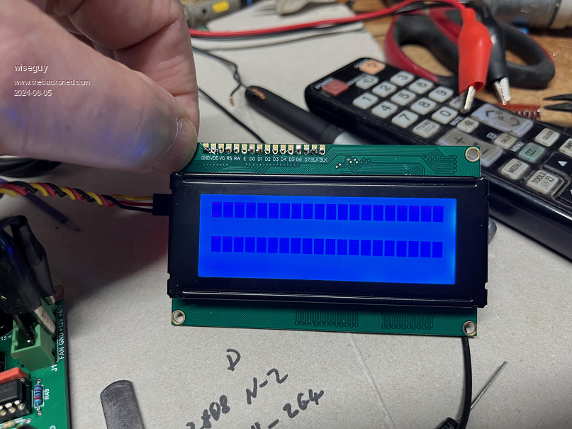

Not sure if I have good news or bad news but I KNOW what is causing the LCD code failures that Dex is having. Here is a picture of my crashed display - it took me all of 5 minutes to nail the cause. ![]() I connected up a controller and an LCD nothing else, then I put a 150R resistor on the + input lead. And set my power supply to about 6.6V in - I also monitored the controllers 5V line which was about 1.8V when the crap hit the fan. As I toggled the input voltage up in 10mV steps I got to a point where the Nano LED just turned on dimly, as I toggled up and down in a few 10mV steps bingo the TX LED on the Nano suddenly flickered busy and then when I applied 16V my display came up with black blocks that could not be cleared. I believe I was right in my assumption that at low voltages where logic etc doesn't behave well could be causing the issue. Despite protests that you doubted whether my theory was right and you categorically stated that a resistor to continue to discharge the Caps instead of allowing them to spring to life briefly could not possibly help I beg to differ. This was occurring below 7V in. I probably should be getting used to put downs but I don't like being shunted off track especially in the WRONG direction. The whole environment of this saga as it unfolded has annoyed me somewhat. If others are asking for help and I take up my time and effort to give the best response I can come up with, by all means have a different opinion, just prove yours right or mine wrong before going public maybe. When I have a clearer head I will try to come up with a cure but happy for anyone else to take it on. Edited 2024-06-05 15:36 by wiseguy If at first you dont succeed, I suggest you avoid sky diving.... Cheers Mike |

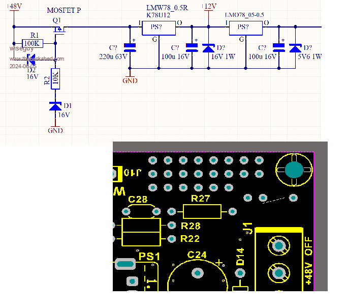

I may have a solution so I'll throw it out to the forum for comment. I want to start by saying how much this sucks that the boards are in production and we now find out about this glitch at the 11th hour. I expect the boards will be despatched (back to me from JL) late tomorrow. So to the problem, everything is fine at 16V or more, below 12 and closer to 6 we have issues. Whilst considering creating hex code to upload to the Nano as the fix I am still nervous about what I have seen and the possibility that there might still be random things to go wrong. Maybe the final solution will be code and hardware mod ? With all this in mind what if we could turn on the power from the 24/36/48 whatever, when the input voltage is above 16V. with this in mind my simplest solution I can think of is in the attached picture. Please note the bread-boarding area right adjacent to the 48V and regulator was a last minute addition - just in case. I would also probably cut the track such that the 220u is on the source of the FET to ensure the regulator switches off as fast as possible. ![]() So above 16V - probably closer to 19V the P channel FET will turn on and supply the battery input to the 12 & then 5V regulators. The second zener protects the gate voltage from being exceeded. Below 16V input the FET is hard off. If there is consensus I probably have enough Pchannel TO220 FETs to supply for each Inverter main board/controller ordered and certainly enough Zeners to throw in too and they can all be shipped out at once ? I will of course create a few pictures of how to add the Mod and parts to make it work. Edited 2024-06-05 22:04 by wiseguy If at first you dont succeed, I suggest you avoid sky diving.... Cheers Mike |

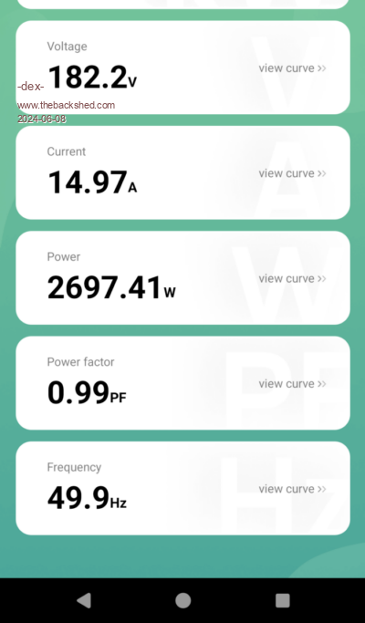

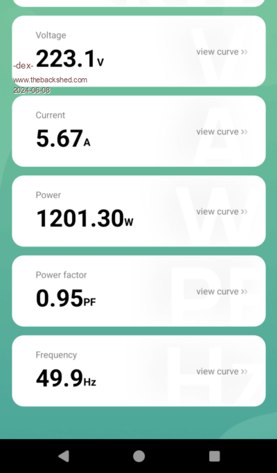

Finally, I managed to connect the target battery set: 16x 280Ah lifepo4. This time there was no fire ![]() I will soon send some photos of how it was done So far, I have tested everything on small loads, now I can go further. Oops.. no I can't. It turns out that there is a problem with voltage collapse under load. It appears that the relationship load/voltage drop is linear. Below is what I managed to catch on the meter in the application. When the voltage drops this low, the inverter turns off. Voltage regulation with a potentiometer on the controller board works properly, currently I have it set to 230V. No load/tiny load sits on ~ 230V. Small load small drop, large load large drop. Currently the KeepIS code is loaded, but I also saw this problem with the Poida code earlier, it's probably not a problem with the code, but with my configuration. I also know that in the case of KeepIS build the AC voltage is very stable. There is a problem with my build, but I have no idea what is causing it. Do you have any suggestions? One final note: measurements taken when all MPPT were off. ![]() ![]() Edited 2024-06-08 19:56 by -dex- |

I am sorry Dex you are in KeepIS's hands here I have no idea what the code is up to. The only query I have is did you ground the Nano pin A7? In the Poida code we had a similar issue but a dummy read of A7 between the Amps reading and the VFB feedback reading solved it. The fact that KeepIS has an inverter that is very stable indicates that there must be a difference between his PCB and yours. One way to prove the point easily is to disconnect the current sense transformer and then load it up to 15A again and check the AC voltage - I suspect it will be fine. Don't leave the current sense unplugged like that but lets know the results of that test. Edited 2024-06-08 20:17 by wiseguy If at first you dont succeed, I suggest you avoid sky diving.... Cheers Mike |
You have a problem with voltage loss somewhere in the inverter or toroid, choke or filter wiring loss.. 1: measure the voltage across the DC input terminals on the Inverter Power board. The voltage under that size load should hardly drop, mine would see a voltage drop in the 100mv or less range. 2: Voltage loss across the chokes or toriod problem, but what we need to know first is the % of PWM in both cases, it should only change a few %. That would mean either DC voltage is falling to the inverter or a toroid / choke problem, both could cause the inverter PWM to hit the max 99%. I assume the info above is from a dedicated AC monitor. Even the $36.00 ones I use are surprisingly accurate. The only other thing is something not right in the feedback circuit or the Toriod winding ratio is having trouble with some voltage drop and cant maintain regulation, again 99% PWM This is just off the top of my head - and I'm tired, so I may be off base on a couple. But at least nothing is going bang - always a good thing ![]() . NANO Inverter: Full download - Only Hex Ver 8.1Ks |
