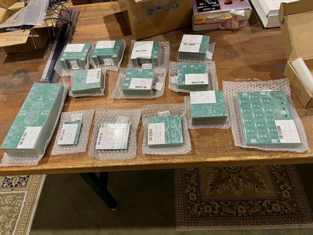

Well the slow boat from China finally arrived last night so this is a mite bigger task than it looked on paper.... first cut out 60 display boards sigh.
Will ship overseas first and the rest immediately after, unfortunately the weight for Serbia and UK will be a tad more than I had calculated for, so next time for overseas stuff, being even wiser I will just pay up front and after shipping send on the total but its live and learn - I'm not really fussed its only money.
Here is a picture after unpacking the box before it gets really messy......
PS this is my wifes bench mine is even cleaner haha - NOT
Cheers Mike

I didn't realize you had to cut the display boards. Bringing a project like this together is hard enough, but doing it on your own is makes it even harder.
I guess there is not much more we can say except thanks for all that hard work, effort, and hope any hair loss is not permanent.
The great part is, the Inverter does run beautifully
Edited 2024-06-19 13:39 by KeepIS
