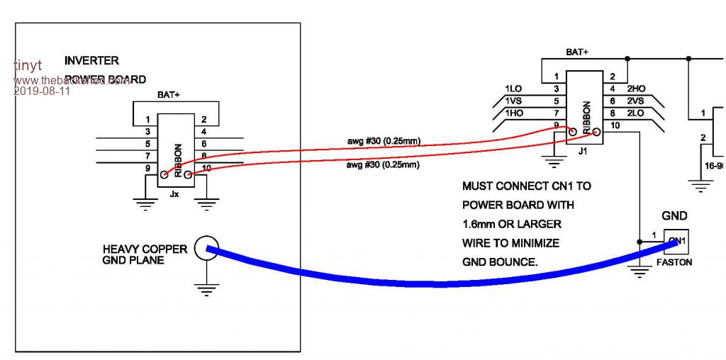

I don't know if excessive ground bounce is happening in your setup. The idea of CN1 connection is to minimize it.
My theory is any switching current drawn from the Jx pins 1 and 2 by the nanoverter will raise J1 pins 9 and 10 from Jx pins 9 and 10. The effect is 0 volt signal from the IR21844 will not be exactly 0 with respect to the power board ground. CN1 connection will minimize it, I think.

TinyT I will do this in the next attempt.
The changes made for the next attempt:
no ferrite beads on Drains
Add the thick ground lead

if the TIP41/42 emitter followers cannot pull all the way up to the positive rail, maybe they also cannot pull all the way down to the gnd rail.
mackoffgrid
Joined: 13/03/2017
Posts: 460
Posted: 09:00pm 13 Aug 2019
  tinyt said  if the TIP41/42 emitter followers cannot pull all the way up to the positive rail, maybe they also cannot pull all the way down to the gnd rail.
Yes, to both. The emitter followers can't get to either rail. Close enough it seems. It has surprised me that the low has been low enough. Driver IC's go to some trouble to get close to the ground rail.

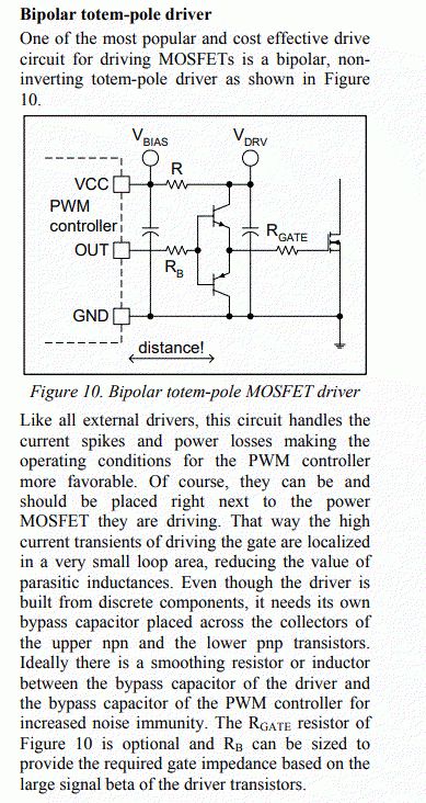

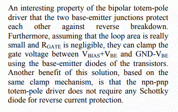

Solar Mike
Joined: 08/02/2015
Posts: 1255
Posted: 09:03pm 13 Aug 2019
Here is a good explanation why this driver is good to use:
Good value for "R" is 10 ohms to isolate the driver chip supply from the output pulses, with the LHS cap 100uf and the RHS cap 1 to 10uf depending on the number of mosfets being driven, ideally one totem pole driver per mosfet.
Mike
