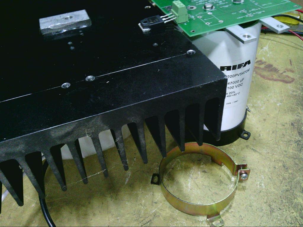

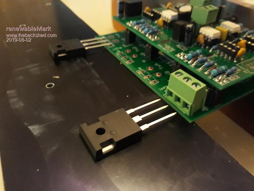

Not sure which way to jump here.
I could align the heatsinks this way, but getting at the fixing bolts will be a bit fiddly.
Or it could be done this way.
The fets could either be soldered in and the legs bent around (being careful not to stress the leg where it goes into the black body of the fet)
Or the 20A plugs could get used.
Cheers Caveman Mark

As you say, the top picture is going to be difficult to access the screws.
Soldering in is not a good idea IMHO, and if you use screw terminal blocks in the top picture the screws on those will be even more difficult to reach.
I much prefer the lower picture. The screws are all facing straight up and you can see what you are doing with excellent access and visibility.
You could use conventional capacitor clamps to support the capacitors, then use the capacitor terminals to support the busbars and circuit boards.
The mosfet legs can then bridge between the circuit board and heatsink, like this:

I was always worried about bending the legs of the bigger devices. But, I do like the idea of the Mosfet being horizontal like in photo two.

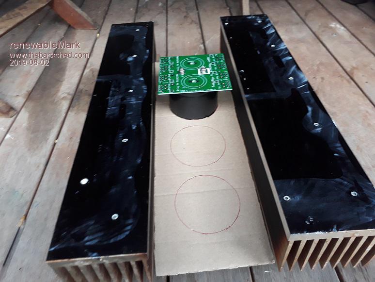

How about a big flat sheet of 3mm aluminium with a row of 75mm holes for the capacitors.
The capacitor clamps can clamp around near the middle of the capacitors, and the height of the circuit board can be adjusted to perfection.
The finned heatsinks bolt to the aluminium plate forming an air tunnel.
It would make a very rigid easy to fabricate structure, that ties everything together with everything very easy to work on.

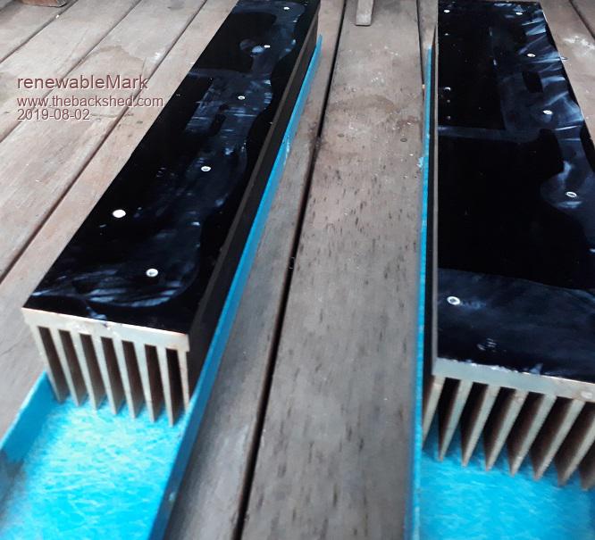

Like this?
I was thinking perspex, that way I won't need to worry about insulating the connections to heatsinks.
The caps aren't actually that heavy and the boards seem to support them just fine.
Anyway the initial idea was to use the fibreglass channel to tie it all in together.
Cheers Caveman Mark

Yes exactly Mark.
The capacitor clamps may need to be located underneath the plate so you can get to the screws with the circuit board and busbars fitted.
I bolted (and epoxied) some aluminium angle to my heatsink, which then bolted down onto a big flat plate.

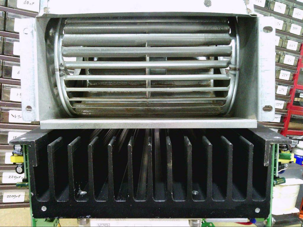

They will need a fan each, but the plus side id they will be baffled the same way you do with an aircraft (piston) engine, to get all the flow through the fins.
Caravan fridges work the same way, lots of air flowing all over the fins at the back doesn't cool them, restrict the flow (baffle) to just the fins seems to work best.
Cheers Caveman Mark
Off grid eastern Melb
Posted: 07:42am 02 Aug 2019
A computer fan is not going to be up to the job, the pressure drop along that long heat sink is going to be quite high at sufficient air volume.
One or two centrifugal air blowers wold be more suitable. I used a 230v blower from a Rinnai gas room heater, but a 12v car heater blower might have more suitable dimensions.
Posted: 08:08am 02 Aug 2019
It will be more efficient, with a lower pressure drop if you feed the air blower into the middle of the heatsink, so that half the air goes up, and half the air goes down (onto the transformers). That is how I did mine.

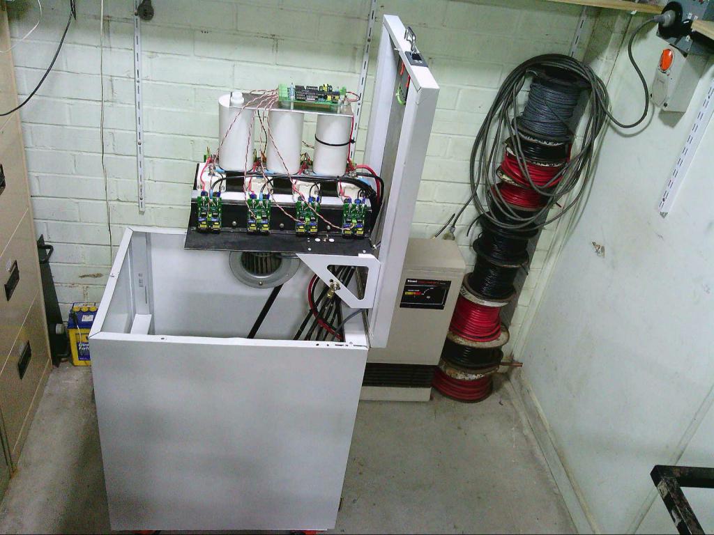

I don't like how my other machine is crammed into a box, very inconvenient if something goes wrong. Thankfully the bugs seem to be ironed out of that though (just touched my wood desk )
The locker it's going in has two doors/sections, so they'll need individual fans anyway.
I already have some temp controlled circuits for the fans/heatsinks that are 12v so may as well stick with that for now. Might try the computer fans to see how the flow is, might end up with a car one, wait and see.
