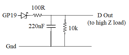

I am allocating Picomite VGA I/O for something I am working on.
I am one I/O short.
Is it possible to configure Picomite VGA so that instead of 2 bits green output (when in color mode) it can use one green bit/GP20 leaving the other green GP19 available for use as general I/O? This would reduce colors to one bit R/G/B which is enough for displaying status in different colors etc (still an advantage over mono/green VGA).
I could use VGA mono/green and free up 3 more I/O but only really need one more, plus I'd like to retain some color capability.
Edited 2022-01-17 11:57 by flasherror

If I have understood the description of PicoMite VGA, the VGA driver is running in the second core making those pins allocated to it inaccessible to MMBasic programs, which can only directly access pins allocated to the first core. A different version of PicoMite VGA might be needed with different pin allocation to get what you want.
The correct answer will have to await Peter's return.
There are a number of I/O expansion methods available.
Posts: 3416
Posted: 05:26am 17 Jan 2022
Plan B
In the "PicoMite VGA Check" thread there is a description of how to re-map the colours to get RGB+Intensity - RGIB(1,1,1,1). Use that scheme except use the intensity bit (GP19) as a digital output. Create a different map to give separate control of the I bit. If you just use a RGIB map, in your program for a high output use bright colours and for low use dim colours. As the intensity bit is not controlling the display all colours will be bright.
A crude sample-and-hold will remove frame flicker from the output.
eg:
Edited 2022-01-17 15:41 by phil99

This is interesting but what happens during reset (Picomite VGA output startup message so activity on GP19?)
