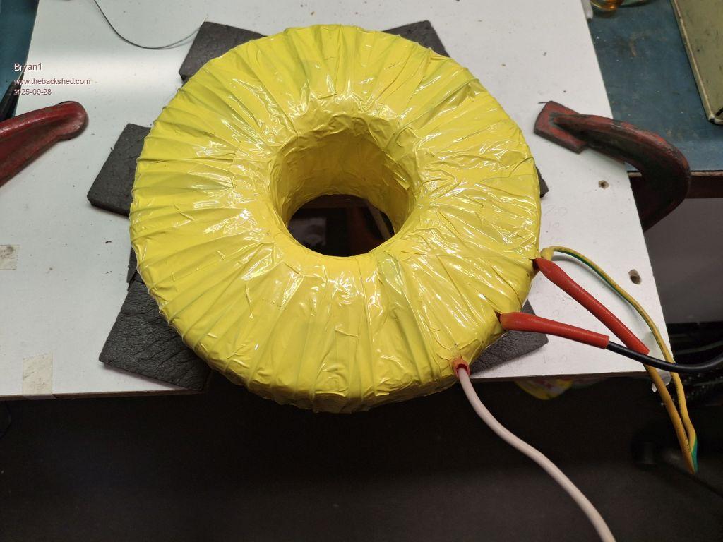

           This morning we reversed the connection on the 16 turn winding and ran the same tests. Roger had setup a power meter so we could get the true idle watts and man were we surprised on average 10 watts idle power
We did some tests with more turns for very little gain so stayed with the 16 turns and Roger said he will post the test figures later today which will show that little gain.
I used that Dow Corning yellow tape to isolate the winding and Roger did a search for this tape where the price was over $50 a roll   So I am glad I did save that box of the tape.
So now one step closer
Cheers Bryan

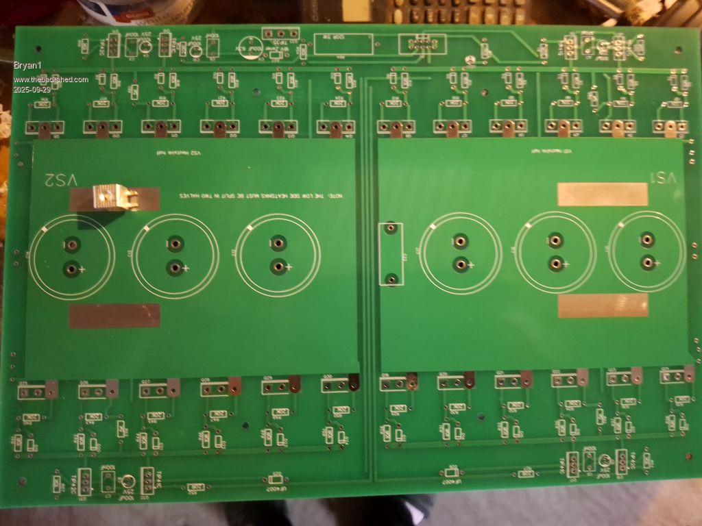

G'Day Guy's,
            Well I'm now onto the next stage and after spending hours searching this forum I wasn't able to find any pictures of this board at all
Here is a pic of a blank board with one of my 4mm connectors where I bent the legs 90 degrees so they sit on the pads nicely. Now once I do get the cable tightened on the post I reckon soldering it will ensure a solid connection.
Now we have 2 pads on VS1 and VS2 so is only one pad on each needed or both ?
I did a trial fit in one of the aerosharp box's and they are too small for this board so I will drag out that rack mount case from the corner of my shed and use that.
Regards Bryan

Posted: 08:52am 29 Sep 2025
Toroid looks good Bryan,
If you were going to use a lot of power, probably use both pads, Think one pad will handle a fair bit anyway, be good to check if you have enough Clarence between that 4mm standoff connector and the heat sink, I have a narrow heatsink, just checked, I could almost get access to that terminal screw  after the heatsink is on, with a thicker heatsink there will be no access to the terminal to attach a cable.
There is a few other ideas to approach this, I will see if anyone has some more input later.
Cheers Aaron

Posted: 09:02am 29 Sep 2025
Thanks for that input Aaron now I do have a heap of 16sqmm cable here so yea using both pads and 2 16sqmm cables going into one connector to the dual choke like I did with that first inverter.
I do have to get a roll of heatsink to fit that thick copper I pulled off that huge transformer from that battery charger as I annealed it on my crab burner.
Out of the 2 aerosharps I only got one big choke so atleast got one to use and this time I will go with 8 turns each side so the inductance is a tad lower.

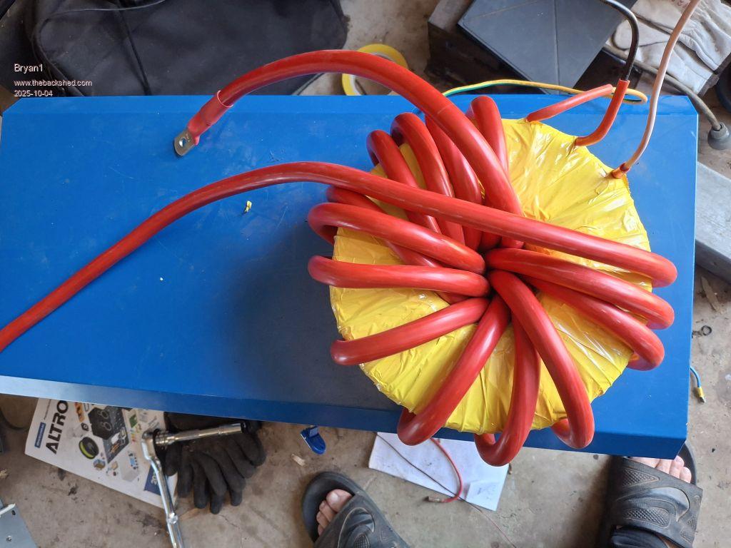

G'Day Guy's, well went to the 12 volt shop this morning and got 6 metres of 65sqmm red cable and just managed to get 15 turns thru which should be enough and I was told the 65sqmm wire was good for just under 300 amps
Next week I will get a roll of heatshrink so I can insulated that 6.2x4 copper wire so I can make the choke.
also got a bit of work to do on that rack case so getting there.
Regards Bryan

Posted: 05:57am 04 Oct 2025
Looks like it is coming along fine. That is a squeeze fitting in the low voltage winding but it is there, so that is all that counts.

Posted: 06:11am 04 Oct 2025
Yes Pete is was fun getting that last turn through and I didn't have enough for another turn either as that 6 metre figure I quoted was just right for 15 turns but at $25 a metre no wastage so I'm pretty happy. got them to put one terminal on the cable and after the trial fit I may go back with the toroid to get the other end crimped as they do a nice job.

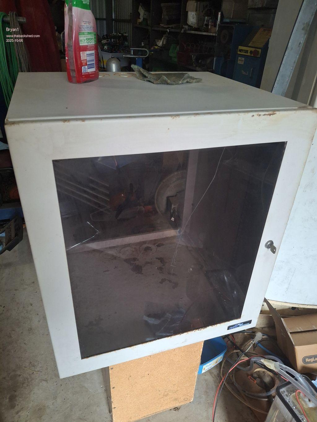

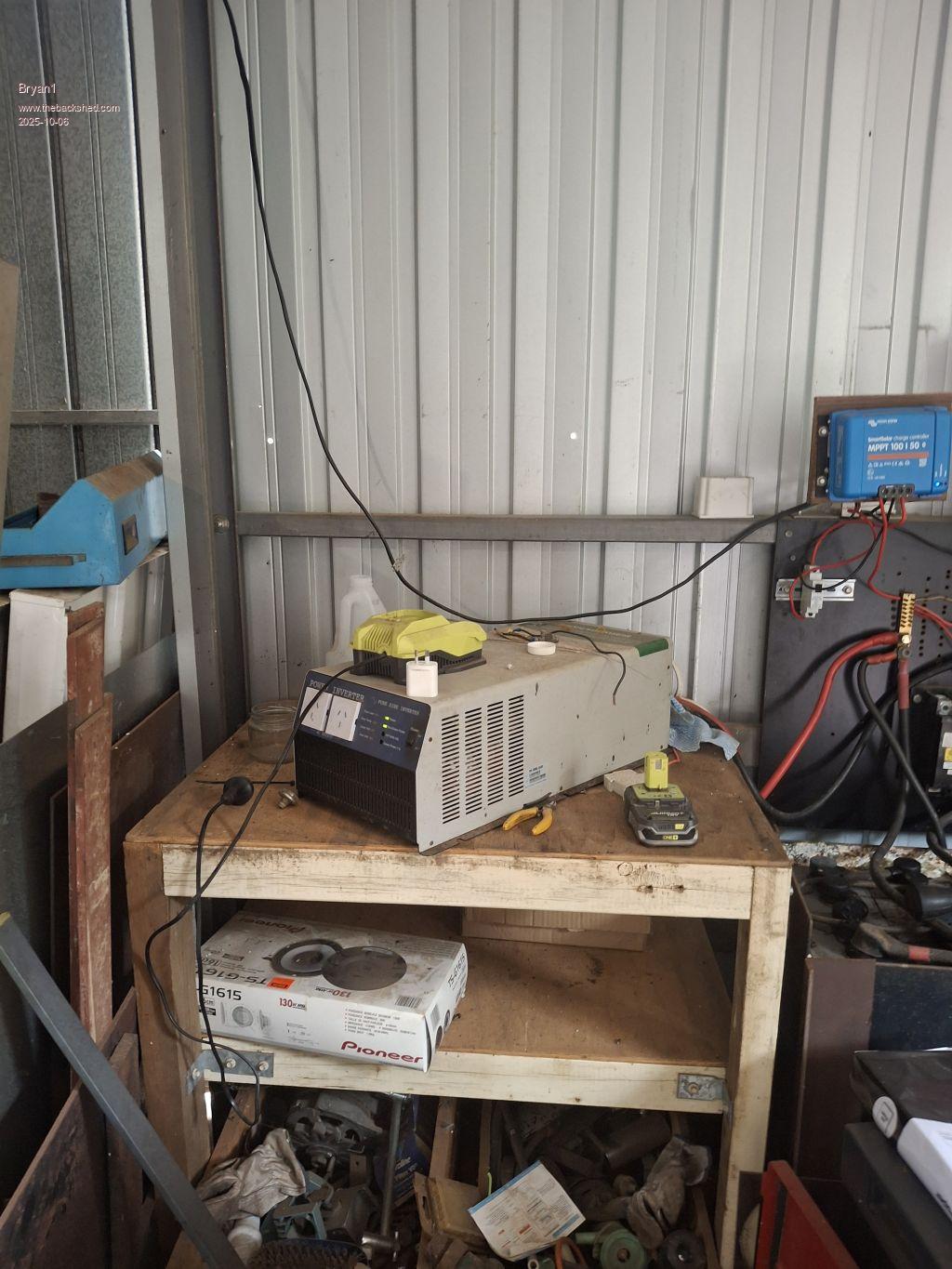

Morning Guy's well had a bit of cleanup and got that rack case out   it measures 535x600x450mm so plenty of room to fit everything. This case has sat in the corner for over 20 years and has finally found a use.
Still need to close in the back of the case and make some shelves and it does have vents top and bottom on both sides which will allow for efficient cooling.
I do need to move my Kipoint inverter to the lower shelf so the rack case can sit ontop
So still plenty of work to do to get this all done and the plan is get it done so when those blue toroids for the chokes turn up it's all ready to assemble.
Regards Bryan
