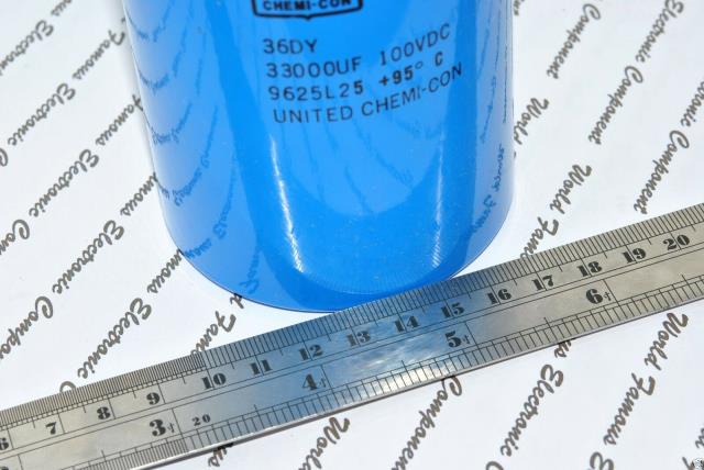

Is this good candidate it is around 50 $
RIFA 33000uF is about 3 times that
Regards kanchana

Posted: 07:18am 10 Mar 2019
Nice find Kanchana.
Tried to find data for that capacitor.
Chemi Con data is here:
http://www.chemi-con.co.jp/e/catalog/pdf/al-e/al-all-e1001s-2018.pdf
Could not find 36DY or 9625L25 part number, but closest thing that looks similar is on page 312.
33,000uF 100v "large capacitance aluminium capacitor" Ripple current rating 15 amps.
That should work. If it gets unhappy at sustained higher power, the main problem will be temperature rise in the capacitor. That takes time to build up, but otherwise its a nice big capacitor with a lot of energy storage.

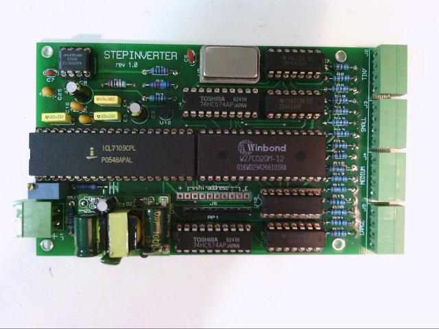

  Warpspeed said   Andrew, the first one of these step inverters I ever built (now almost forty years ago) used a 68H05C8 processor with 16K of internal eprom. It used three inverters giving 27 voltage steps peak to peak, with fifteen 1K lookup tables. Still have that original inverter around here somewhere.
It worked very well for what it was, only 500 watts with 10v to 15v dc input. It was just a toy really, but it certainly proved the original basic concept to be very sound.
Thirty two lookup tables is certainly very workable, and 1K lookup tables provide more than adequate 20uS time resolution for any number of inverters.
My latest effort powering my house right now uses 256 1K lookup tables which is vastly more than is really necessary. probably 64 or 128 lookup tables I suspect would not make any noticeable difference.
The transformers must be designed to provide the required voltages, and the required output voltages for each transformer will be different depending on the number of inverters you plan to eventually have.
Assuming we are designing for 235v rms final output, which is 333v peak.
If you only plan to build a single transformer very crude square wave inverter, it will obviously need to have a 333 volt rated secondary.
A two transformer inverter will need to reach the same 333v with both secondaries aiding, and have a 1:3 voltage relationship. So the big one will be roughly 250v and the small one 83v.
Three transformers also need to add together to provide 333v peak, in ratios of 1:3:9. So the big one will need to be 231v, medium transformer 77v, and the small one about 25.6v.
Four transformers, big one 225v, medium 75v, small 25v, tiny one 8.3v. That also adds up to 333v with relative secondary ratios of 1:3:9:27
So before you start winding transformers you need to pretty much decide right at the start how many inverters you plan to eventually have. Three work perfectly well for all practical purposes, but four give a much smoother final waveform. As your rom will have eight bits, and the fourth inverter is very low power anyway, might as well have it there.
I would also suggest you fit an electrostatic screen between primary and secondary to eliminate any voltage spikes on the square wave output of each transformer. I did that and all my steps were beautifully clean. I suspect I may have had some nasty switching spikes had the screens not been there, but was not game to try that.

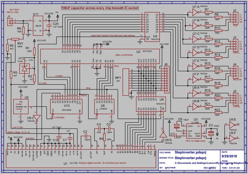

I have now built several quite different versions of these step inverters over the years, and each one has been simpler requiring fewer parts.
The current 5Kw inverter control board uses an Intersil twelve bit dual slope A/D converter to address the high order eight bits in rom. Low order ten bits of rom are continuously clocked from a 3.2768Mhz crystal oscillator module. The A/D converter starts a conversion every 40mS and its output is latched into the rom every second cycle right at the zero crossing.
The dual slope averaging is extremely accurate and consistent, and gives very good noise immunity to inverter ripple voltage on the incoming dc bus.
Rom output is latched when data is stable, and that is about it.
Each latched data bit drives an opto isolated gate driver direct through a 180 ohm resistor, and the opposite complimentary output comes straight off a 74HC04 inverter.
Four bridge inverters, sixteen opto isolator outputs from the driver board on four different plugs.
Plus five volts comes from one of those two dollar Chinese postage stamp sized switching power supplies, and minus five volts (for the A/D) from a voltage pump chip.
Battery voltage powers the board and also provides the measured input for the A/D converter. There is an absolute minimum of wiring and absolute simplicity.
There are ceramic bypass capacitors across every chip located directly under each chip, the sockets have enough height to allow that.
Its all very basic. no soft start, no over current protection, no dead time in the waveforms from the control board, no voltage feedback and no microprocessor.
And it works perfectly well direct from the solar panels without having anything in between except 36,000uF.
Voltage swings from solar are massive direct off the panels, as you might expect, but the output hardly varies at all, certainly not enough to worry about. In fact its BETTER than a PID feedback control, simply because its much faster reacting and completely stable.
Overload just trips the ac circuit breaker on the output. The whole thing has enough balls to do that very safely. I have been completely off grid now for six weeks without a single problem, and the inverter worked very first time it was powered up without a single problem.

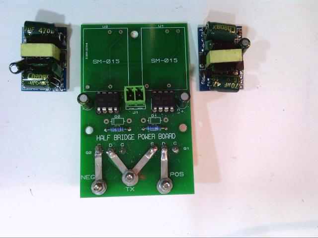

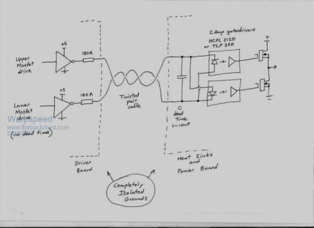

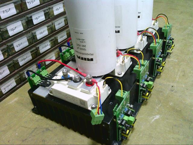

Each inverter consists of a pair of modular half bridge driver boards. These just plug into the control board via a single twisted pair. There are eight of these small half bridge boards. These also are as basic as can be, with just a 15v isolated gate supply and an opto isolated gate driver chip (with inbuilt 11v undervoltage cutout) for each upper and lower mosfet.
A small capacitor across the inverse connected opto isolators provides dead time. 1nF about 300nS for the mosfets, and 10nF about 2.5uS for the IGBTs.
The whole inverter has eight of these small half bridge driver boards.
And that is about it. The two smaller inverters just use individual mosfets fitted to screw terminal blocks and PCB tracks reinforced with solder lugs fitted both sides. The two larger inverters use 200 amp IGBT modules that plug into the same identical half bridge driver boards.

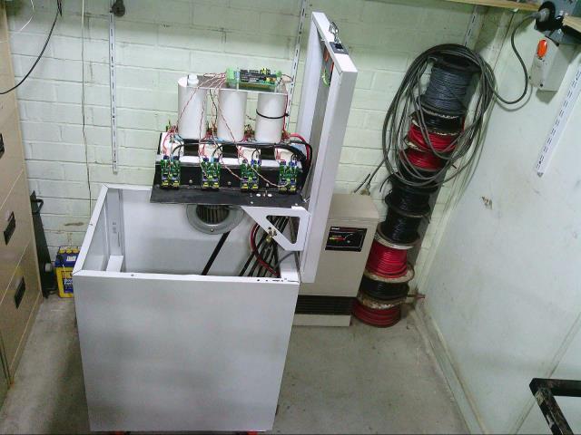

These particular IGBT modules are rated to carry 1,000 amps of fault current for one full 10mS half mains cycle, which is much more than is required to very quickly trip a normal C curve thermal/magnetic circuit breaker. That is something mosfets just cannot do as well as an IGBT.
It would be very easy to scale this up to 10Kw or 50Kw without any of the high frequency problems the PWM guys are plagued with. And its much more simple to build and get going.
Only really two obstacles to overcome, fabricating the four transformers is a bit of a pain, but its fairly straightforward, just work.
The other is getting suitable lookup tables organized.
I just wrote a program in assembler to burn a prom directly.
That is no more difficult or complex than stuffing a working microcontroller into the inverter.
But a bare rom has the advantage of not having any timing constraints.
A bare hardware rom is simple, and a lot more robust IMHO, than running a live software program in an inverter.
If it ever does spit the dummy, everything just unplugs or readily unscrews, and I have spare boards ready to go. Accessibility is particularly good too in this version, although its physically rather large. I should be able to fix a blow up very fast without requiring mains power or a soldering iron.
Nice explanation tony ,I wonder where the those 2 resisters connected to on the power board ?

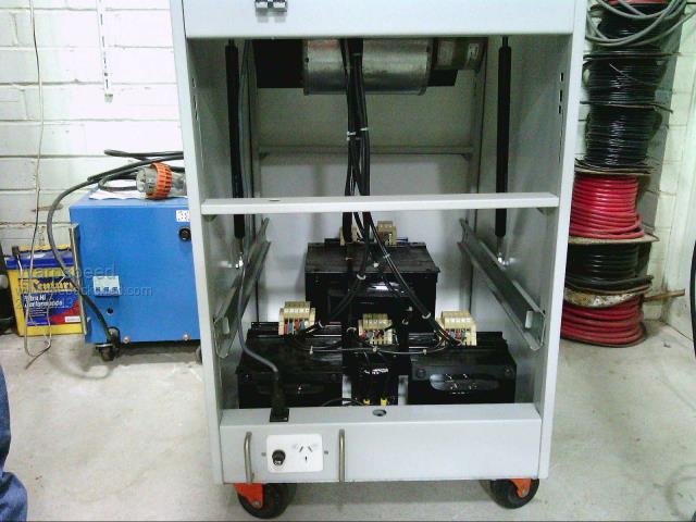

Posted: 05:59am 13 Mar 2019
Kanchana,
That last hand drawn sketch is how I finally did the half bridge gate drivers, I will post the final schematic for that tomorrow.
But first here is the full wiring diagram for the entire inverter.

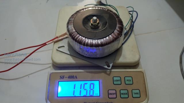

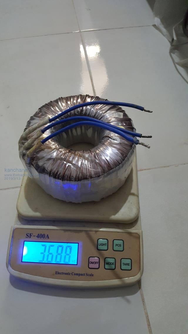

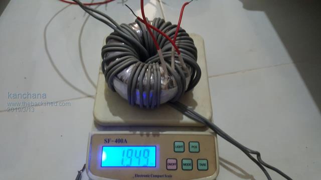

Thanks tony . Here is what I have got for the transformers . I have 1000va transformer currently attached to PWM type inverter . other 3 transformers got from china not sure how their true ratings .
This one got form a 230 to 115 v converter claimed to be 3000W
Second one form same source claimed to be 1000w. Those wires I tried used for house hold wiring here . Any way I can use those wires for transformer winding?
3rd one 230 v to dual 12v claim to be 100w

I haven't got a photo handy but my 3kW transformer is about 20kg and my 1kW transformer is about 11kg. I haven't done full on load testing yet.
Posted: 07:57am 13 Mar 2019
These are my four transformers. 4.5Kva, 1.5Kva 500Va and 167Va.
All have 20 amp secondaries.
Have the weights written down here somewhere, but will need to search to find the exact piece of paper.
