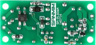

I went over to Poida's place today and he tested the little boards.
They start up around 35v with no load on them.
When you place a load on them they need much more to start up.
With 15mA load they start at 48V.
With 30mA they start at 50V.
So Tony when these get powered up is there any load on them?
Also these were claimed to be 450mA, but they only run stable at 200mA, is that enough?

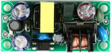

I want to show you all this isolated supply:
$2.20 US each, 5,9,12,15V versions etc.
What is special is it starts on 24V.
An NTC and a MOV on the input, and a common mode choke.
This is a nice supply
It took over a month to get to me.Edited by poida 2019-05-10
Posted: 12:05pm 09 May 2019
Did you try the startup under load?
Fit a resistor suitable for the output voltage (39 Ohm for a 15V module) to the output terminals and check if it still starts up at 24V. If so you got a winner.

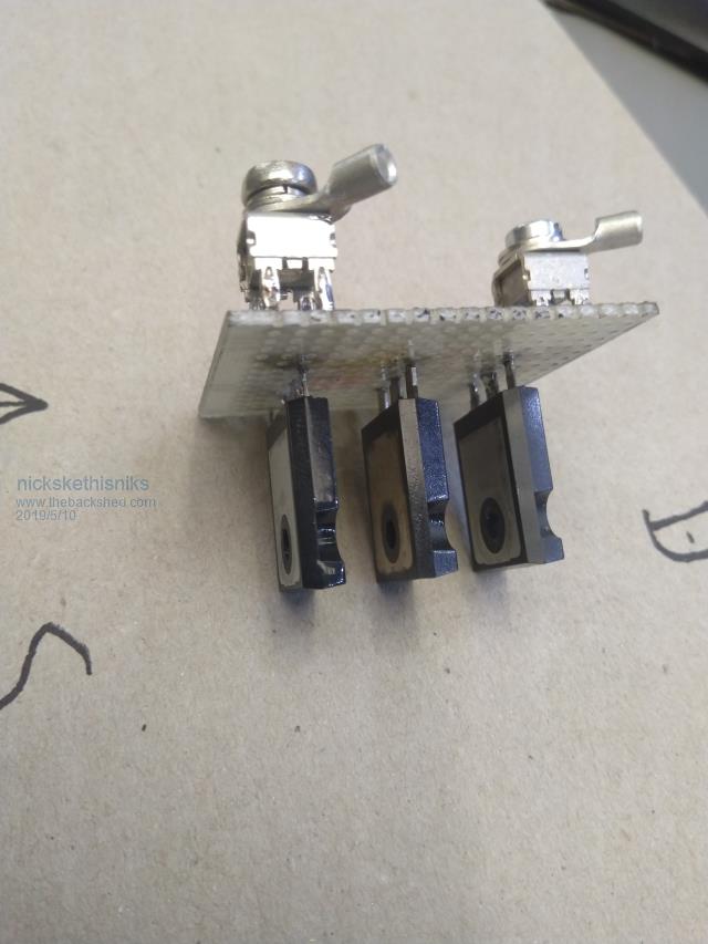

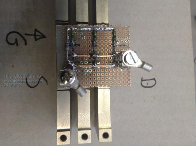

I think wiseguy posted a schematic somewhere in an other thread.
For us mosfet users it's maybe an idea to make a small pcb to connect mosfets to a busbar or cable with lugs, I made some "prototype" 3pcs mosfet "brick". I think the idea is expandable to more mosfets and half bridge design.
Because we are switching at 50 hz it would be no problem? We could easily add snubber and or add on mosfetdriverpcb if necessary.
Some thoughts?
We could then sandwich the mosfets between (in this case 8mm) aluminium bars. This bars could be connected to a heatsink with isolating pad. Or first to a smaller rectangular alu plate and then isolating pad, then main heatsink.
On the picture the aluminium bars are to long.
I can do more finetuning for better view, but I hope you get my idea.
Edited by nickskethisniks 2019-05-11

Posted: 08:18pm 11 May 2019
Some thoughts?
Now this is a truly brilliant idea.
My current Warpverter has never had a single blow up, but if it ever does go bang, I could slide a replacement IGBT power block under the aluminium busbars and replace its small driver board in probably about five minutes. None of the destruction can propagate back into the rest of the inverter.
Any destruction will be highly localised and quickly and easily replaced without any soldering required.
Mosfet high power modules are available, but are just totally impractical for cost reasons.
But this idea of home brewing our own low cost replaceable mosfet power module made from multiple HY4008s, with a built in optically isolated gate driver is a very promising concept.
It raises the screw terminal block idea up to the next level. Circuit boards are now so cheap to get made, a badly burned and smoke damaged home brew module could be a throw away item just not worth repairing.

  Tinker said   Did you try the startup under load?
This is a 12V module. I placed a 5W 47R across the output.
It starts with 24V DC, but it can not produce 12V on output, only 8.3V
with the 47R load.
1.5W maybe.
12V output arrives once input is about 36V.
In a few minutes, the combined SMPS IC/MOS switch warms up enough
to reduce power a little, and so it needs about 39V to make the 12V output.
I will get a few of these for my isolated PS needs. I like the 24V startup.
I thought some here might like the look of them, they seem better quality
than the ones Mark has bought (which will do the job fine anyway).
