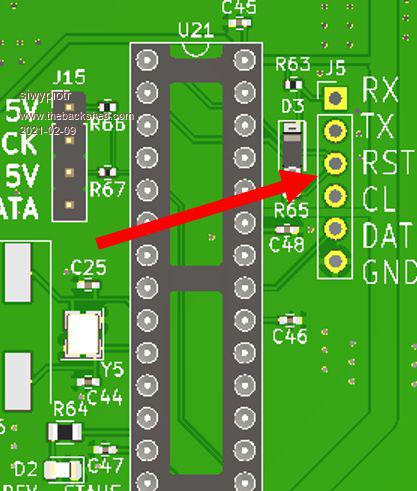

First of all You have to solder the pin header here:
If You have USB to UART converted You can use it and connect RX to TX and TX to RX and flash using ds30 loader.

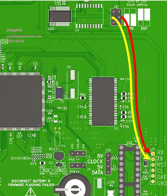

If You do not have USB to UART I can tell You that You have it, there is one in Maximite Deluxe.
Connect jumpers as shown below:

Hi Piotr,
My unit arrived today. All good thank you. It looks like I have to update the firmware for the mouse chip. Hobbytronics site is down at the moment so I can't download the firmware and loader or the instructions.
I will have to fit the header (J5) first I guess, then use the USB to TTL rs232 on board as you suggested using a pair of female to female jumper leads. Correct?

Hi
Yes You need to add J5, remove all jumpers from j17 and connect jumper wires as shown in this post. You also have to start the bootloader, since You will be using the onboard FT232, switching power on will not do it (it will restart com port as well)
After You press "Write" in ds30 Loader software You will have to momentary apply GND to RST pin on J5. this will restart HT chip and start bootloader.
