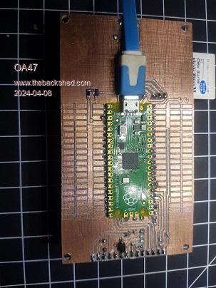

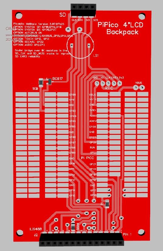

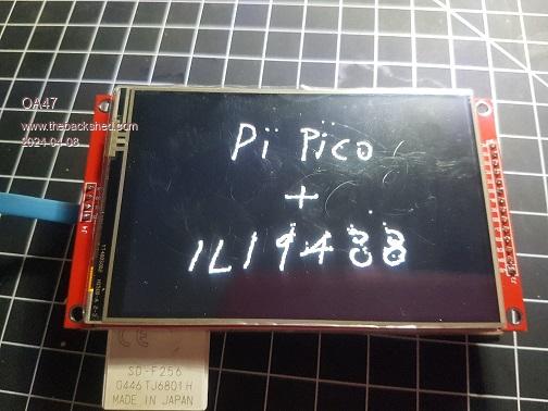

OA47
Joined: 11/04/2012
Posts: 1056
Posted: 07:51am 08 Apr 2024
Not sure if any shedders may have a use for it but here's a ILI9488 4inch experimenters backpack. It has screen, touch, sound, RTC and SD access.
I used Capton tape on the back of the pico and soldered it directly to the board but you could drill to mount it on pins.
I can upload the gerbers if anyone is interested.
0A47
Edited 2024-04-09 07:20 by OA47

@0A47
Like the look of your experimenters backpack. Would it be possible to place holes in all the pads so that pins/sockets could be used as well for all connections. also if you added another set of holes that matched the sd card connectors on a 3.5" both displays could be accommodated.
Tony
OA47
Joined: 11/04/2012
Posts: 1056
Posted: 08:39am 09 Apr 2024
  Quote  Like the look of your experimenters backpack. Would it be possible to place holes in all the pads so that pins/sockets could be used as well for all connections. also if you added another set of holes that matched the sd card connectors on a 3.5" both displays could be accommodated.
Good thoughts Tony, I could add those holes if I were to get the boards made but as shown I was minimalizing any errors I could produce on the prototype boards I have milled, drilled and cutout on the CNC.
BTW Do you have a measurement for the spacing between the pins for the 3.5 inch version ?
0A47

OA47
Joined: 11/04/2012
Posts: 1056
Posted: 11:24am 09 Apr 2024
  Quote  here's a ILI9488 4inch experimenters backpack. It has screen, touch, sound, RTC and SD access.
If the link from BL to 3V3 is re-directed to the hole on GP17 and the OPTION LCDPANEL changed the Backlight 0-100% works a treat.
0A47
