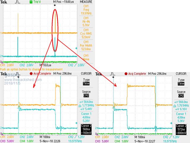

The 20kHz at "stop" is intentional. If you check both output's duty cycle, you will see they are the same, at about 50%, constant no matter where you look.
Poida, I'm not sure if I see what you describe - the 50% duty in stop mode. I see the following constantly varying length pulses 100-500ns.
I did not check the other code samples you've provided, only the last one.

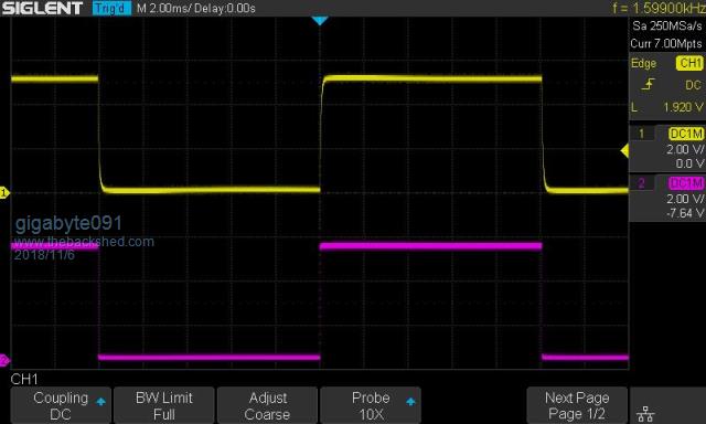

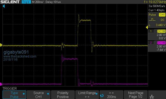

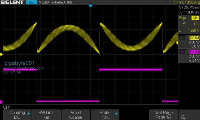

So here are some waveforms when the ardruino is loaded with first program:
When program is not running (top waveform is filtered through 4k7 and 10n RC network)
And there is picture when is running:

@gaspo here i tried to reproduce your waveforms and with edge triggering i didnt manage to get stable waveform, duty cycle was all over the place, and then i use pulse triggering and manage to get stable waveform
I left my trigger menu opened so you can see what settings i used

Gaspo:
I'm not sure how you are getting these signals.
Just to make sure we are both on the same page we need to be both using the
same type of Arduino and looking at the same pin's outputs.
I am using the 2x sine code, loaded into an Arduino Uno.
The code requires two timers to be present, and we use the output compare
function to drive pins 9 and 10 from TIMER1.
We need access to OC1A and OC1B for this function.
If you are using an Arduino that has a different chip than an ATMEGA 328p
then we probably will see different results.
All the codes posted by me require an ATMEG 328p uC and it's simple and cheap to get them from ebay at $10 each when you buy a "UNO board".
I see from a prior post that you are using a "pro-mini"
This uses the ATMega 328.
here is the pinout:
I see pins 9 and 10 are connected to OC1A and OC1B.
This is good.
Make sure you feed it 5V so it runs at 16Mhz just like a Uno.
The video I posted for Tinker shows outputs on 3 pins.
Pins 9 and 10 are Yellow and light Blue. (OC1A and OC1B)
The Purple trace is pin 7.
This pulse is the result of the following:
if(pcount >= NPWM)
pcount = 0;
sbi(PORTD,7); // give a sync pulse for DSO, alligned with start of 50Hz
cbi(PORTD,7);
Edited by poida 2018-11-07

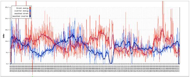

Part 25: How I log, process and view the data from my solar power system
I have enjoyed home brew solar power since about 2015 or earlier. I can’t recall when I first set it up
since it’s come to the stage where “we’ve always had it working here”
Along the way I have further developed my programming skills and added new languages to my skill set.
This system uses html, php, javascript and C.
Anyway, some basic facts:
48V battery, 400Ah.
one 3kW array, of 250W panels. Wried in 4 parallel x 3 in series, facing North.
another array, 3kW of 250W panels, 6 parallel x 2 in series, facing East.
An MPPT controller, taking the North facing array. This gets up to 100V input, DC-Dc converting to
suit the 48V battery.
A PWM controller, taking the East facing array, This gets up to 60V and 20A and is nowhere the 3kW
rated.
A Raspberry Pi computer, running things. Powered by a DC-DC converter connected to 48V battery.
An Arduino Nano, connected to the Pi, powered by the Pi.
A change over relay (Latronics ACTS40) which powers part of the house, using either inverter supplied AC or street power. This changes over automatically depending on the availability of inverter power. 1/2 of the house is connected to this circuit via an RCB, and it's properly earthed, wired with 1.5mm2 3 core under the house, leading to numerous GPOs.
Thermistor temperature sensors, attached to battery terminals.
A DC current sensor, +/- 60A or more range.
The mppt controller is a Morningstar 60A ppt. It comes with internet connectivity.
I request the device’s operating parameters every 2 minutes.
From an http request such as
“http://172.16.0.54/MBCSV.cgi?ID=1&F=4&AHI=0&ALO=27&RHI=0&RLO=36”
I obtain the battery voltage, charging target voltage, charge current, array current, array voltage
heat sink temp, battery temp, charge state, ppt sweep max power, sweep open voltage and more
from the device.
The PWM controller is a Morningstar 60A Tristar. No internet connection alas.
But it has a serial port. Via a RS-232 to usb cable, into the Raspberry Pi I can send and receive
Modus data. And so I obtain the Tristar’s battery temp, voltage, charge current, heat sink temp.

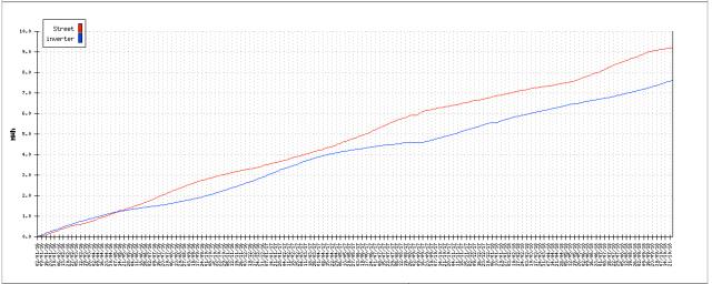

The Arduino nano is used to obtain the current draw by the inverter, and convert to an integer.
It also counts pulses obtained from the infrared sensor located on top of the 1 watt.hour pulse LED
of the house’s smart meter. This gives me street energy consumption.
So the Raspberry Pi knows all, every 2 minutes.

I can extract records from this table satisfying various criteria.
e.g. to get all the records, sorted by time for the day 2 Nov 2018 the query would be
“select * from data where ddate = 20181103000000 order by id”

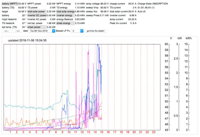

Right now we can see how today’s situation is going. It’s rather cloudy so things are very up and down.
I welcome all to have a play with this.
http://poidapie.chickenkiller.com/mppt/c19d.php

The Raspberry Pi has a web server running, and this serves up requested pages.
I have progressively developed the web page that generates the above image over the past few years, on and off.
Programming the Arduino nano is done via the Linux console on the Raspberry Pi
using Platformio. I can reprogram the nano remotely from work if I like.
It's all very flexible with remote administration.
We only have ADSL here at home and that places limits on how fast I send data out of the house.
This has been a welcome challenge for my programming, to drive efficient coding that works over slow connections.
I do IT for a living so network setup is easy. I have the Raspberry Pi web server available to the internet, contactable by anyone, anywhere.
Should the advertising of my webserver become a problem I can easily limit access
to certain locations such as my workplace and home. Control of this is absolutely no problem at all.

To get energy, you total up the power times 2/60 (giving watt.hours) over the required time interval when samples occur every 2 minutes.
Here is the energy consumption of the house from 2016 to date:
Some energy comes from the street, some from the inverter.
And the daily energy consumption:
There were 4 weeks when I did not have a working inverter.
Talk about anxiety or what...

  poida said   Gaspo:
Poida, yes the pro-mini is using the same 328P chip as Uno. I have Uno as well and the code behaves the same.
By looking at the code in uno_inverter_2x_sinewave_pwm.ino it seems that what I observe on pins 9/10 in stop mode is correct.
When you stop inverter it decrements sst to zero while gradually reducing the pwr factor to a minimum value of 0.01. When sst == 0 the code clears pin PD5 (driving /SD on IR2184 low?).
The TIMER1_OVF ISR keeps running trying to produce SPWM duty using the minimum power 0.01 (vpwr). Because calculated duty written to OCR1A/B is not zero I see very narrow 100-600ns pulses.
But that does not matter if the IR2184 is disabled when stopped.
I like your inverter code, how simple and stable it is while utilising the PID and the LP filter on analog pins.

I also can confirm the presence of pwm pulses in stop mode. I have seen this before in my other projects using atmega pwm. Even though the compare value is zero, there will be one timer clock pulse at the compare output pin(s) every overflow. What I did is disconnect the compare output from the port pins. So in the code, this change worked for me:
cbi(PORTD,5);
cbi(DDRB,1); cbi(DDRB,2); // change direction to input, disconnect output compare(s)
else
{sbi(PORTD,5);
sbi(DDRB,1); sbi(DDRB,2);} // restore direction to output
The change is not needed since the SD of the IR2184 is already being used.Edited by tinyt 2018-11-08

Gaspo:
I have been running a different code than you! That is why you see something I do not.
Sorry to waste your time.
I am running the vf_output_freq code right now. This has the 50% duty cycle when stopped. That is what I used in the video
https://youtu.be/L6i5yOFxR2k
when illustrating how these programs work.
The 2x sinewave pwm code you are running is different to the above...
I just loaded the 2x sinewave pwm code and it does exactly what you have shown.
These narrow pulses are no problem due to approximately 500ns dead time from the gate drvie ICs. The MOSFET gates see little or no drive with these narrow pulses.
I like Tinyt's fix.
I'm not sure it's required but it seems to be a safe way to clean up the drive narrow pulse signalling.

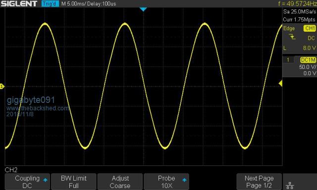

Posted: 06:23pm 07 Nov 2018
So today i bought drivers and i have inverter up and running :)
here are some images of driver board
Setup, it's a real mess but hey, it prototype
And waveform, i know it isnt 230V, but im running it at reduced voltage becouse i dont have any capacitors on input and my psu is not happy about that hahaha
At the moment im using 330nF capacitor at transformer output, this is what i had at hand, with 5 uF there was huge backfeed into PSU, and voltmeter go over 60V and shut down everything. So now i have to tune capacitor and maybe choke... The important part is that it is working :) Program im using is 2×sinewave.
Tried softstart and its working perfect, also i tried to reset MCU while inverter is running to se is there any errors but everything is alright

  gigabyte091 said   So today i bought drivers and i have inverter up and running :)
Good work. In the photo I see you might be using a EI type transformer.
It's quite a clean sinewave.Edited by poida 2018-11-09
