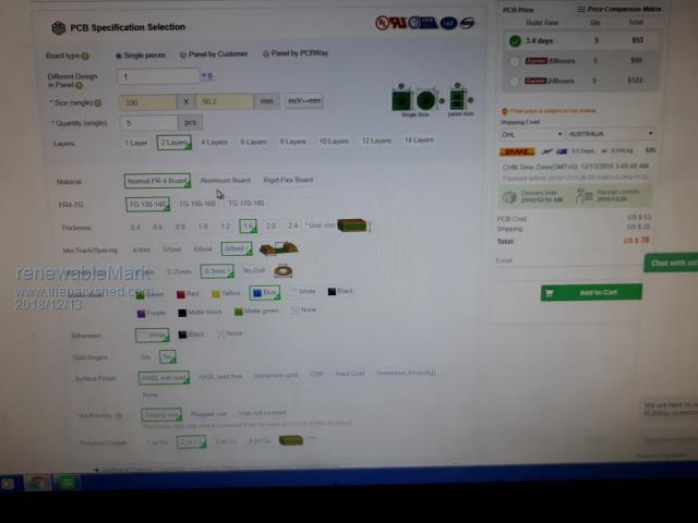

renewableMark
Joined: 09/12/2017
Posts: 1679
Posted: 08:02pm 12 Dec 2018
No more additions/alters?
I see in the notes holes are plated through, but I can't see an option on the order form.
Can someone check this over for me please?

tinyt
Joined: 12/11/2017
Posts: 564
Posted: 08:40pm 12 Dec 2018
  renewableMark said   No more additions/alters?
Non-plated thru holes require additional procedure and maybe cost a little bit more. Most PCB fab houses assume that holes are plated thru and you have to specify or have another drill file for non-plated thru holes. What I did is just clarified in the note the hole type.

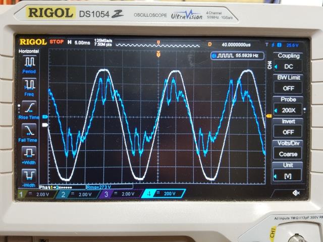

Part 25: generator waveforms (from the cheap Chinese 2 stroke genny)
I found this on the side of the road and thought it a good teardown candidate.
(but mine is very rusty, corroded and filthy, not like the photo)
But it ran, sort of OK, and made power.
It has a rather bad AC waveform and seems setup for 60Hz.
Oh well.
White is my street power waveform.
Blue is the generator's waveform (60 Hz approx.)
I do not want to have to make the nanoverter sync to this rubbish.
Surely more reasonably priced and specified generators produce a decent output waveform.

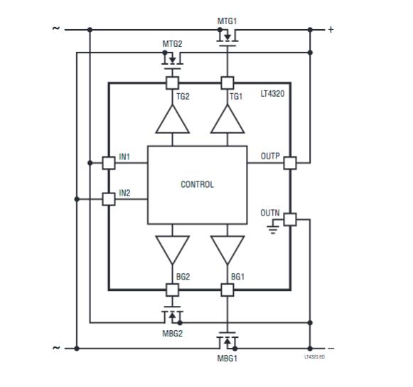

It got me thinking if we really need AC sync at all.
In some cases where you just want extra power you could have the generator output
rectified and fed into the battery. No AC sync is needed now.
We already have a very efficient mains AC to DC conversion system available
in the form of a large toroid, wired for 240V AC to 60V AC output.
Rectification of high currents can be done with a MOSFET active full bridge rectifier, or other options.
Maybe use the LT4320 ideal diode bridge controller. Have that drive some HY4008 MOSFETS and feed that into a charge controller of some sort. Or just stop the generator when it's enough.

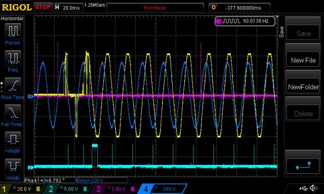

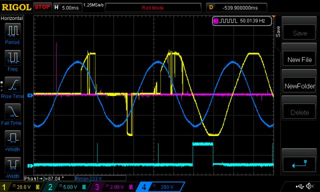

Posted: 11:44am 06 Jan 2019
Here is the sync performance during connection of AC sync source.
I have a deliberately poor connection, to try and force some bad behaviour
of the code.
Yellow is AC source
Blue is inverter AC output
Light Blue is short 7.5us pulse from sync interrupt code execution.
Each pulse indicates the sync code has run, trying to find sync with external signal.
Once the signal is applied, it takes some time to get synchronised.
Pink is 50Hz beat from inverter, used for DSO trigger sync, forget about this one.
First we see a close-up of a poor application of external sync.
Notice how much on and off sync input signal there is due to me pushing
a wire into a breadboard terminal.
The external AC is about 90 degrees later than the inverter.
Next is a view of sync capture, taking about 10 50Hz cycles or 0.2 of a second,
to achieve sync.
The wide pulse is due to the sync interrupt being triggered at the wrong time and so my code just exits early, leaving the output high until the next time.
This is by design. I only want the sync code to run once each 50 Hz cycle.
My street power has the top and bottom clipped a bit, for some reason.
I don't know why and I think I just need to accept that an external AC sync source will have unexpected shapes.
