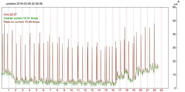

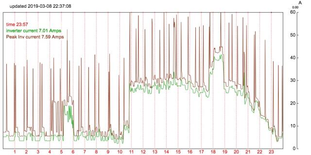

Part 27: Why we make them big and beefy. (Inverters, that is)
In earlier post here, I showed that my house needs a relatively low power supply
for most of the day. I chose to supply this low level with the solar power system and let the high power loads be supplied by the street supply.
This has enabled me to supply about 50% of the house power from the solar array over the entire year. This is Melbourne. Cloudy, overcast Melbourne.
I see we only need about 5 to 10A at 50V for most of the time, then we only need an inverter that can handle 500W. Right?
I have 2 fridges on the solar supplied circuit. When a fridge switches on due to it's thermostat, there are large current peaks.
How large?
This is the recorded data from my system.
Green line is the smoothed or average current drawn by the inverter.
Brown is the peak current seen at any time.
We can see my house needs less than 10A most of the time, but very often, the inverter has to handle 50 A peaks when a fridge turns on.
That is why we build inverter boards that can deal with 2 or 3kVA or more when running modest loads.
First, today where quite modest power levels were provided by the inverter.
And last weekend, when I ran the pool pump. On top of this load, we can
see the fridges peaks when they switched on.
Over building the inverter is a good idea. The PWM based systems can run at quite high efficiencies under low loads. In my case the 250W to about 500W is at about 93% efficiency. This means at worst I waste 7% of 500W or 35W in heat. No fans need to come on to cool things.
The reason the brown and green curves don't align at low power levels is that
the current sensor has a lot of noise. The green curve is time averaged current, suppressing the noise effectively, the brown curve is recording the peak value seen at about a 1000Hz sample rate.

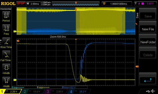

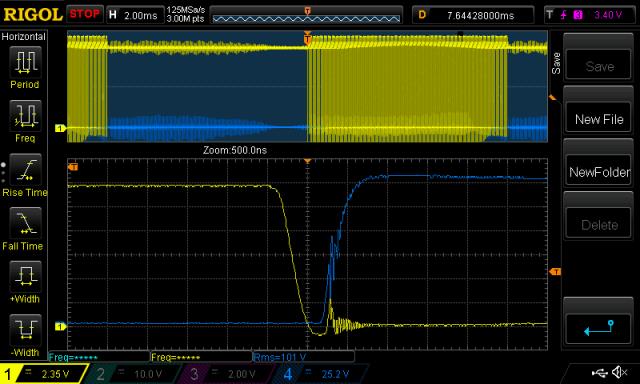

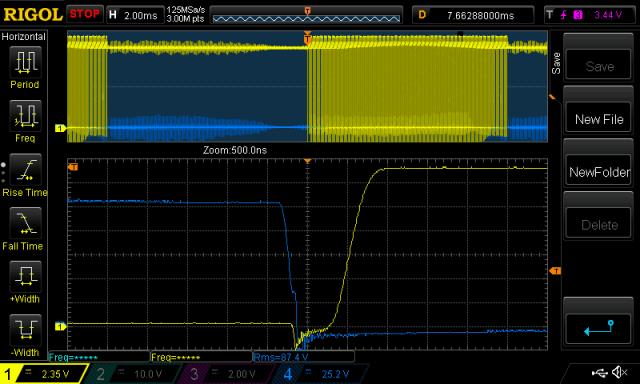

Part 28: Gate drive on Madness's power board. This uses on board transistor totem pole drive
After building one of Madness's boards, I wanted to see the high and low side gate drive, focusing in particular on any signs of shoot through.
Here are the results.
Oscilloscope probe technique is important and I examine this later in the post.
I look at gate drive voltages at 2 portions of the AC output sinewave just as I did
in post #26
Looking at some location quite early in the 1/2 sine wave, we see
high side switch ON and high side switch OFF.
There seems to be a small degree of shoot through, the HY4008 specs say
Vgs(th) can be as low as 2V and up to 4V. We see peaks well past 2V, into maybe 2.4V.
I call this as getting to conduction on the low side MOSFETs during a high side switch ON event.
This is far less severe than what I show in post #26.
Yellow is LOW side gate drive
Blue is HIGH side gate drive.
I forgot to reset the probe gain in some of these. It is either 20x or 200x.
and

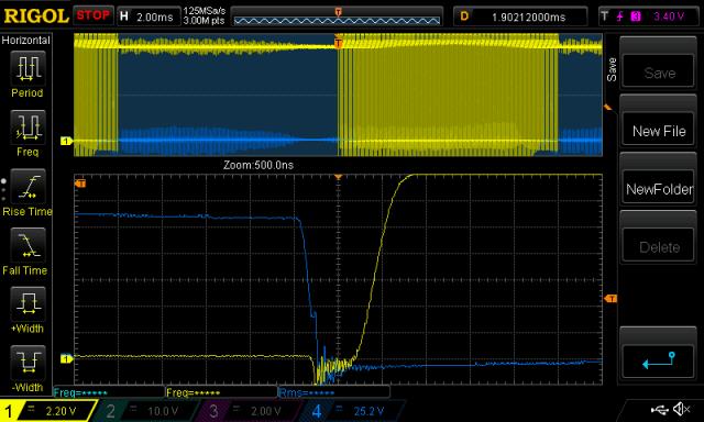

These following 2 are late in the same 1/2 sine wave of the AC output.
Less issues to my eyes and again we can see a clear effect of dv/dt on the low side gate. It can be drive negative just as easily as it can be driven positive.
and

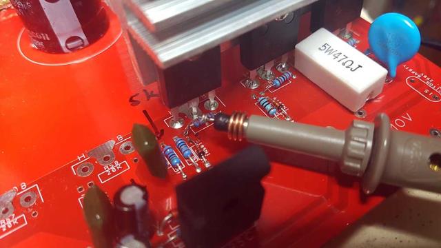

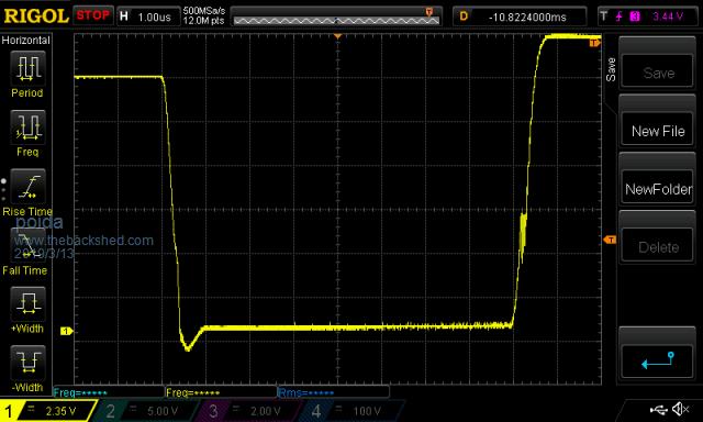

Some of the high frequency oscillations we can see everywhere are real.
And some are due to the probe technique I used.
I use the short 5 inch long alligator clip earth leads nearly every time.
I used them in the above DSO traces.
These short earth leads are an inductor and they create high frequency oscillation
due to the approx 15-20pF capacitance of the probe and other parasitics combining
to make an LC tank.
Better probe tech. is to not use the earth lead.
See how I do it. (only good for LOW side gate probing)
I solder two small wires on both ends of the 20K gate to Source pull down resistor.
I then poke the probe in these two springs.
This is a very good way to minimise to a large degree the effect of the 5" earth leads.

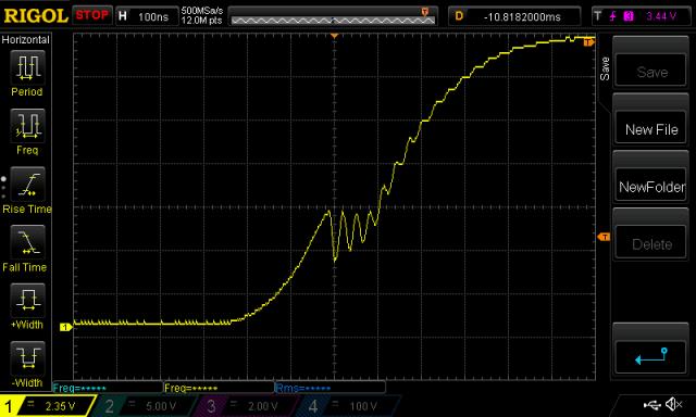

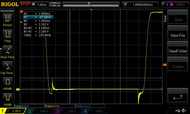

Let's look at a LOW side switch off and on event with this probe tech.
First that near the start of the 1/2 sine wave
and that near the end of the 1/2 sine wave

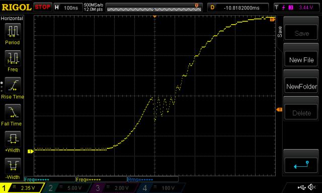

Zooming in to the right hand side rise event we see some oscillation, at about 6MHz
I feel this could be improved, no idea how.
The value in reducing this is the MOSFET's could spend less time in the switching stage and more time either fully on or fully off. This will reduce heat, stress, increase inverter life and improve overall efficiency
In case you think this is some poor DSO interpolation artifact, here are the data points at each sample time. 500MHz sample rate.
Yeah, yeah, probe compensation. I could/should do that and calibrate things and
rent special test gear and, and...

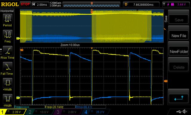

I need to show you other comparisons of with and without the little earth lead. Most striking is to do this on a digital output pin on an Arduino or Raspberry Pi or STM32 or something. It's night and day.
Finally, a capture showing the gate voltage behaviour during a few PWM cycles.
We can see the peak gate voltage sag a little but this can't be any problem.
It is hardly surprising Madness's power boards work so well. They reduce, by quite a lot, the shoot through I see in power boards using IR2110 gate drive ICs directly to power MOSFET gates (e.g. Alliexpress inverter boards, Ozinverter designs, etc.)
Wiseguy has some alternate power board designs in progress and I look forward to seeing how his go. They use closely located drive ICs and opto couplers. Maybe these will reduce even more the dv/dt effects?
I may be repeating myself here but I must say:
This is fun.

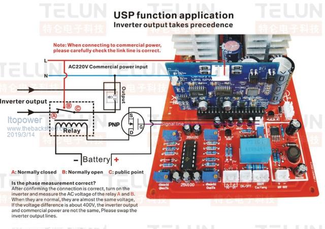

Posted: 06:14pm 13 Mar 2019
Poida, brilliant work with the scope. It's amazing to see the waveforms with 500MHz sample rate as they really do show up everything that is otherwise missed qyuite easily. I'm still scratching my head reading through some of it.. brilliant stuff.
I read a while back in various posts about a UPS style version board and found it on Aliexpress, wondering if two units given a common stabilised input frequency if they would syncronise enough together to allow the two transformer outputs to be coupled. Small variations in the frequency lock may well create some degree of oscillation ?
This would then allow an incremental build out of a larger inverter capacity.. this would also avoid them from actually being used as a UPS just a syncronised group of boards..

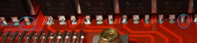

This is my inverter board that turned up today.... in need of some more solder on some of the drain and source legs.....
The effect of this small difference to FET leg position and heating effect would be quite interesting to know, although not entirely sure how this could be measured effectively. Maybe a comparison between two FET's as I noticed your picture with the scope leads the drain and source are in a similar low solder situation ?

Just noticed that image is with the gate lacking in solder, there are other FET's on the board with the source leg in the same situation and wondering abut the heating impact of that very short narrowing of the leg.

  ltopower said   Ah, picture did not come out as planned...
Ideally the middle leg (drain) would not carry any current, it instead flows via the heat sink to the back plane of the HY4008 - this connects to the drain. That is one reason for using life heat sinks and *no* heat sink compound at the mosfets.
The source leg needs to carry the full current and I see in the pic a build up of solder for that, not sure if the PCB tracks are adequate.

Posted: 05:59pm 15 Mar 2019
Appologies, that picture was not the best example... showed the extreme potential from a lack of solder.
This is the other side of the board.
My thought is that this would be one source of additional heat generation.. I'm presuming it is the wider section of the legs that are part of the package constraint on the amps rating ?
Posted: 10:30pm 15 Mar 2019
Don't forget that these boards were probably soldered by some untrained minimum wage staff that have to complete several hundred boards a day.
