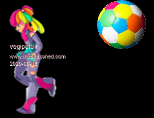

vegipete
Joined: 29/01/2013
Posts: 1193
Posted: 01:09am 18 Jun 2020
Welcome to a fellow Canadian, eh?
I can see by your description that a sprite system that automatically stepped through a sequence of images would sure make life easy.
Failing that, perhaps you could draw simple unchanging sprites on an unused page in order to get the benefit of collision detection etc and at the same time blit animated images to the buffer that will be displayed.
---- time passes ----
I just had a play and created the attached that (rather crudely) implements the above. I grabbed a set of images from the web and hacked together a test program. The animation is a sequence of 16 images but I use only one as a sprite. A piece of the image also provides a bouncing ball.
This demo shows also that I have more to learn about transparency.
SpriteTest.zip

vegipete
Joined: 29/01/2013
Posts: 1193
Posted: 02:23am 18 Jun 2020
West coast here, so pretty far away!
This was my first try with collision detection. Seems to be bounding box based. Plus I notice occasional pixel artefacts when a major collision occurs. And when transparency gets thrown into the mix, all manner of fun can ensue.
Twill's idea ought to work well too. 'Sprite read' can replace an existing sprite with a new one if the size matches exactly.
Maybe I'll rewrite my demo to try that method too.

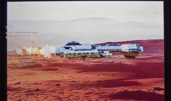

Update on Vertical Stitch:  I've worked on a subroutine where you load the graphics into empty video pages, and it just BLITS between them with two BLIT commands.
12-bit : Meanwhile, for things like car windows or glass panels, I'm looking at layered sprites.  Are the vectors (like box command) able to have semi-transparency too?
16 bit mode works great!  I can't believe how big you can make the sprites and still have things scroll well.  Would be amazing if there was a bit more movement on the off-screen sprites before an error came up.  If you have sprites with slightly varying widths it'd be nice to not have to cater for each one being out of range at different values.
